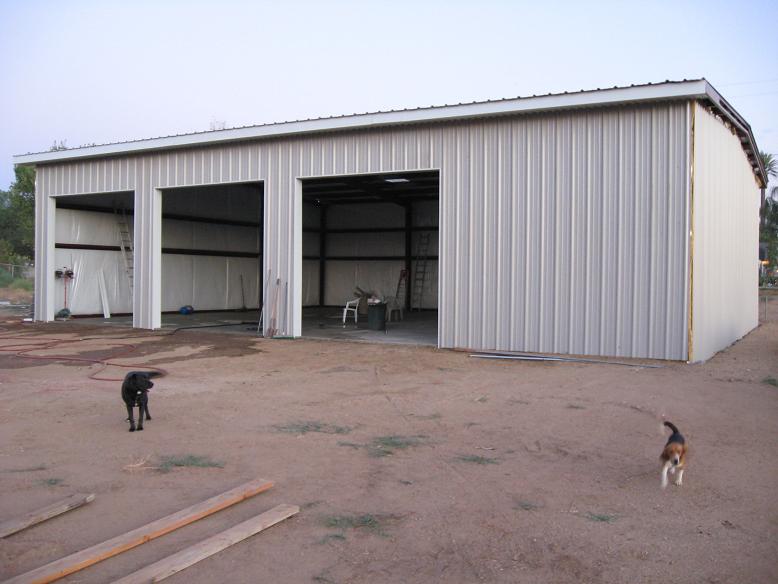

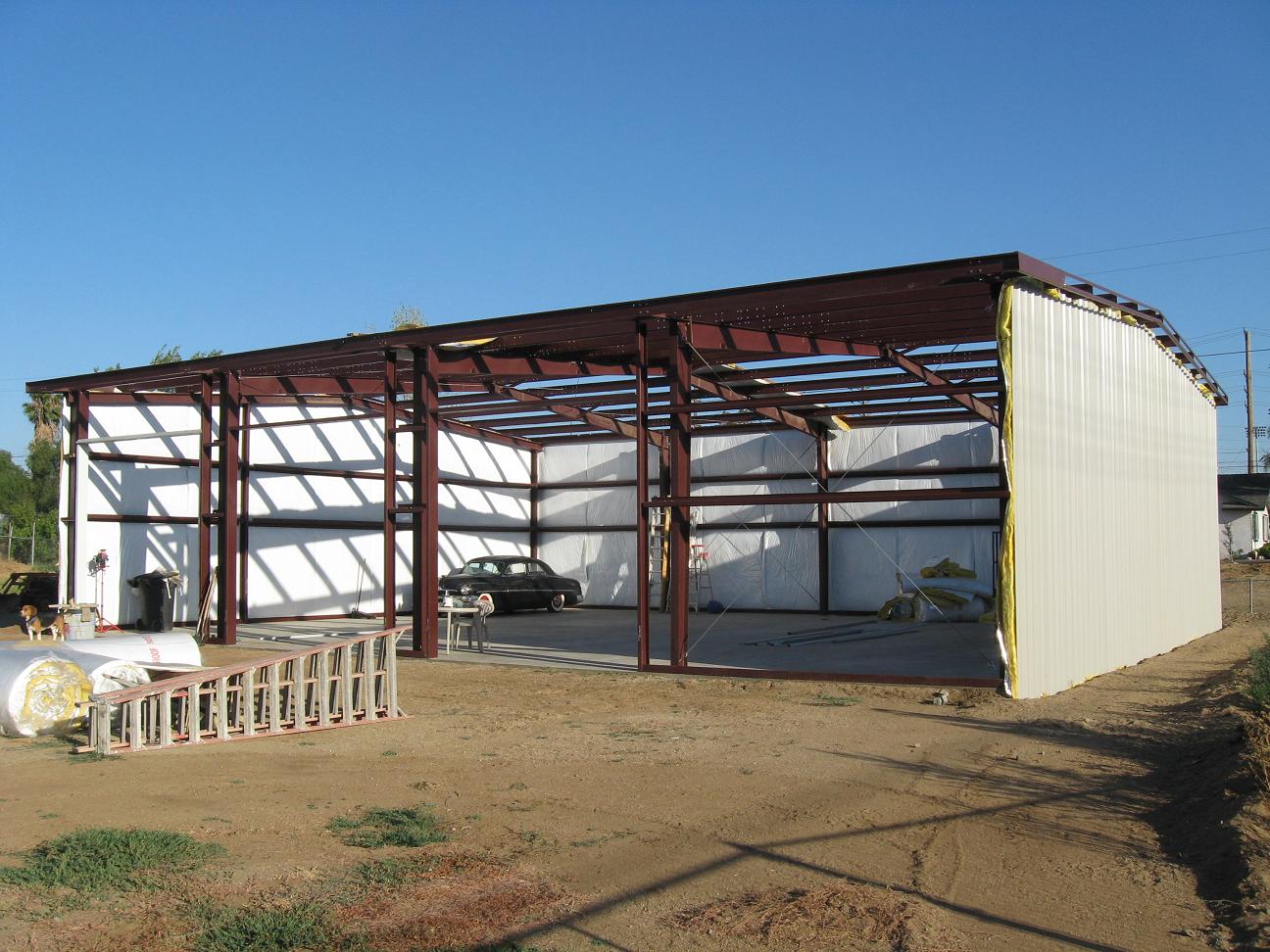

    I just finished my building about a year ago. 40x40 with 16' side walls. Purchased the building from Empire steel buildings, and have been very happy with them. Got it with full insulation, full interior wall panels, 1 10'x10' roll up door, 1 14'x16' roll up (both insulated), 1 walk in door, 1 3x3 window, 1 3x3 wall vent, and 1 10' roof ridge vent. Total for the building was about $23k
    I paid to have the dirt and concrete work done by a friend, which ended up being about $16k total, about $12k in materials. My slab is 6" thick with HUGE footings and a ton of steel, so I'm sure some would come out cheaper, but I wanted to be able to work on anything.
    I also paid the same friend to help me assemble the building. It took us some time, but definitely less than it would have taken us to build anything else this size. Almost everything was done by just the 2 of us.
    Total cost with everything was around 50-55k I think.
