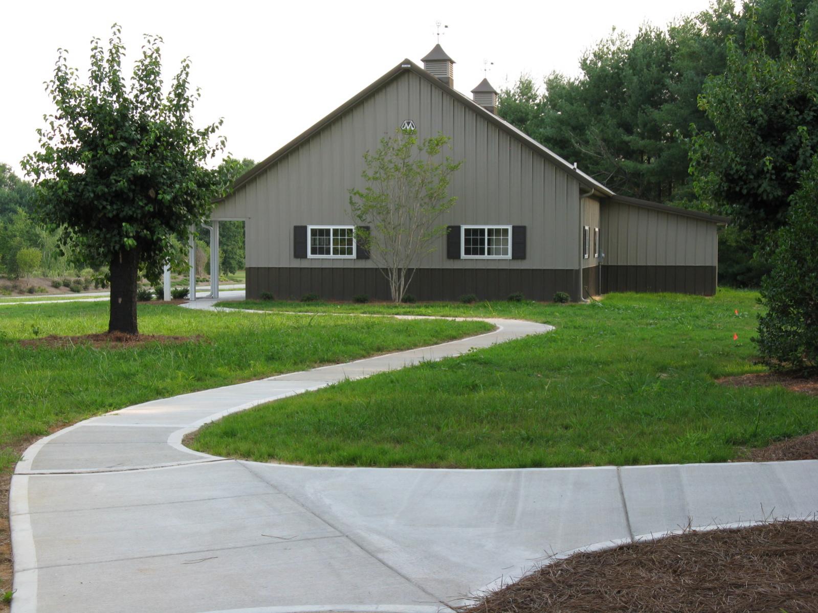

    I had this built by Blitz Builders 4 years ago:
    It's a custom-design 50'x56' with 12' side walls. It's split 1/3 workshop, 2/3 storage and has 4 overhead doors so you can drive through either side. (This is my second time around at building a garage/shop and I learned the hard way on the first one... the drive-through feature was my first requirement!)
    The crew Blitz sent to build it had it finished (less doors) in 3 days! The way they construct their pole buildings is that the site has to be graveled. They build the garage and then you pour the concrete into the floor area, which effectively surrounds the 'poles' in concrete.
    I went with Blitz because a friend has one that suffered storm damage and Blitz was super helpful in getting the components to him to make the repair in a matter of days. They also hooked him up with a contractor who made the repairs quickly and did excellent work. It paid off for me because I had a leakage problem with the roof after 2 years. They sent a tech to my site for 2 days, fixed the problem and didn't charge me one cent!!!
    The 'kit' was $33k including the price of erecting it. Excluding the cost of the land, I have about $60k in it so far, which includes the prep, building, electric service and concrete (including a huge driveway, which you can't see in the photo because you're looking at the back of the garage) and I figure I have about $15k to go before I'm finished. (I'm slowly doing the wiring, heat/AC and insulation myself).
