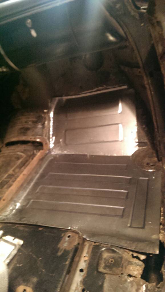

    I was inspired by some of the builds on the H.A.M.B. to save an old car. They do some top notch work too. I wanted to do it with only basic tools also, and I can say that it can be done, I built my own floor pans out of scrap metal bent on a sawhorse workbench. Which ever way you decide to go good luck with your project. IMG_0523.jpg IMG_0451.JPG
    willys36 and DrDragon like this.

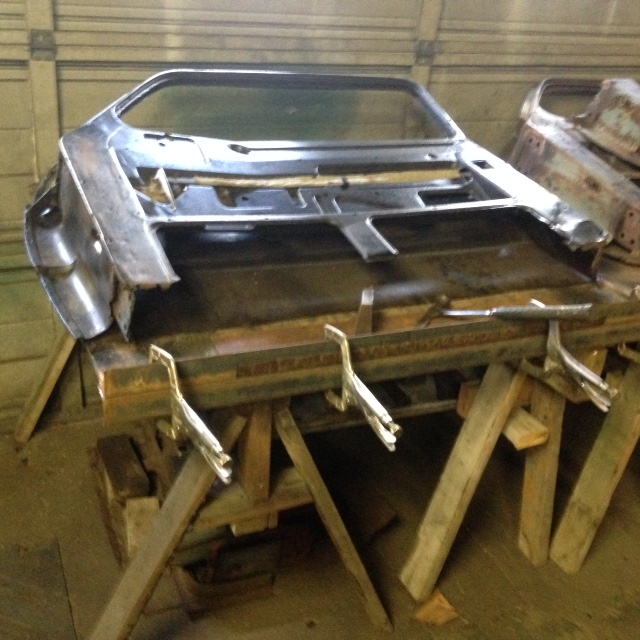

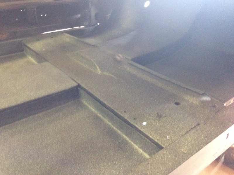

    The floors in my 50 Chevy are a mess, meaning the floors, inner and outer rockers and braces are gone. I'm tackling it myself with a manual Eastwood bead roller and a Lincoln mig from Home Depot. I figured I could get a 4x8 sheet of 18 gauge steel for $55, and could make everything I needed from two sheets. It's coming along well. Even if I make a handful of mistakes, I'm still not out that much, but have learned more than if I hadn't done it.
    These aren't welded in yet in this pic, but I spent an afternoon making these two pieces.
    Kustomline54, rjones35 and triman62 like this.
