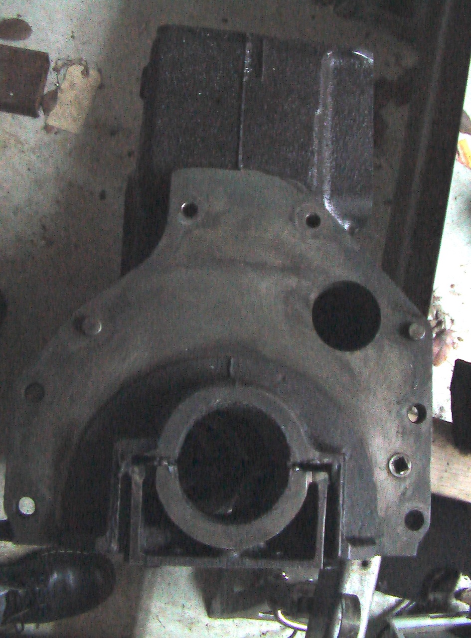

    The freeze plug on that block is on the back of the cam shaft and covered by the bellhousing. So when looking at the engine it's on the p***enger side just below the cover that covers the push-rods.
    An expansion plug won't work.. there is only about 3/8" space behind the freeze plug and then you have a turning cam shaft.
    Pulling the trans and rear end is NOT easy on one of those, did one a few weeks ago and they are made to stay in the car.. The 3 crossmembers are all in the way, some thin paper gaskets between everything.. messy to say the least.
    Drilling a hole in the firewall won't work, unless you are planning to also drill a hole in the bellhousing/clutch/pressure plate or torque converter.
    Pulling the engine is a lot of work on one of those, because the engine is so long and heavy you pretty much need an a-frame, cherry picker won't handle it too well. And it's hard to do with the hood on.
    So I guess what I'm saying, no matter what you decide to do, it's going to be hard. My advise (and yes I've done this before) is to pull the engine.
    Expect this to be an expensive repair. I would not sign up to do this job for any of the estimates I've seen here (except for free to help a buddy out)
    I've attached a picture of a bare block so you can see where the freeze plug is. Mine is still out (it was leaking ;-)
