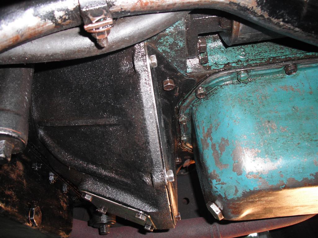

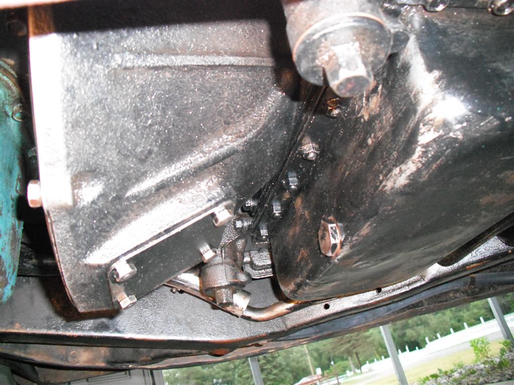

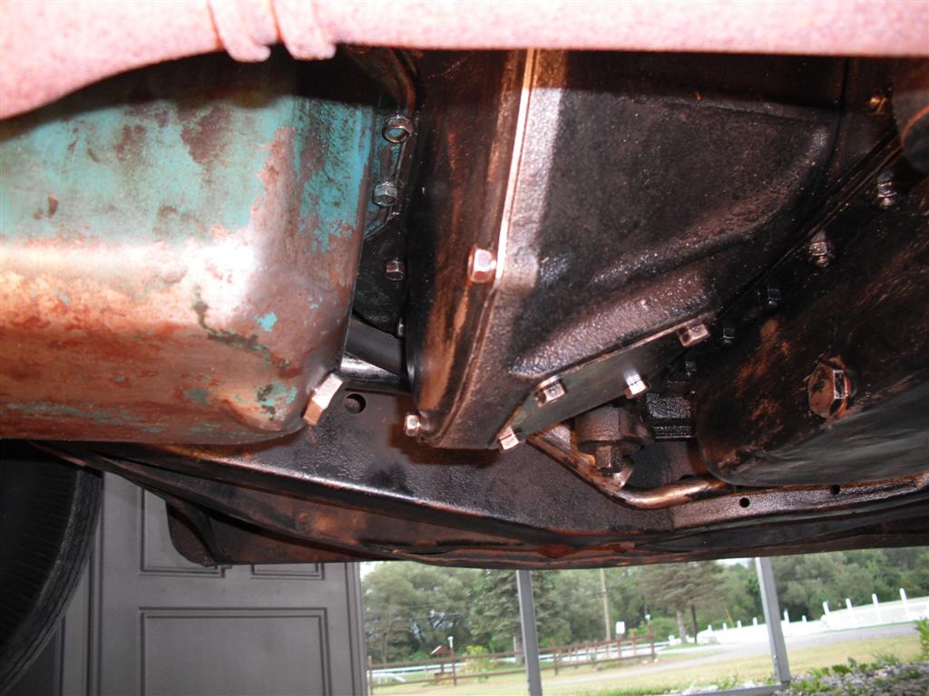

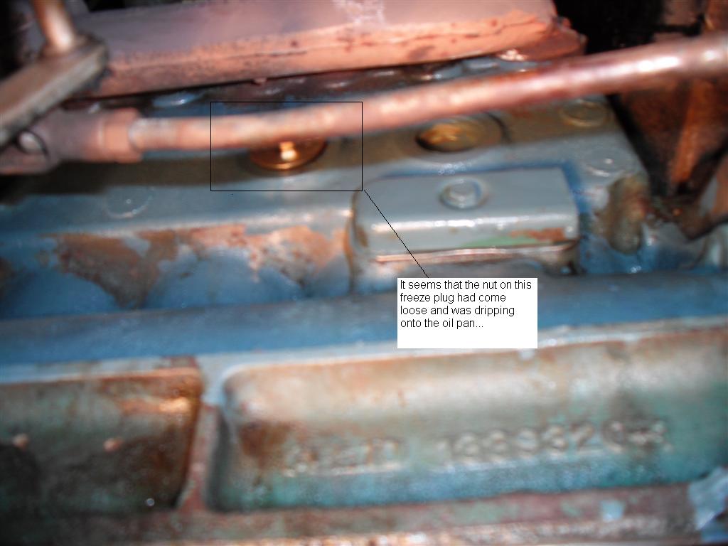

    Well guys I put the Buick up on ramps this morning. Wiped everything clean, spread newspapers underneath and let her sit. No leaks. Then I started her up and let her run for awhile and get up to temperature and then shut her off and watched for leaks. I think I found the leak! It appears to have been coming from a new frost plug that was put in. It seems that the nut on the end had loosened a bit and anti freeze was running down the block, onto the oil pan and dripping beneath the car. I've attached some pics.
    Let's hope that's it!
    Thanks for everyone's help and input it was as always greatly appreciated
    You guys are the best
    Scott

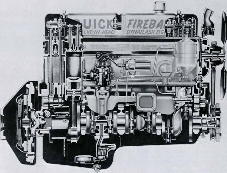

    Here is a cutaway of a buick 8. It appears that there is no freeze plug on the back of the block, altough there is one one the back of the cylinder head.

    See, I knew you could get to the bottom of it, literally. Slide under, take a look and you found it.
    Bob
