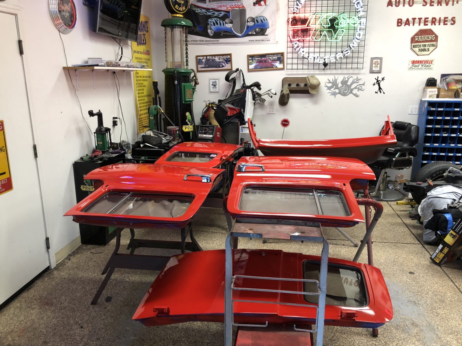

    Painted these a few weeks ago with catalyzed acrylic enamel / activated urethane clear. Started wet sanding and buffing this week. In order to keep the peace, I will not say what brand of enamel I used...
