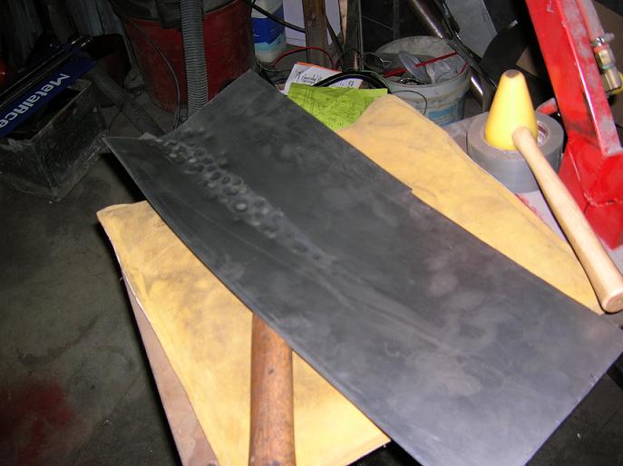

    I used a blocking hammer to rough the panel into shape.

    I then took it to the english wheel and rolled out all of the lumps.

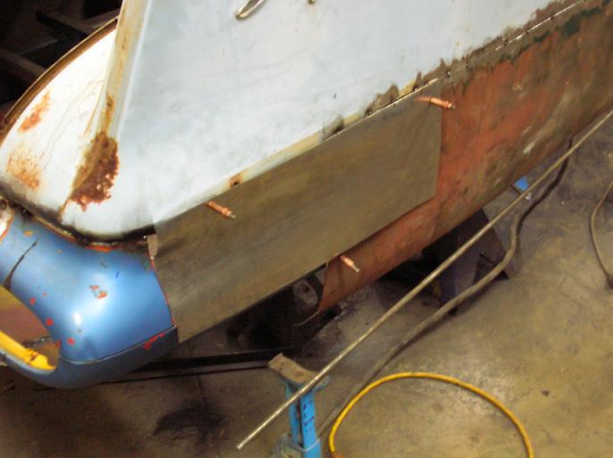

    Then I put it up on the car to size it up. Clecos are your friend.

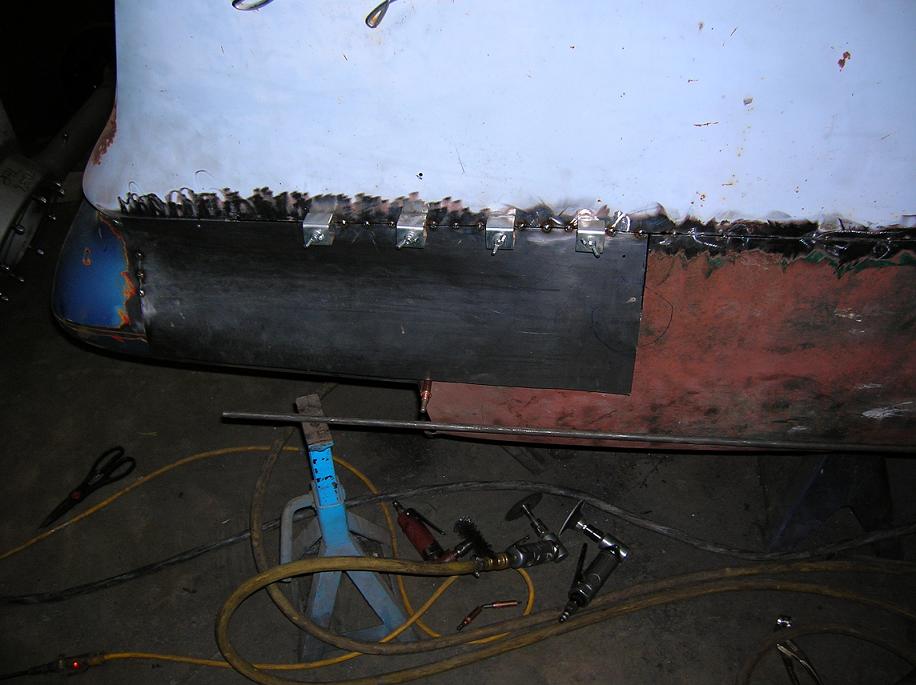

    As you work the metal it tends to do weird stuff to the outside edges. You need to shrink and/or stretch them accordingly to get the waves out of the metal.

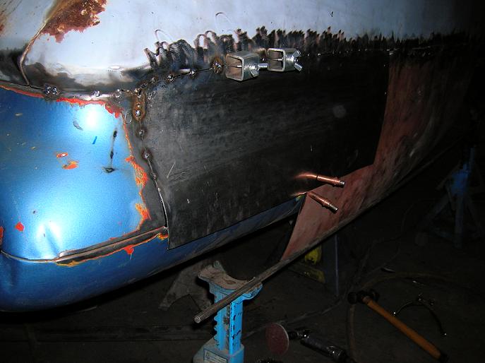

    Once you get the panel to fit halfway close, you need to trim it down closer to the size that it needs to be. The extra material can hold a lot of shape and by removing it is is easier to get the piece you want to fit to take form.
    I started tacking this piece across the top before I cut it off at the bottom. Don't get in a hurry to cut the pice to fit the hole you have because as you weld on it it pulls things tighter here and there and you will end up with a big gap if you trim it up too soon.
    I use a cut off wheel in a right angle grinder to do all of my cuts. If you use a thin wheel then you end up with a close to perfect gap for the butt welding clamps to fit.

    I just cut the piece to fit and tacked as I went and before you know it, you are done!
    I still need to finish weld the pieces. I may do that tonight, but you know 24 and CSI is on, so I will probably just lay on the couch and watch TV. Ha Ha Ha
