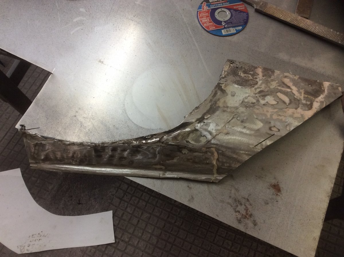

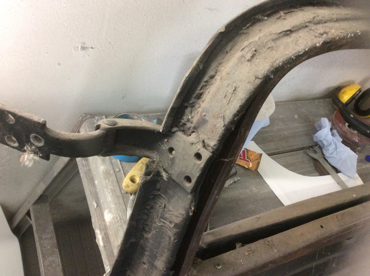

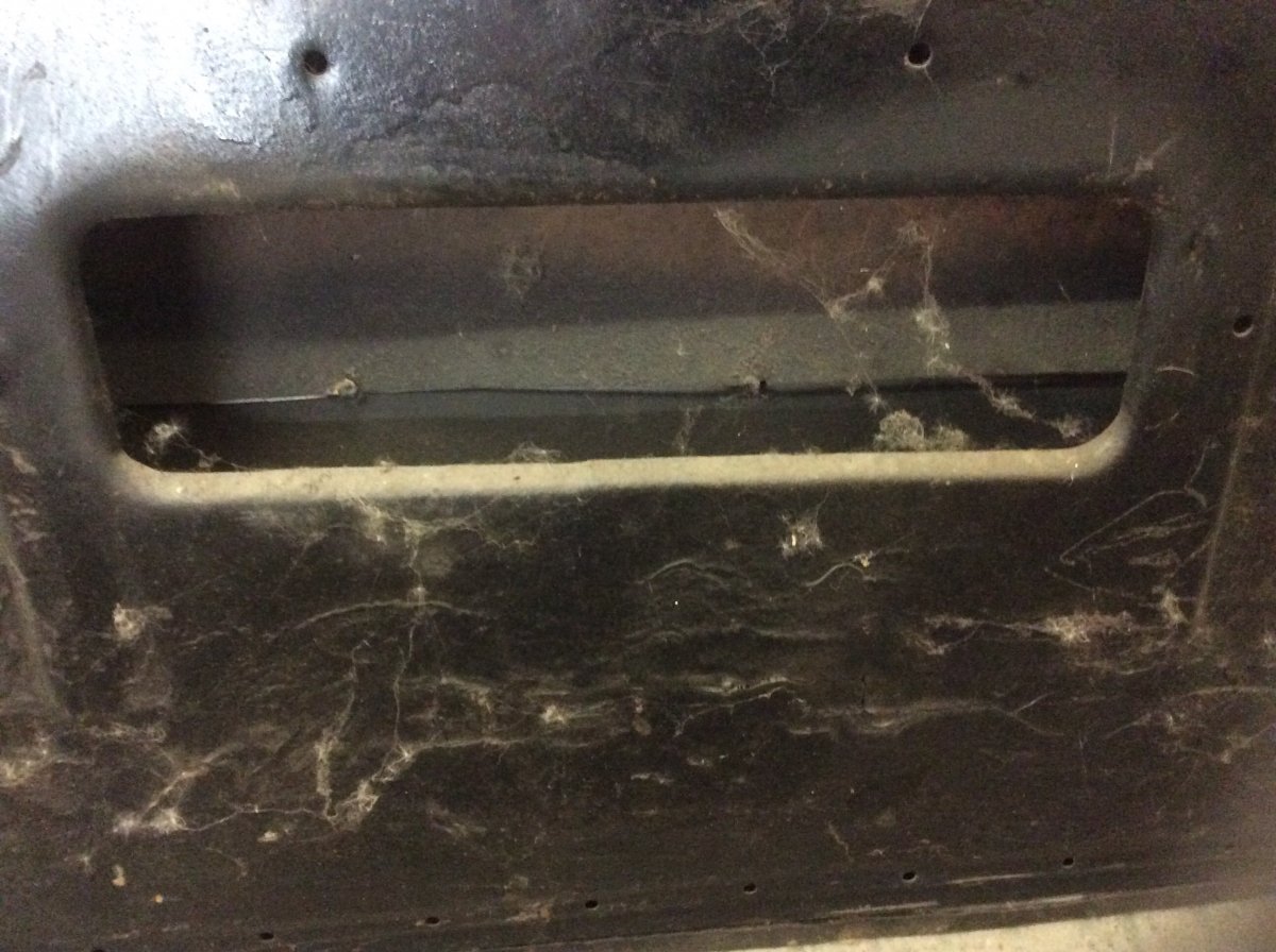

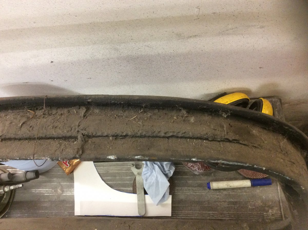

    image.jpg image.jpg image.jpg image.jpg image.jpg image.jpg image.jpg Piece I removed from top of left rear quarter panel to roof, and the lovely doors I have to work with, piece of metal with a few tacks on lower door then covered with plod,,, quality, not bothered to fix top hinge to door frame properly just a couple of welds hold it in place.

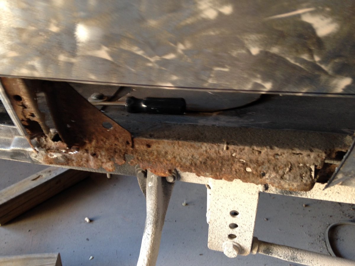

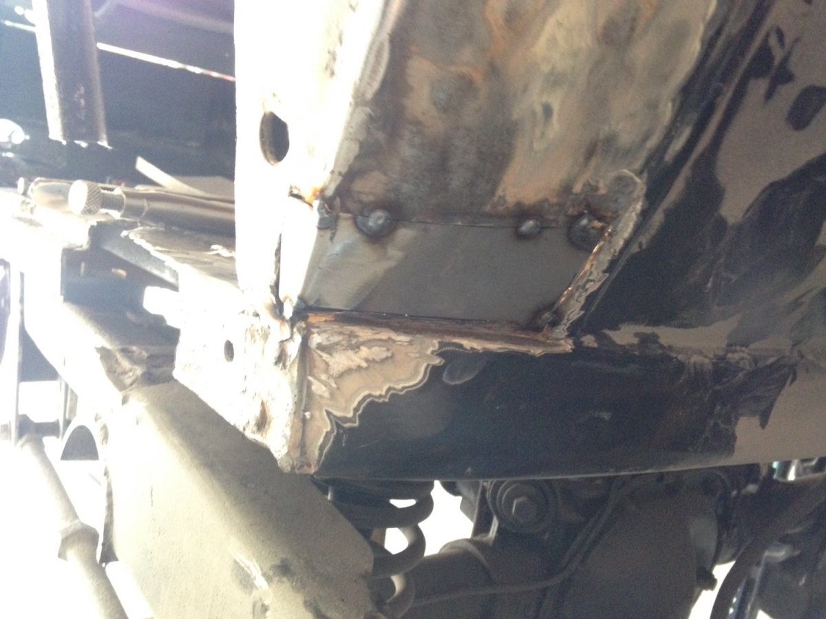

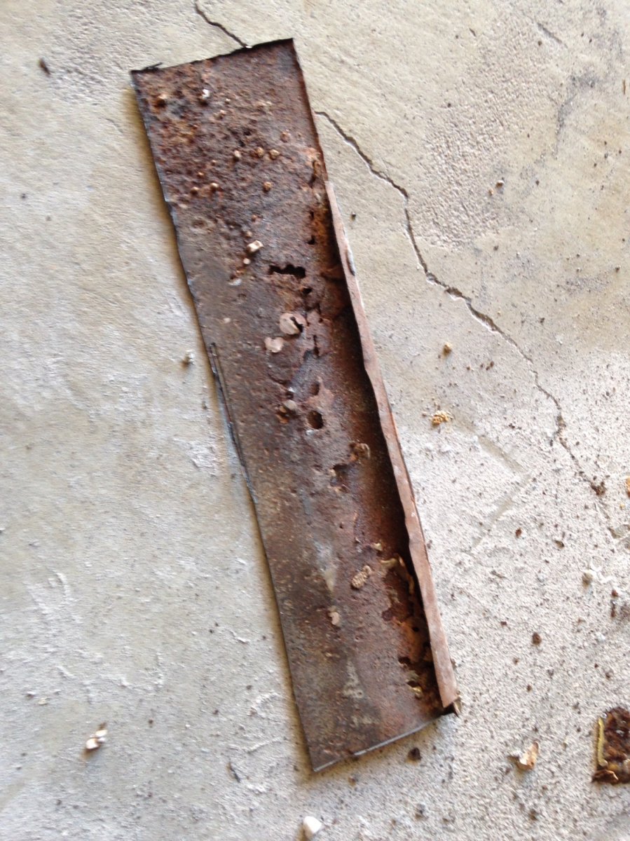

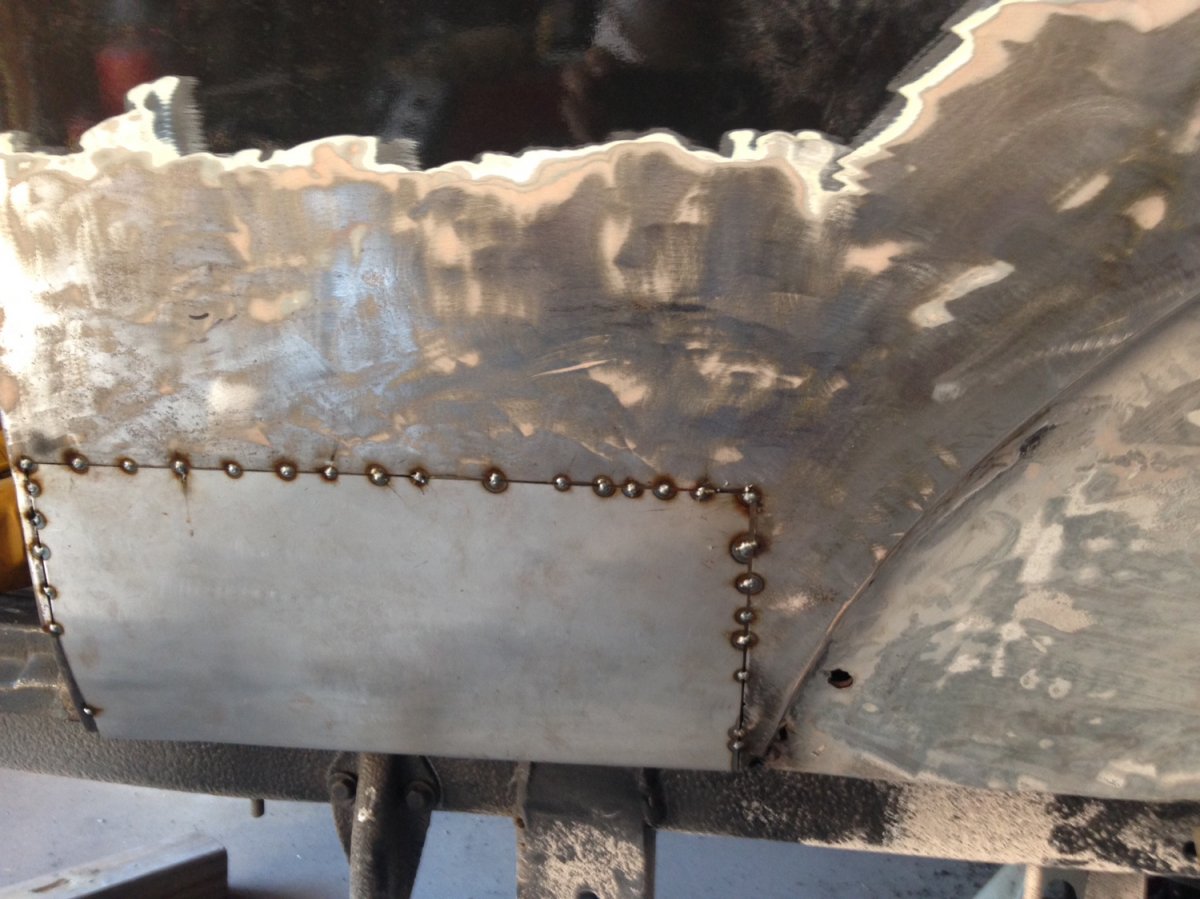

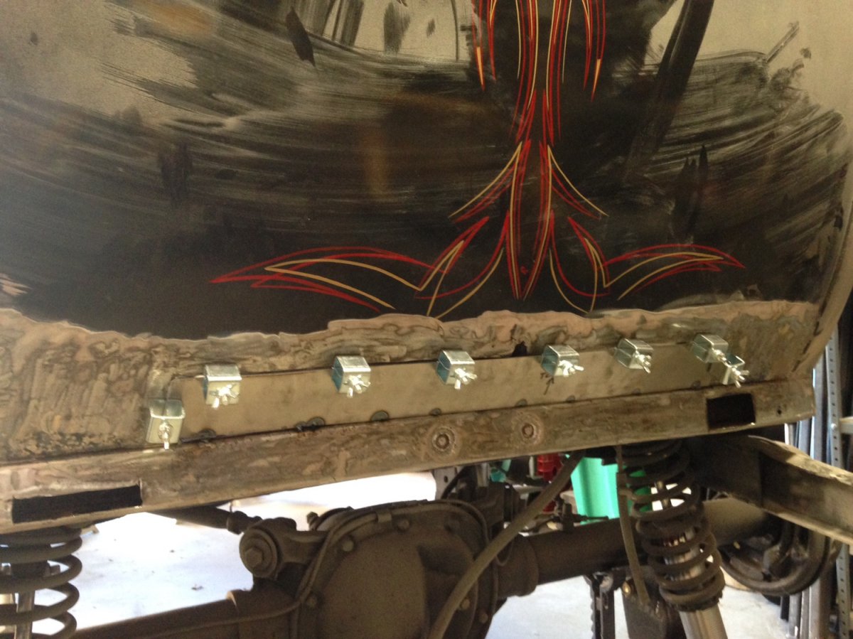

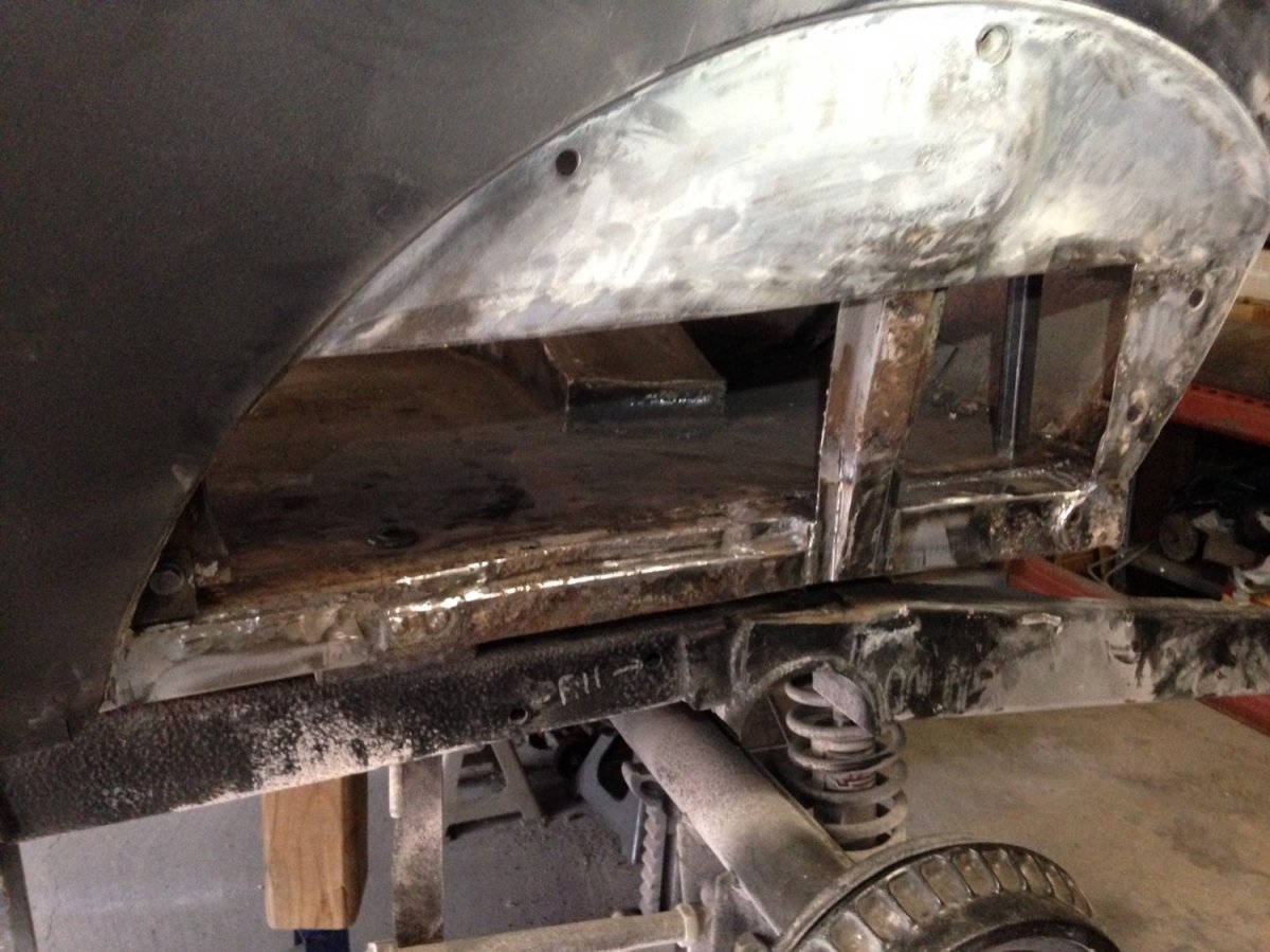

    Sorry to hear that. Looks like you’re taking it in the right direction though by fixing it “right”. At least the seller of my Model A was honest as my Model A wasn't miss-represented. I knew it had poor patchwork and the seller pointed out all of the bad spots that needed repaired properly.
    If it makes you feel any better, my Model A had filler almost a full inch thick in some spots. They also just welded 20ga galvanized sheet over anything that was rusted (without cutting out any of the rusted sheet metal), then slathered it with more bondo.
    So I’m replacing all of lower panels and sub rails all the way around. I don't have pictures which show them finish welded after I put the patches in; I just kept making tacks, grind them down, hammer/dolly the shrinkage, then repeat till the entire panel is welded.
    So chin up, you’ll get it fixed in no time.
