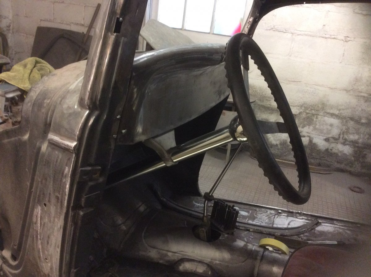

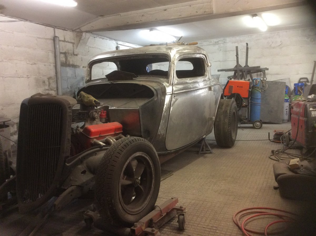

    Little more done still working on the left side. Top of the door frame was a mess so ended up making a new inner frame. Mounted steering column too. image.jpg image.jpg image.jpg image.jpg image.jpg

    Amazing great work. U should be proud. A saying in the us - u turned a pigs ear into a silk purse

    Thanks very much, I'm feeling good about it now, starting to look like a car now

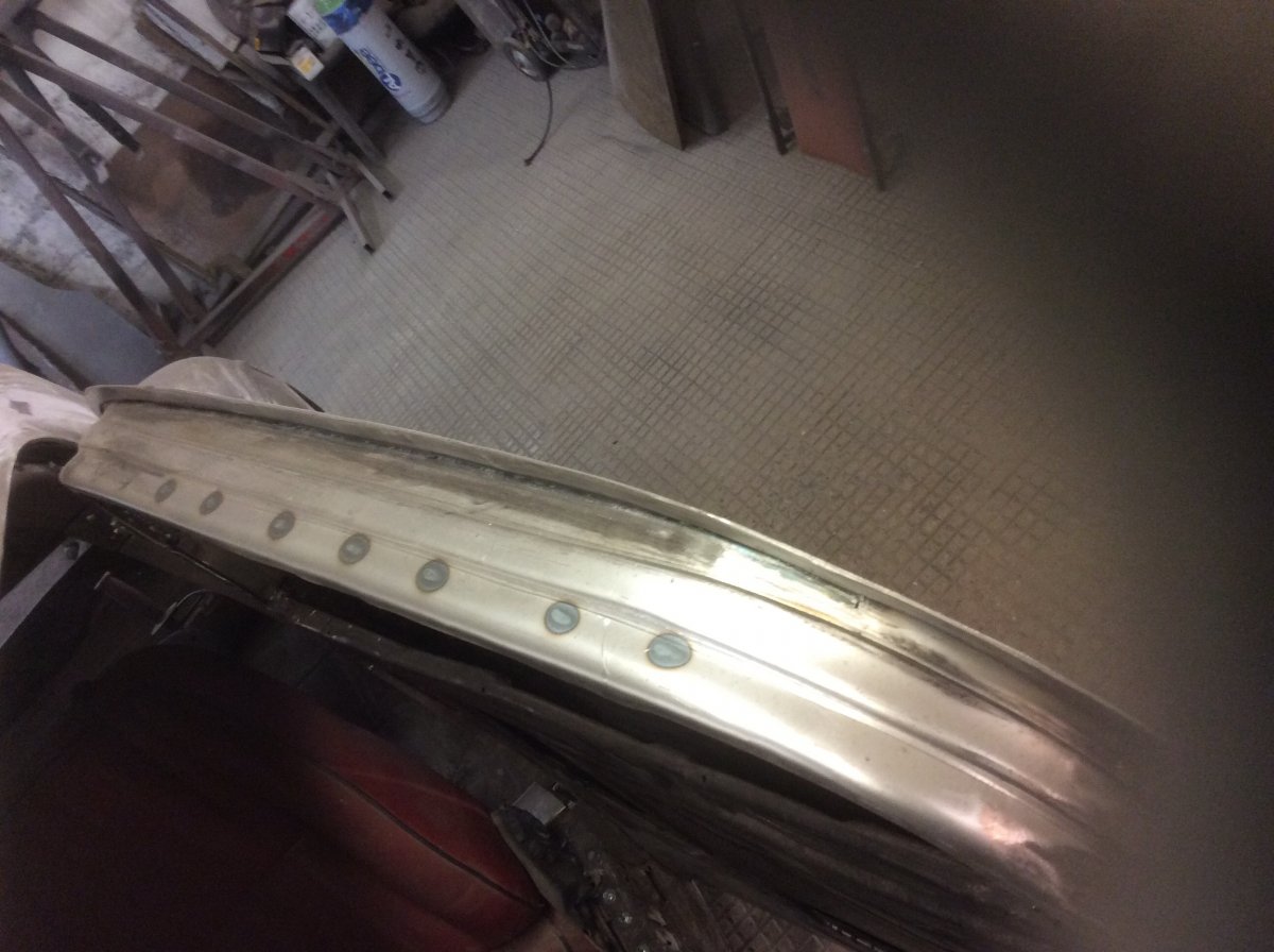

  14. 39WILLZ
    Joined: Dec 13, 2009
    Posts: 273
    39WILLZ

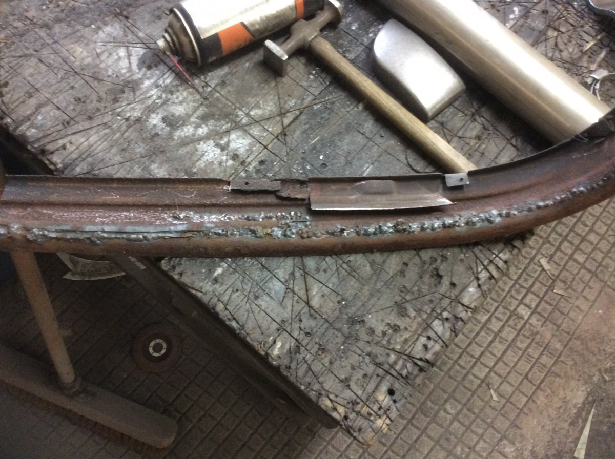

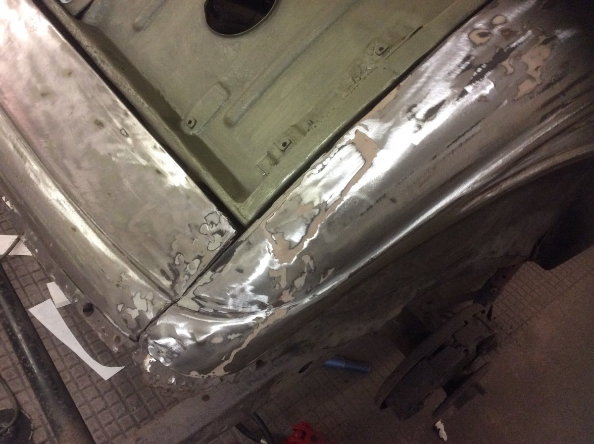

    image.jpg image.jpg image.jpg image.jpg image.jpg image.jpg image.jpg image.jpg image.jpg image.jpg Been a bit slow, moved round to the rear working on the deck lid as like the rest of the car the lid was a mess and full of bondo so cut the skin off and repaired inner frame and planning on making a new skin. Also changed from a rumble lid so made up a pair of hinges as didn't have any. Repair rear quarters where they meet the deck lid as they had bad repairs and topped off with lots of bondo.
