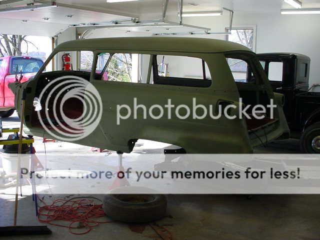

    I've used a 4X4 through the quarter windows to lift my '40 body in the past, but had to come up with a better method when it finally gets painted. I'm using the two 2-ton stands to lift the rear while an engine hoist lifts the front, and will be used to transfer the painted body from the dolly back to the frame.

    Those are the jack stands (the ones holding up the rear of the car) that I was talking about using
