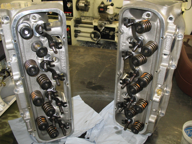

    505 CI, eagle rotating assembly, 12.5 to 1, my brodix cylinder heads, a custom grind roller thats 262 and 271 at .050, 685/660 lift.
    I had to open my spring pockets to get a larger diameter valve spring installed, change the retainers and cups to match. Also changing carb bodies to a 1000 HP, its at pro systems right now getting tuned on a flow bench.

    great news....my heads are back with the new monster valve springs, TI retainers and the valves clear the pistons with plenty of room. I spoke with SRP and they said I could fly cut the dome up to .200 to reduce the compression. Right now it is at 13.1 to 1.....I want to get it down to 12 or 12.5
    The cam is supposed to be .683 lift but it shows .704 on the indicator??
