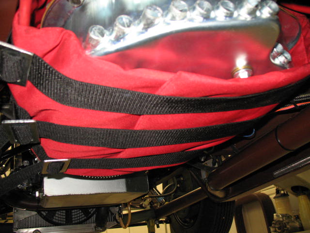

    for safety I also put a blanket on the trans when the motor was out.

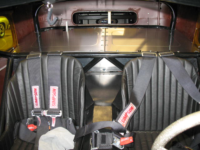

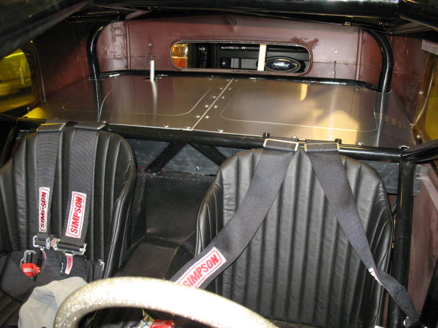

    Working right up to the last minute. We made these panels today for the back of the sedan....it looked kind of ****ty before. We are loaded up and ready to go. See you guys there.

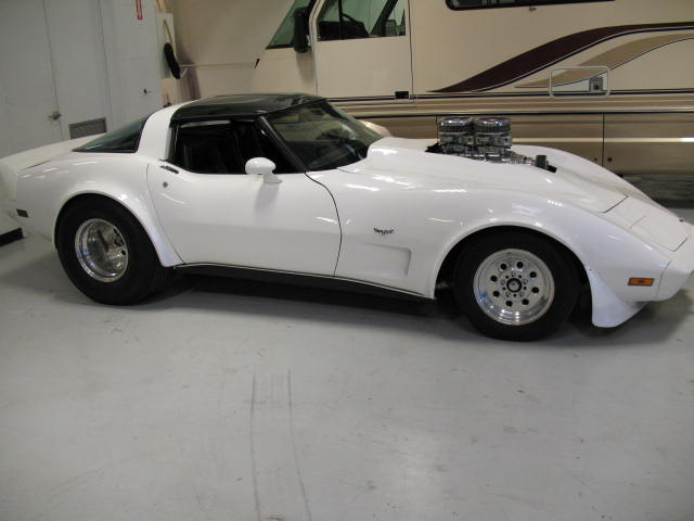

    Ryan begged us to bring the mullet corvette, but I told him no. (no its not mine)
