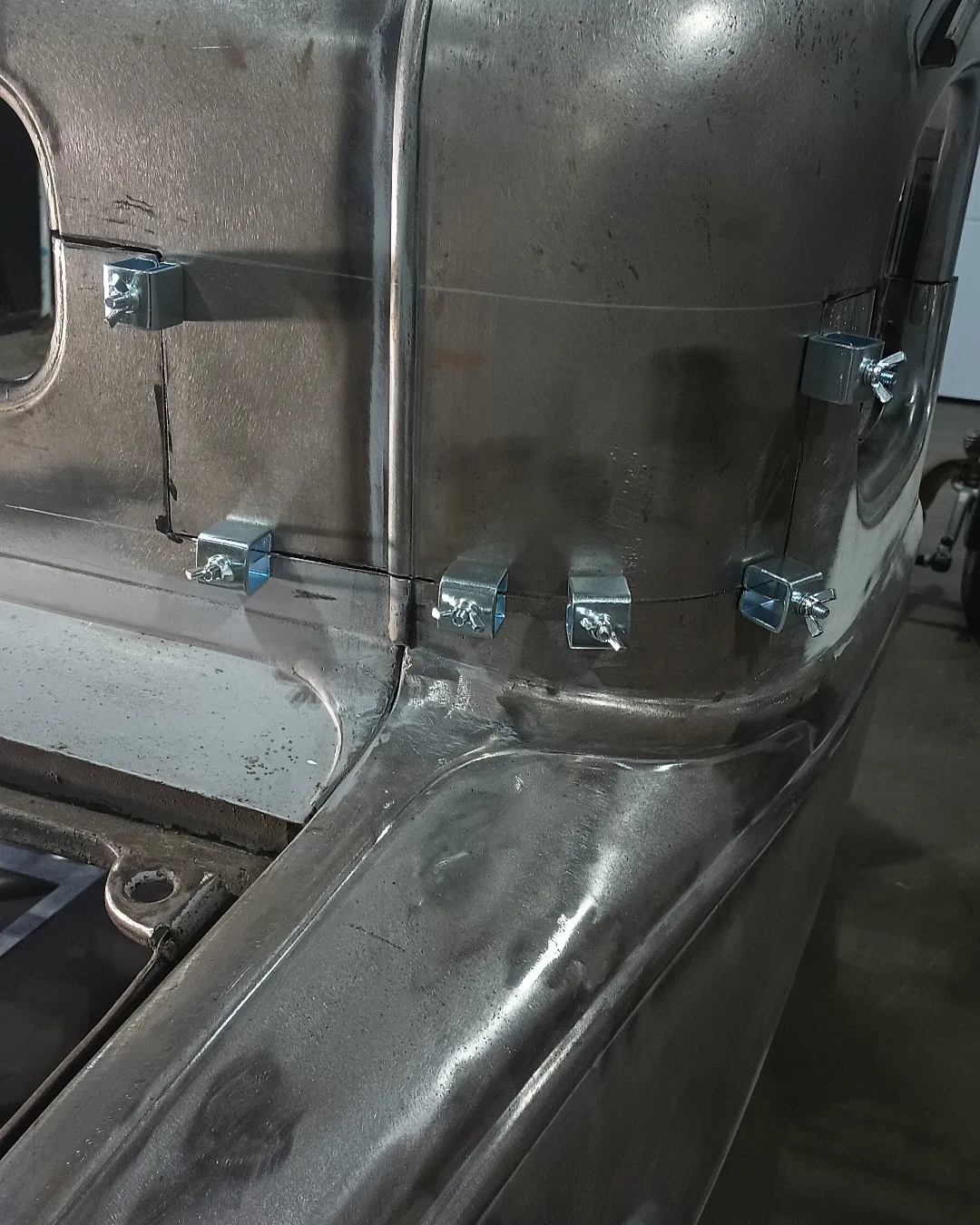

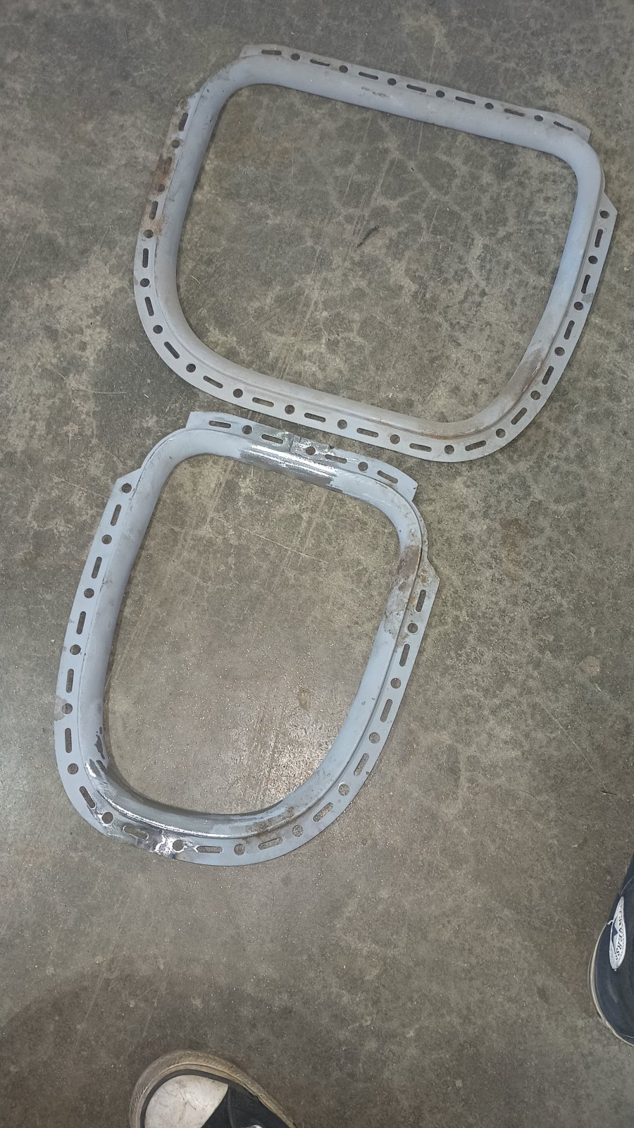

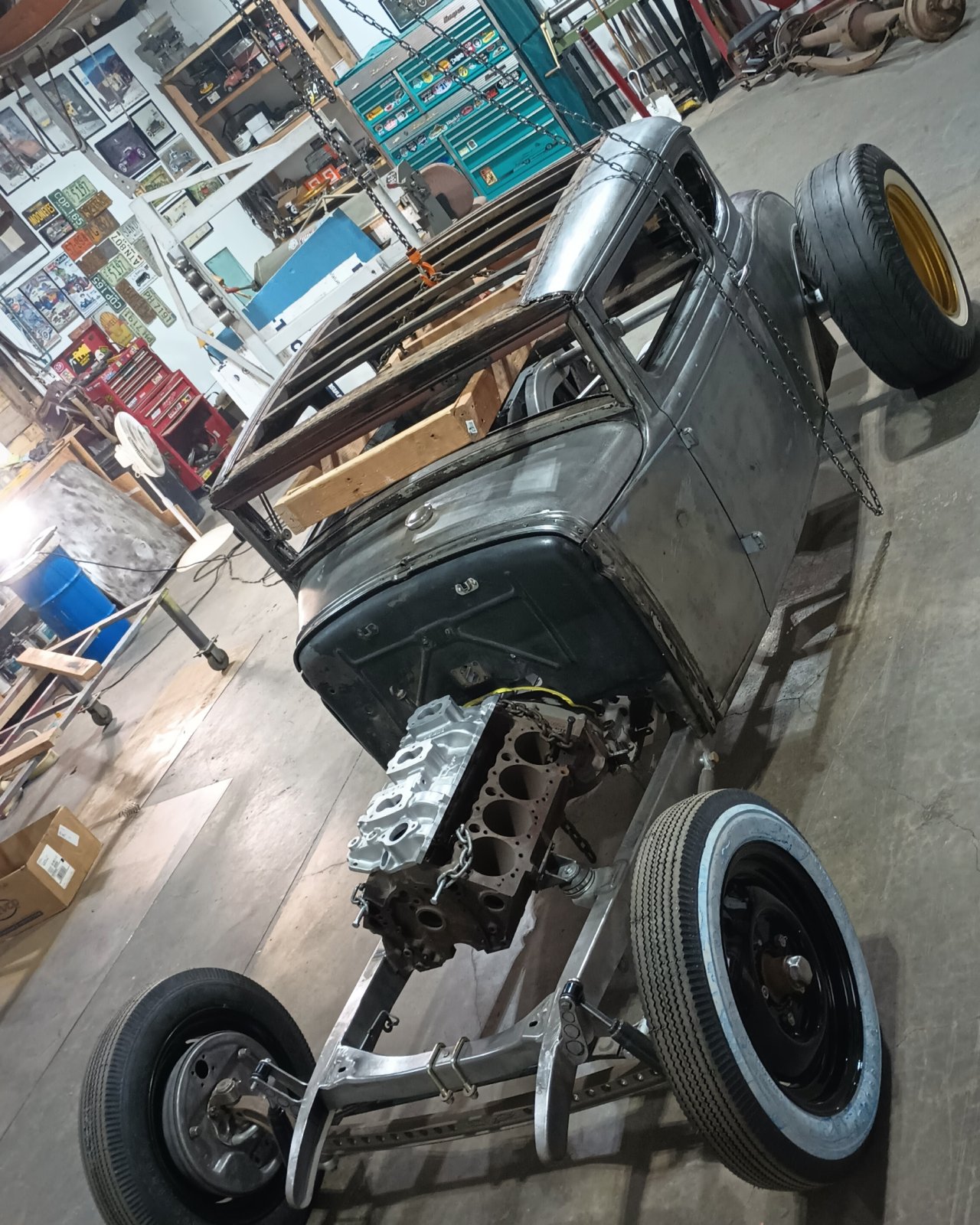

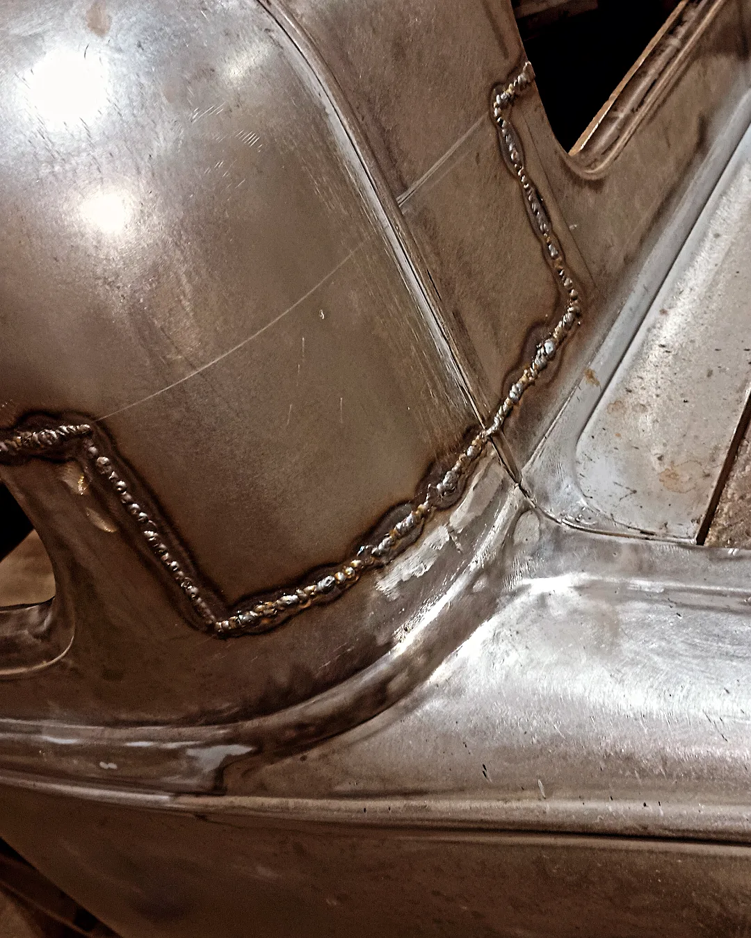

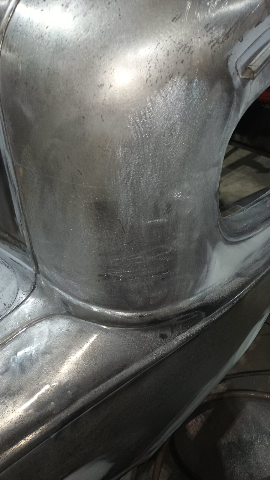

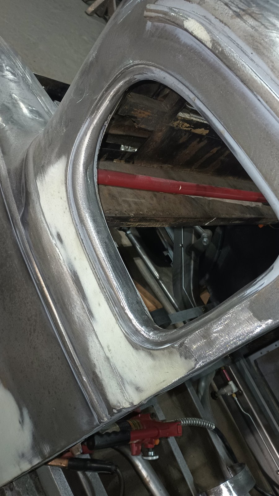

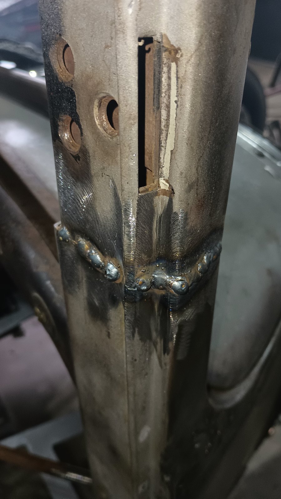

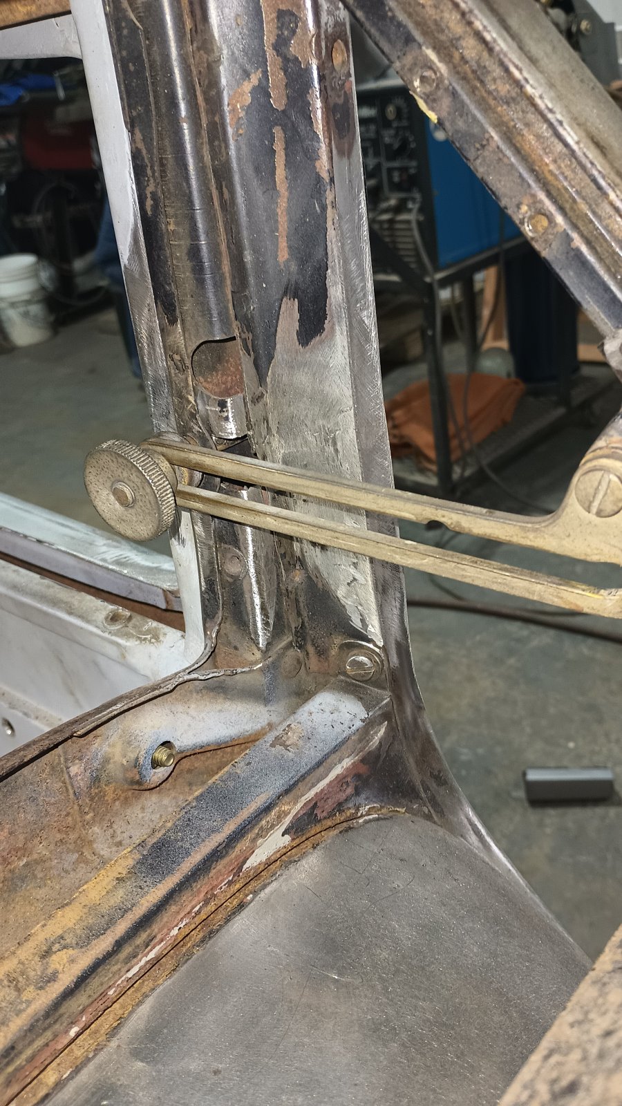

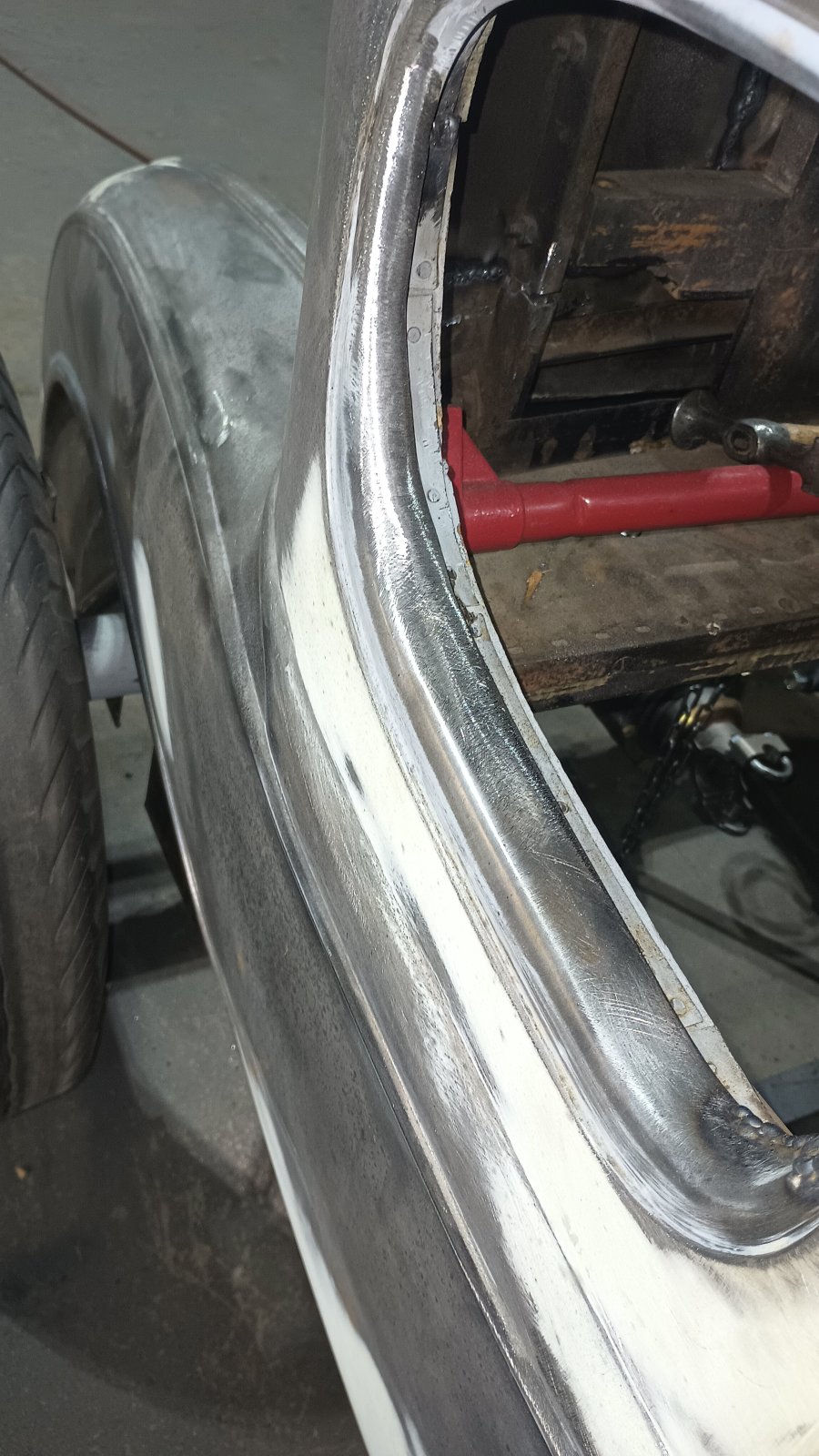

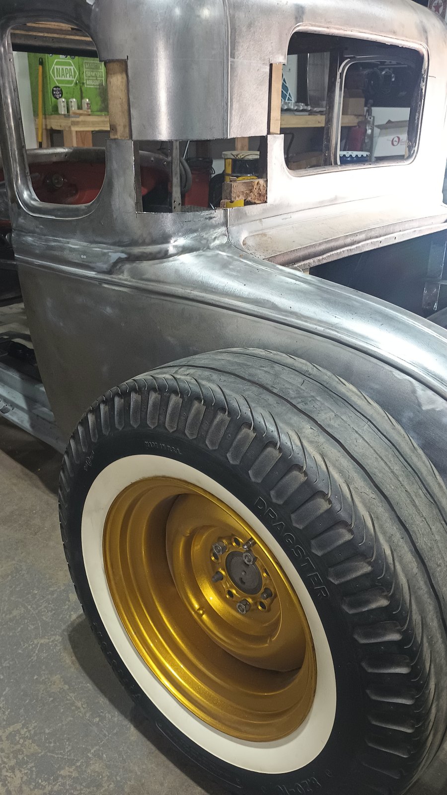

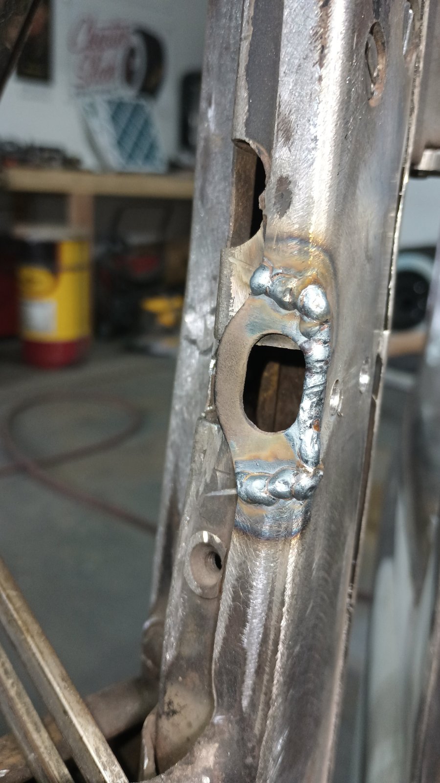

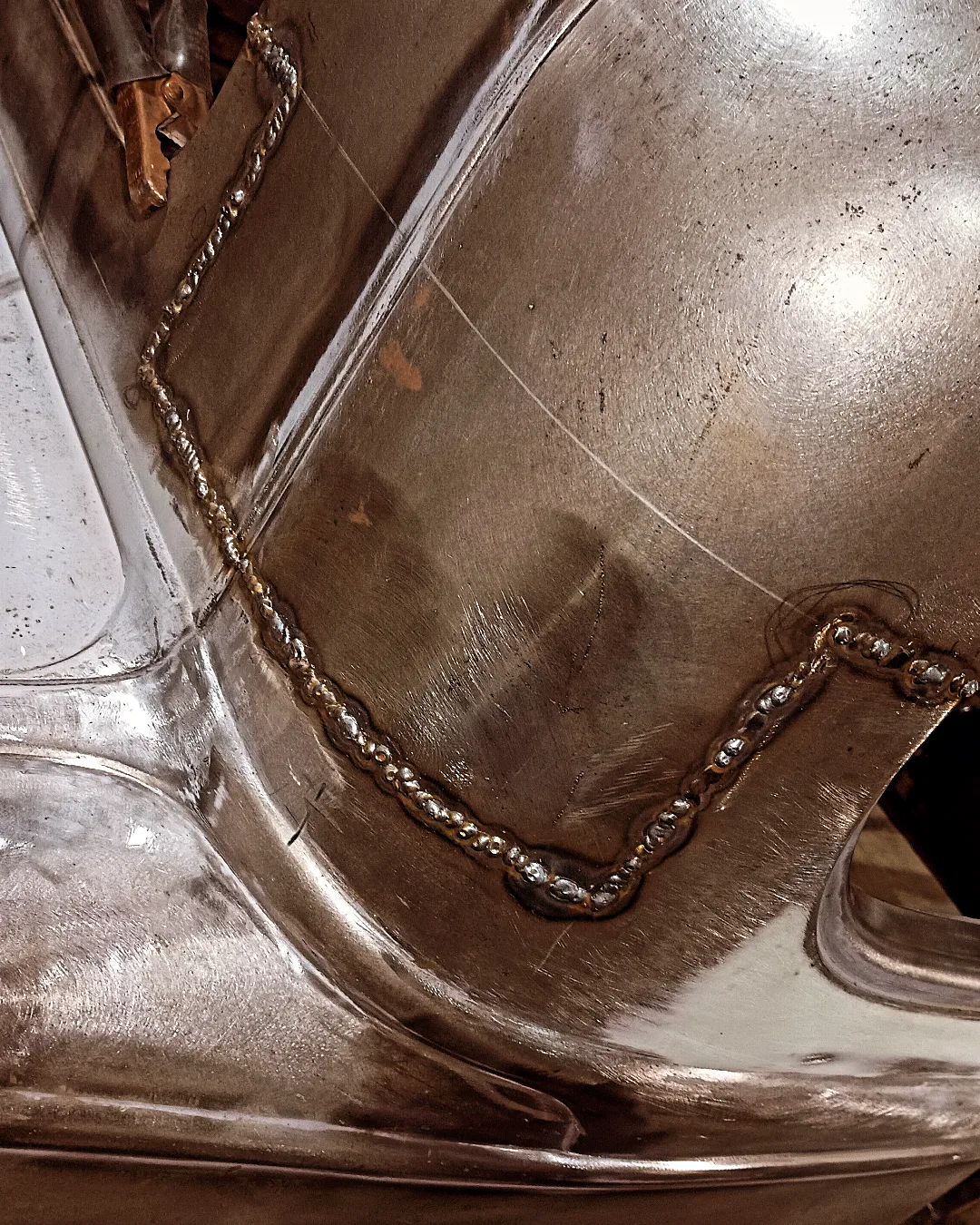

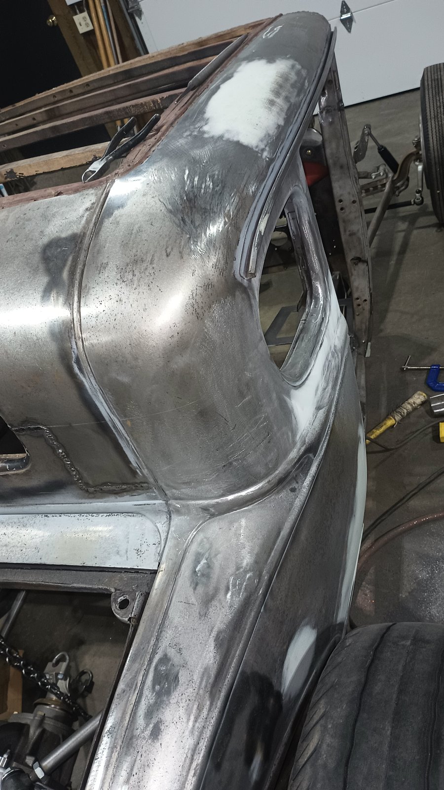

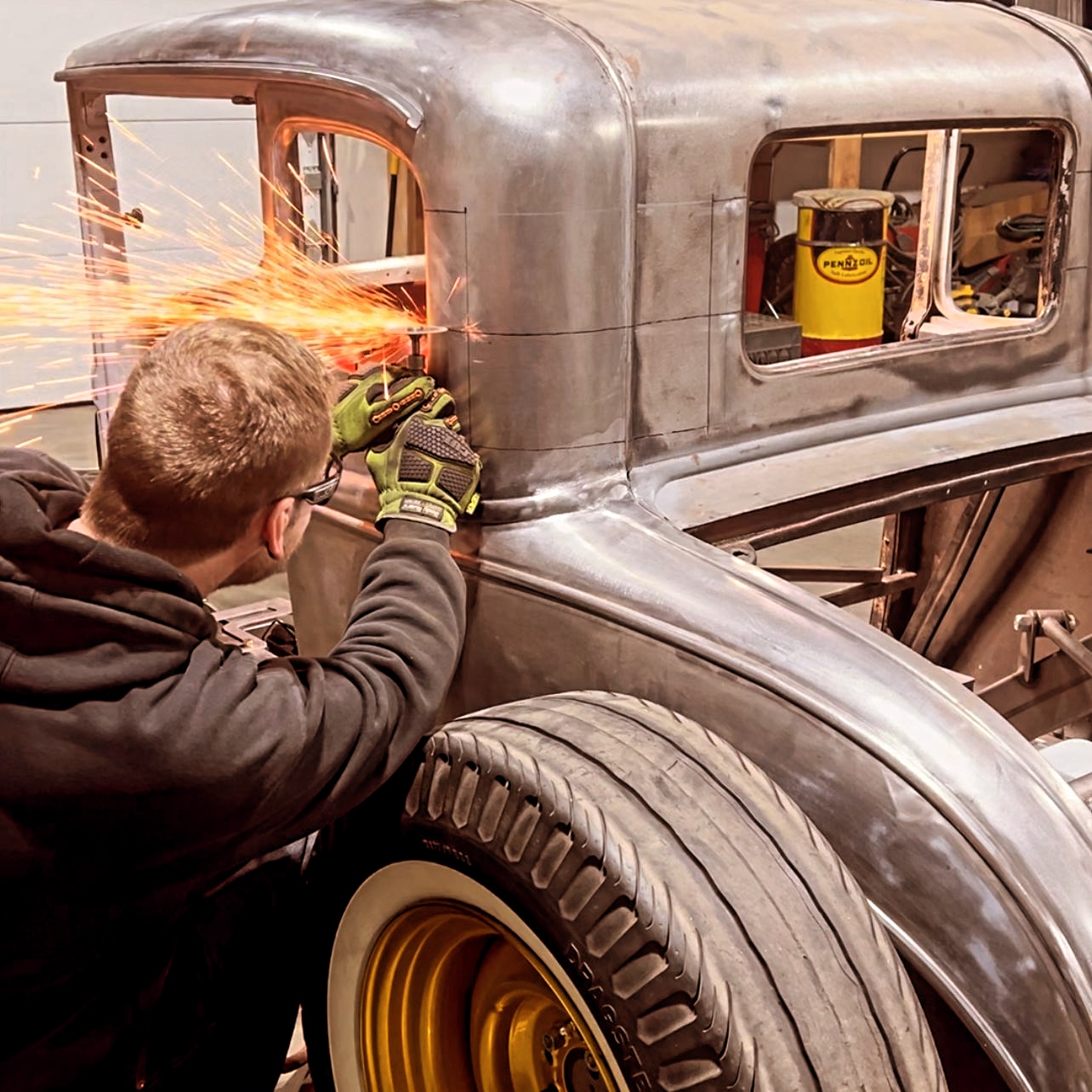

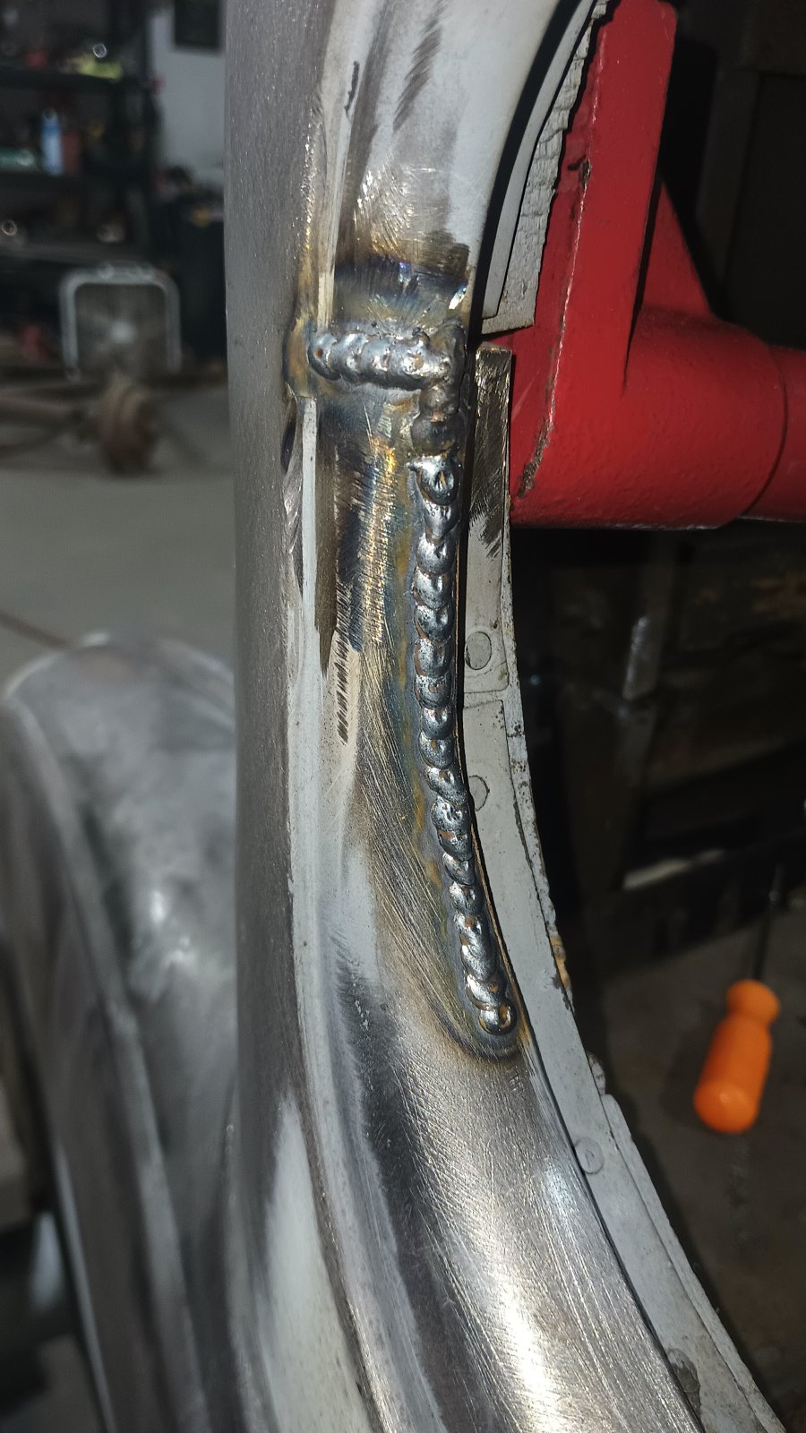

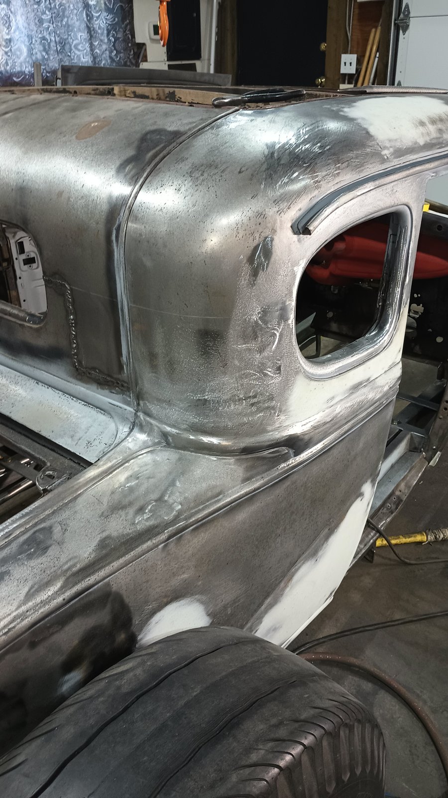

    VENDETTA COUPE 5 inch chop. During the process of chopping my coupe or preparing anyway. I searched for others posts here to see what guys had done and what was the best way to do it. If this post helps others I am happy and have done well. This chop was done in just under two weeks. With about 6 or so hours a day maybe more. But I decide to step cut the rear and it was money. There was so much after the cuts to get things to align plus all the window frames and then the doors. If anyone had any questions about what has been done feel free to ask. Thanks for looking. Hot rodding is life. IMG_20240407_192343916.jpg IMG_20240411_140019969.jpg IMG_20240424_121911062.jpg IMG_20240404_122351515_MP.jpg View attachment 6041571 IMG_20240414_181204337.jpg IMG_20240413_165112147.jpg IMG_20240413_174253526.jpg IMG_20240414_181137696.jpg View attachment 6041580 View attachment 6041581 IMG_20240414_182954483.jpg IMG_20240414_183007799.jpg IMG_20240415_124315515.jpg IMG_20240419_113558210.jpg IMG_20240419_113605629.jpg IMG_20240419_181215_748.jpg IMG_20240424_111213242.jpg IMG_20240425_145236_170.jpg IMG_20240407_192343916.jpg IMG_20240411_140019969.jpg IMG_20240424_121911062.jpg

    Nice! Looking forward to seeing a full side shot, quarter window height looks just right. Bob

  8. Aaron laughlin

    That's the million dollar question. I'm 6ft1 and 200lbs and I fit just fine. There is enough head room and leg room. There is a package tray underneath the back window that comes out and gives the interior a bunch more room

    Great job and thanks for the pictures. Where did you brace the body before doing the cut?
    Aaron laughlin likes this.
  12. Aaron laughlin
    Joined: Sep 15, 2019
    Posts: 65
    Aaron laughlin
    I did four braces two right behind the doors one was horizontal and the other triangulated to stiffen from side to side. Then two more from the front to back in a x pattern. They were welded just under the dash to the a pillers on both sides then crossed each other and connected to the two braces in the back. It worked perfect nothing could move due to the triangulated pattern.

    Really like the way you did the the rear window

    It didn't end up looking like, as many heavy chops do, the mail slot in a house door.

    Oh yeah. I hear you. I did my 29 Tudor the same and I cut down below the frame to extend the back window so that the exact thing wouldn't happen. you are right when the window gets all squished it's out of place and just doesn't flow anymore.

    Thank you for saying so. I really did think this through and studied up. I wanted it to be nice and wanted the hamb to have the chop top coupe on here because I couldn't find any or info on where to make cuts, how to manipulate the window openings, making sure the door openings measure the same from side to side the 47 degree windshield frame people always cut at 45 and get wrong. Because I wanted to share so others could learn if they need.
