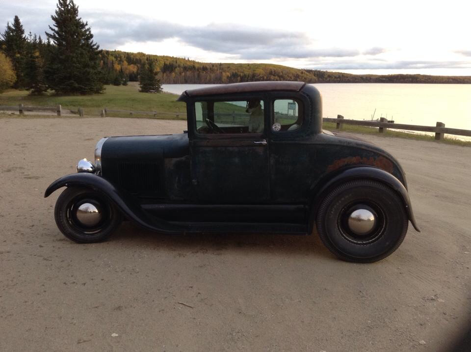

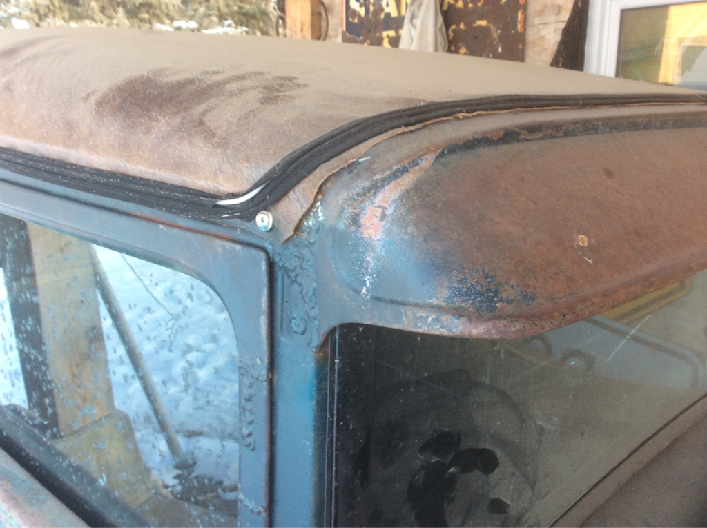

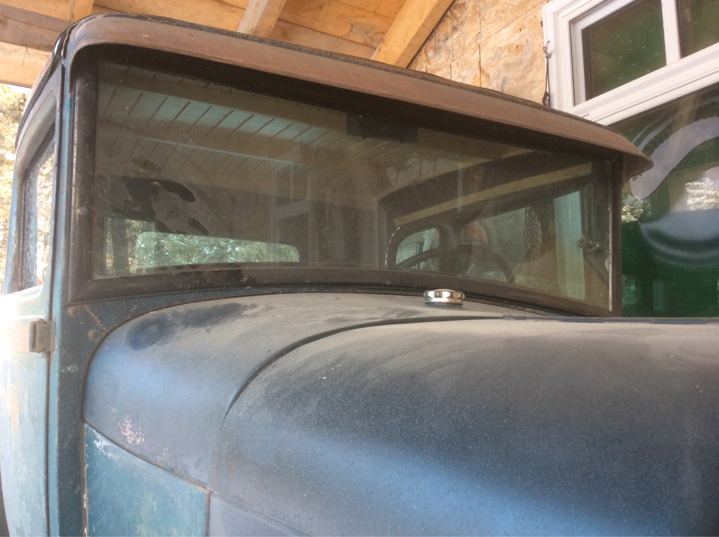

    Someone messaged me wondering about the amount of chop on my coupe,and how the 30 visor was attached to the body,long story short,I lost his info,so here goes.the chop is 2-3/4" basically took the header out above the windshield. Did not chop the windshield,just lowered the visor to it,and that dictated how much the chop was to be. ImageUploadedByH.A.M.B.1451581932.267599.jpg ImageUploadedByH.A.M.B.1451581959.416519.jpg ImageUploadedByH.A.M.B.1451582017.604484.jpg

    Car looks great, not overly chopped but not stock either. What tire/wheel sizes you running it looks perfect.
  11. I'm a chop fan, big or small.
    Your Coupe has got nice proportions, and sits real nice too.
    1927graham likes this.
  12. Bader2
    Joined: May 19, 2014
    Posts: 1,143
    Bader2
    7.50-16 on a 5" and 4.50-16 on 4",4" drop axle,38 rear,spring behind,frame lengthened,no z,flatty with 38 3spd and banjo. And thanks Jeff,I like it!

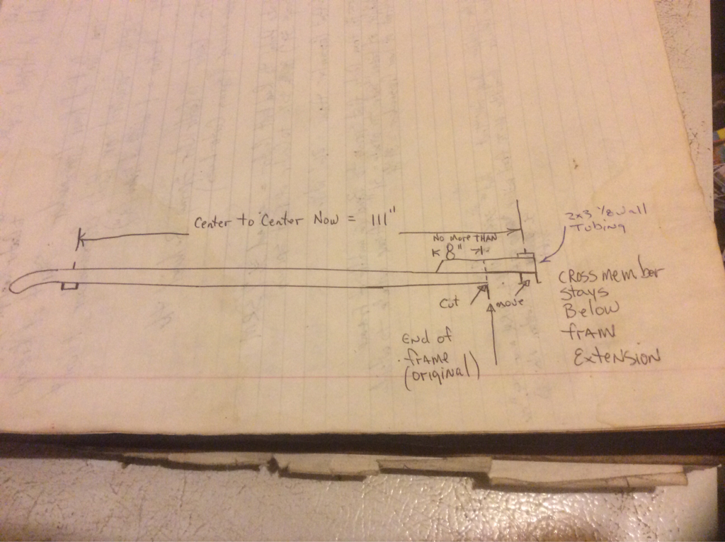

    Awesome looking car I love everything about it. I was thinking about doing a spring behind deal on a 30 coupe I'm currently building. do you have any pictures of how you did yours?
  15. Bader2
    Posts: 1,143
    Bader2
    ImageUploadedByH.A.M.B.1451657833.669684.jpg I can snap some pictures once the sun comes up.

    Thanks for taking the time to post the drawing, I'm thinking I'd like to keep my rumble seat, do you know if that's possible with a spring behind setup?
    Thanks
    Scott
  18. Bader2
    Posts: 1,143
    Bader2
    Seems quite likely that the rumble would work,may have to thin out the seat base,and get creative with the rear of the floor,but I don't see why it wouldn't work. ImageUploadedByH.A.M.B.1451761367.739511.jpg ImageUploadedByH.A.M.B.1451761390.773947.jpg ImageUploadedByH.A.M.B.1451761422.527627.jpg
