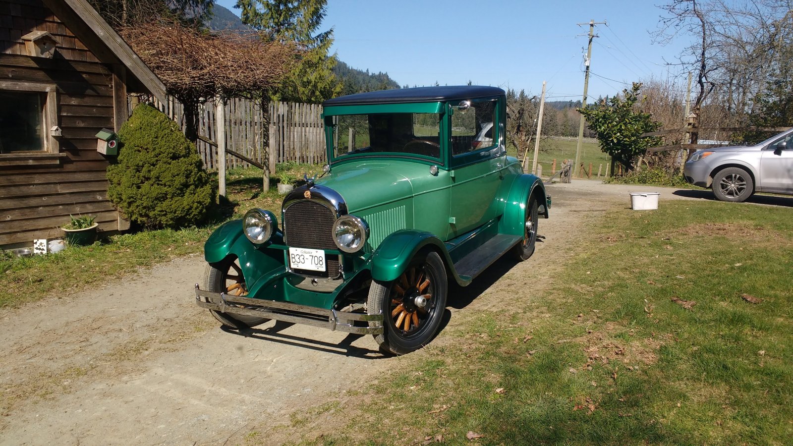

  8. You missed the point on the Chrysler Business Coupe..... he didn't want to do it, so much as he wanted to do it with you, and get you interested in it. He succeeded!! Nice job on it by the way.
    jimpopper, lostmind and 40ply like this.
