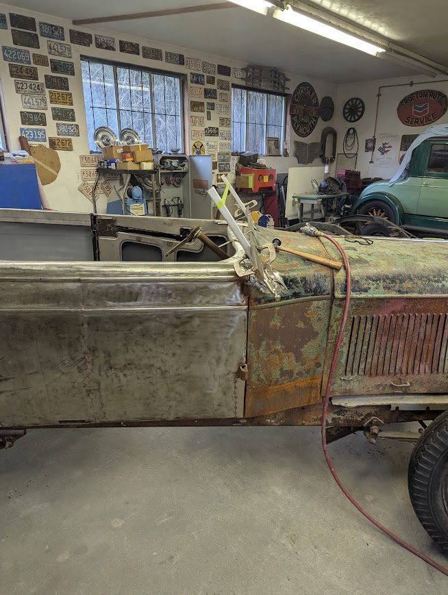

    Alrighty, I'm back! I had a much longer hiatus from this project than I had anticipated but I'm refusing to let this project and build thread die. It's taking me a bit to get familiar with what I was doing and so to get my feet wet I started working on the other half of the cowl (driver's side) and door. I made templates of the dash top when I made the p***enger side so it was quite easy to get both halves to match.

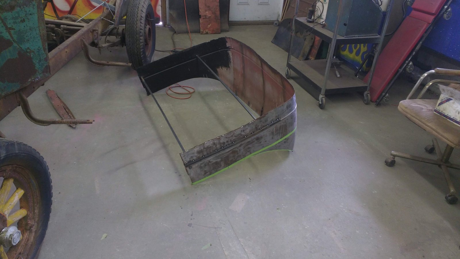

    I cut the top corner of the cowl out because I wanted to curve it more to blend it into the door top better because I felt like the p***enger side looked like it had really high "cheekbones" and my thought was if i fixed it on the drivers side I could redo the p***enger side with what I learnt. The shape of a '27 cowl is so curvy that anything I tried still looked off and after many attempts and trips to the s**** bin to throw out more mangled sheet metal I decided to see if a windshield post would hide the sharpness of the cowl top. The Chrysler cowl is similar to an early model A cowl and I could have maybe tried to follow what Ford did but I like the windshield stanchions on the 32's better so I decided to work on making a windshield stanchion that was reminiscent of of the 32 to see if it hid the high cheekbone appearance before having another go at the driver's side.
    First mock up was some sheet metal and round rod to see if it would make the cowl top less noticeable.
    So far from the front I'm liking it.
    The rear view wasn't so bad either maybe just needing a few tweaks to design. Now my curiosity being piqued I decided to work on the windshield stanchion.
  6. wstory

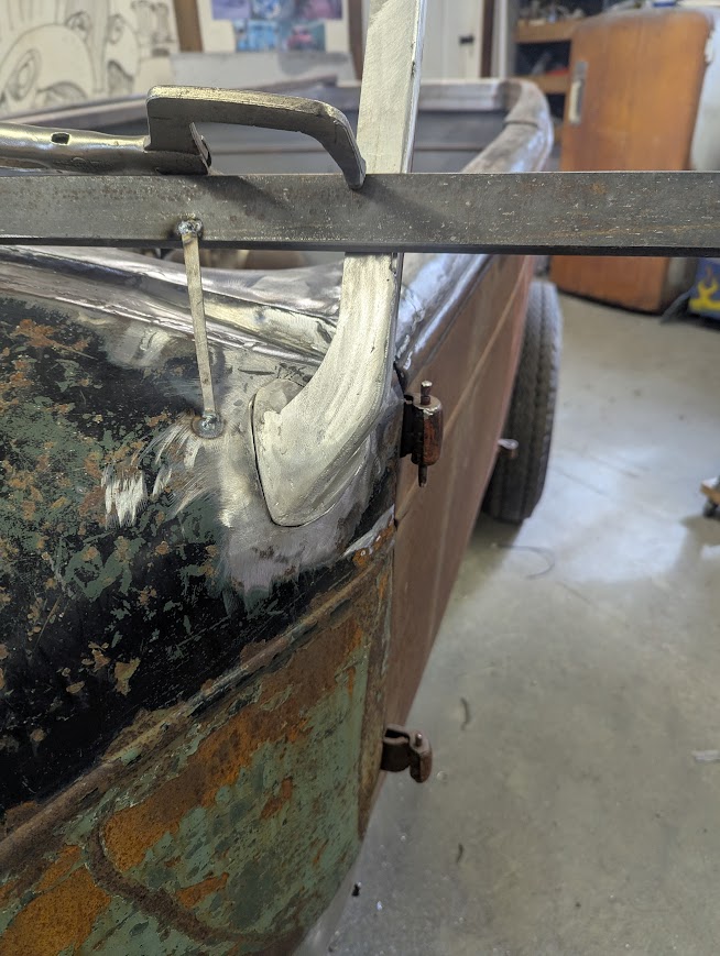

    I had another go at the tub this weekend, this time jumping back and forth between building the start of a windshield stanchion and the driver's side of the dash and cowl.
    This is the modified dash extension tacked in place. I'm not sure exactly what I'm going to do here to make up the shape but you got to start somewhere and since I had the template from the other side it seemed like a reasonable place to start.
    This is where I got distracted and decided to switch to starting to build the windshield stanchion, my thoughts being with the p***enger side made and dialed in then I'd have more reference for making what is needed to fill the missing parts of the driver's cowl.
    I started by carving a piece of 1/2" aluminum plate into a shape I liked and then t******* a hole in the cowl to fit it. I wanted to have some thickness to the base and be able to shape it to the cowl so that's why a thicker piece of aluminum instead of a thinner piece bent to the shape of the cowl.
    I made a little bucket to hold the aluminum base and weld into the cowl that way the stanchion base is flat and I can shape the top of the aluminum stanchion base to the shape of the cowl.
    Here it is fitted and ready to be tacked in place. then the next step is to cut it down and weld it in and smooth the welds.
    That done I rough shaped the aluminum base.

    Nice solution to the stanchion mounting. I have a Roadster and the stock mounting is just bolted thru the cowl sheet metal. The mounting pocket yuv created will certainly yield a more robust mounting. Good job!

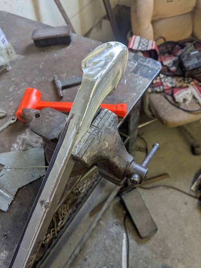

    Here's this weekend's shenanigans. I copies the p***enger side stanchion pocket and transferred it to the other side. PXL_20250309_201535444.MP (1).jpg
    This step was a little difficult because I had to make sure to get the pocket placed and angled the same as the p***enger side, so after taking some careful measurements...I eyeballed it! :D
    Here it is welded in. This allowed me to finally finish patching the rest of the top of the cowl.
    In this picture you can see my 1st attempt at mocking up the post was wrong and had to be cut off.
    This is a picture of the windshield post fabrication. Unfortunately I got caught up in the building and forgot to photograph a lot of it. I'm using 1/8" aluminum sheet cut to strips to form a 4 sided post.
    You can get the idea from the picture.

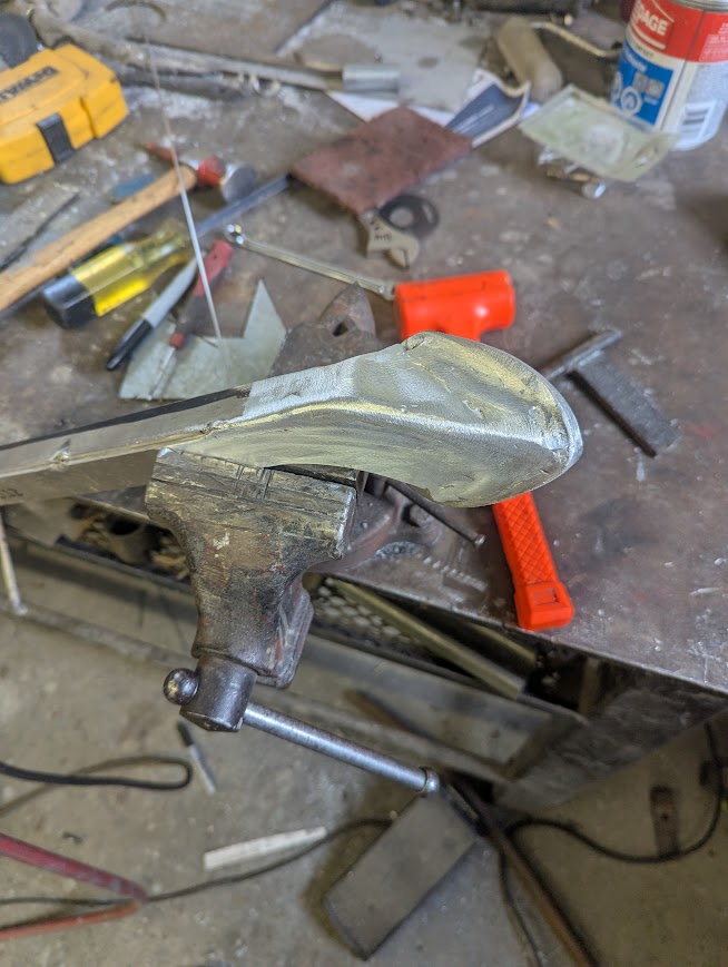

    Time for a little update. I tacked a bar across the cowl level and angled to make it easier to get symmetry between the two posts.
    The stanchion base was drilled and taped for 3, 5/16 NF studs to attach it to the cowl, hopefully that'll be sturdy enough.:rolleyes:
    The tape is simulating windshield height, 8" in the center and laid back to approximately 45 degrees. I'm not sure if this will be where it finally ends up but it seems like a good place to start.
    Not sure if I like the shape of the posts from this side profile. To me it looks kind of boxy and utilitarian so that part might change after I study a few close ups of OEM windshield posts.

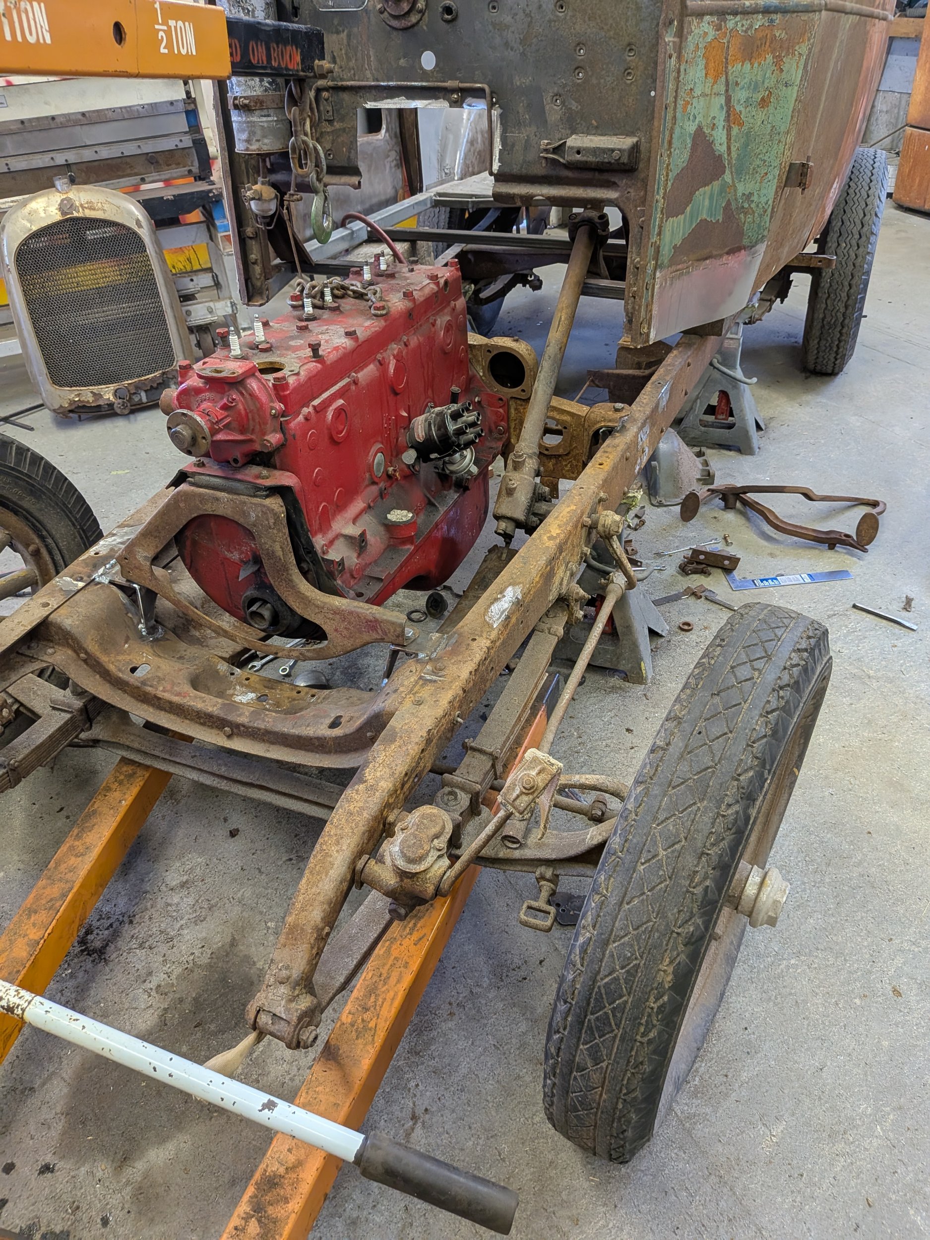

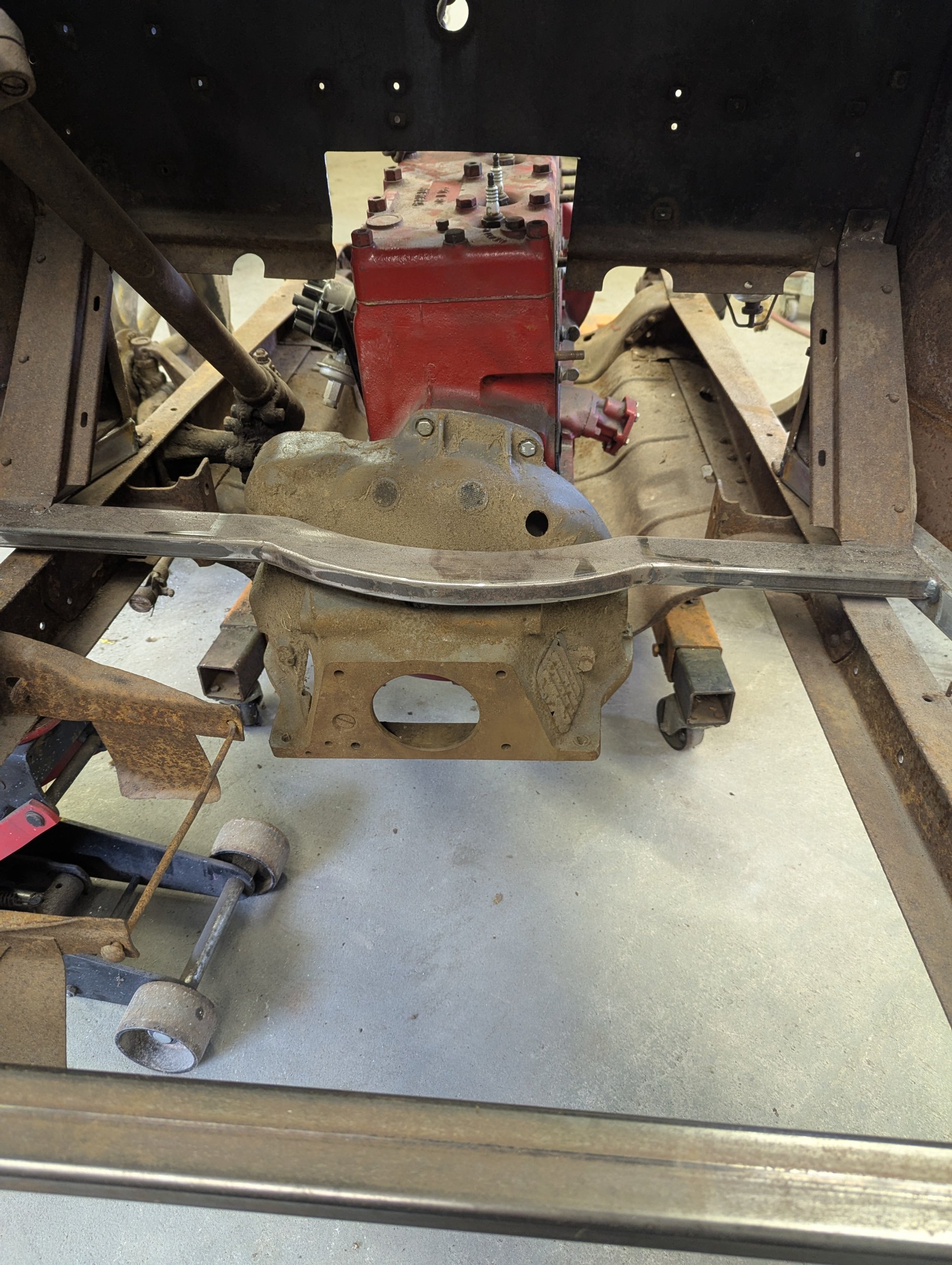

    New episode. I got bored with the windshield posts and I decided that at the upcoming Northwest Deuce Days show there would be plenty of roadster windshield posts to examine up close. Since I'm happy that the high "cheek bones" of the cowl can be hidden by the windshield posts I decided to move on to something else. Specifically mounting the engine and transmission so that I can finish the tub floor before removing the body from the ch***is and getting serious with the suspension and drivetrain. The original thought for this build was to use a DC motor and make it electric (which obviously wouldn't be shown here) but I moved from that to using parts I have laying around and I have a lot of Mopar flat six parts. The best part about these motors (in Canada at least) is the blocks are mostly the same with bore and stroke the only thing changing the displacement for the various models. Having already built a flat six for my 40 Plymouth Tudor I was able to take the displacement from 217 cid to 265 cid with a rebore and 4 1/2" crank swap, so that'll be the goal for the tub as well. I'm also hoping to do something cool and unique for the intake and exhaust.

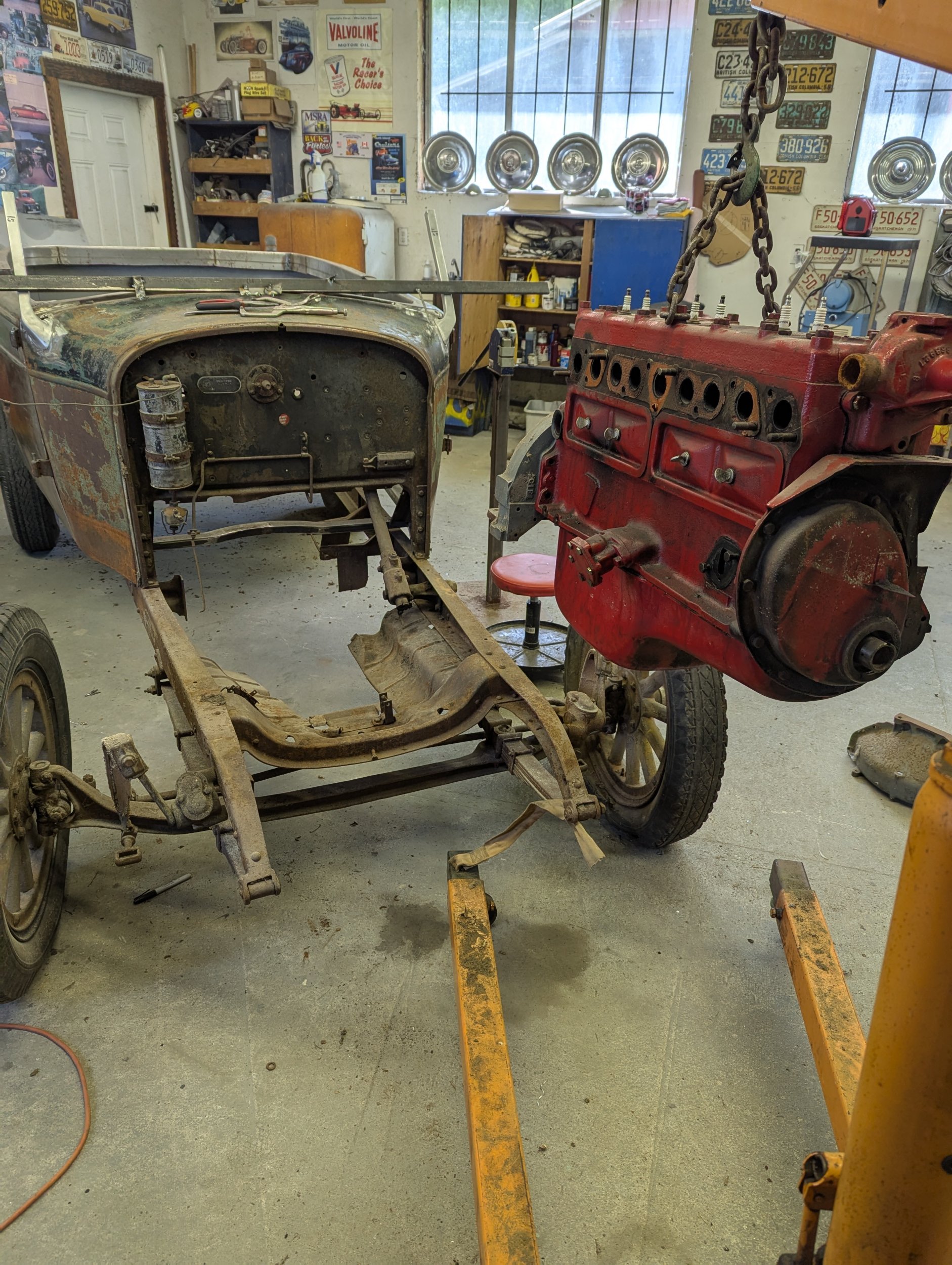

    I'm using a truck bell housing and front engine mount. The benefits of using the truck bell housing is it makes pedal attachment easy and includes ears for mounting to the frame. I'm trying to use stock parts and make it look like the drivetrain grew there.
    Here's the first problem. The six is quite a bit longer than the original 4 banger so to get it to sit it to fit behind the radiator without adding length to the hood it has to sit further back than I originally designed the floor braces for. But the best part of working with metal is you can chop it out and weld it back in differently.
    :D
    Front motor mounts were a pretty simple fabrication.
    Next plan is for the rear motor mounts then start patching the floor supports. Thank for looking. Stay tuned.
