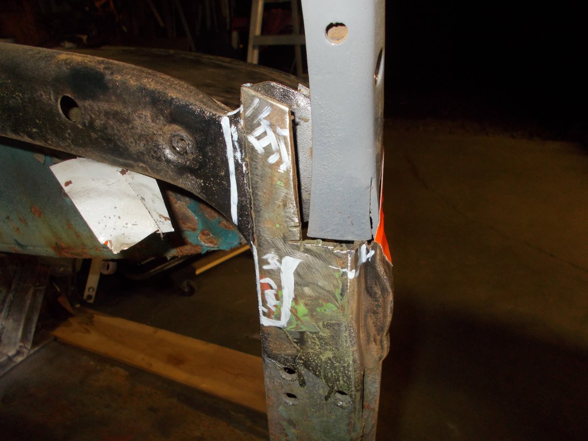

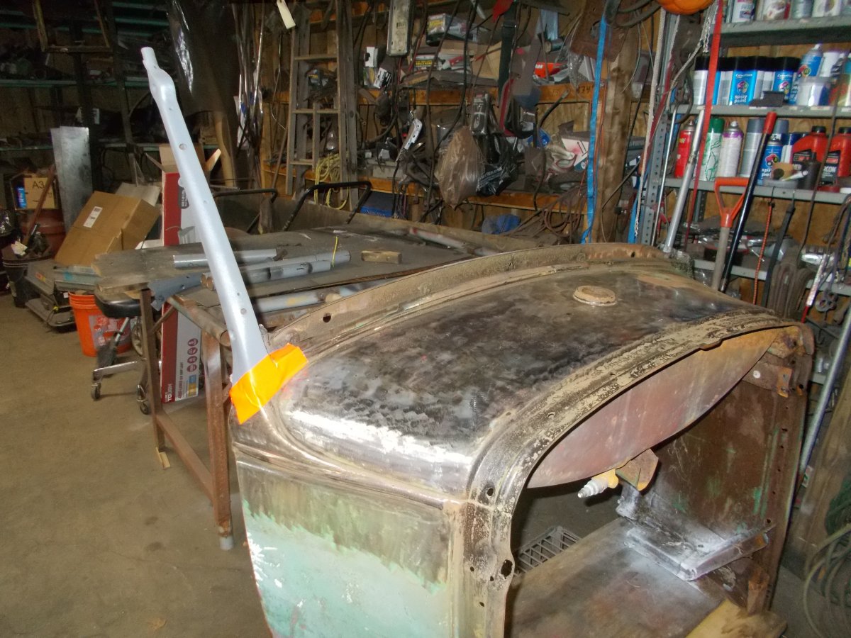

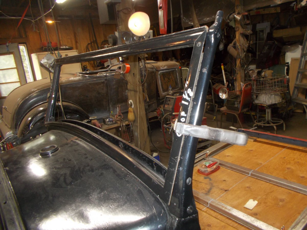

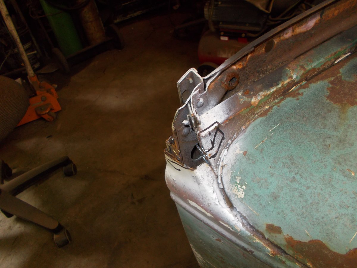

    I have a 1930 cut down closed car cowl...
    traded stuff to get a pair of '28 roadster stanchions...
    DSCN3290.JPG .

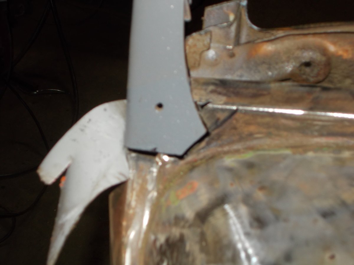

    trimmed the stanchion's rear edge to match the '30 A pillar...
    28 on 30 cowl 1.JPG .

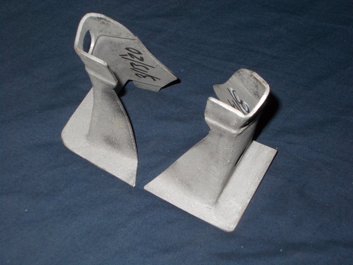

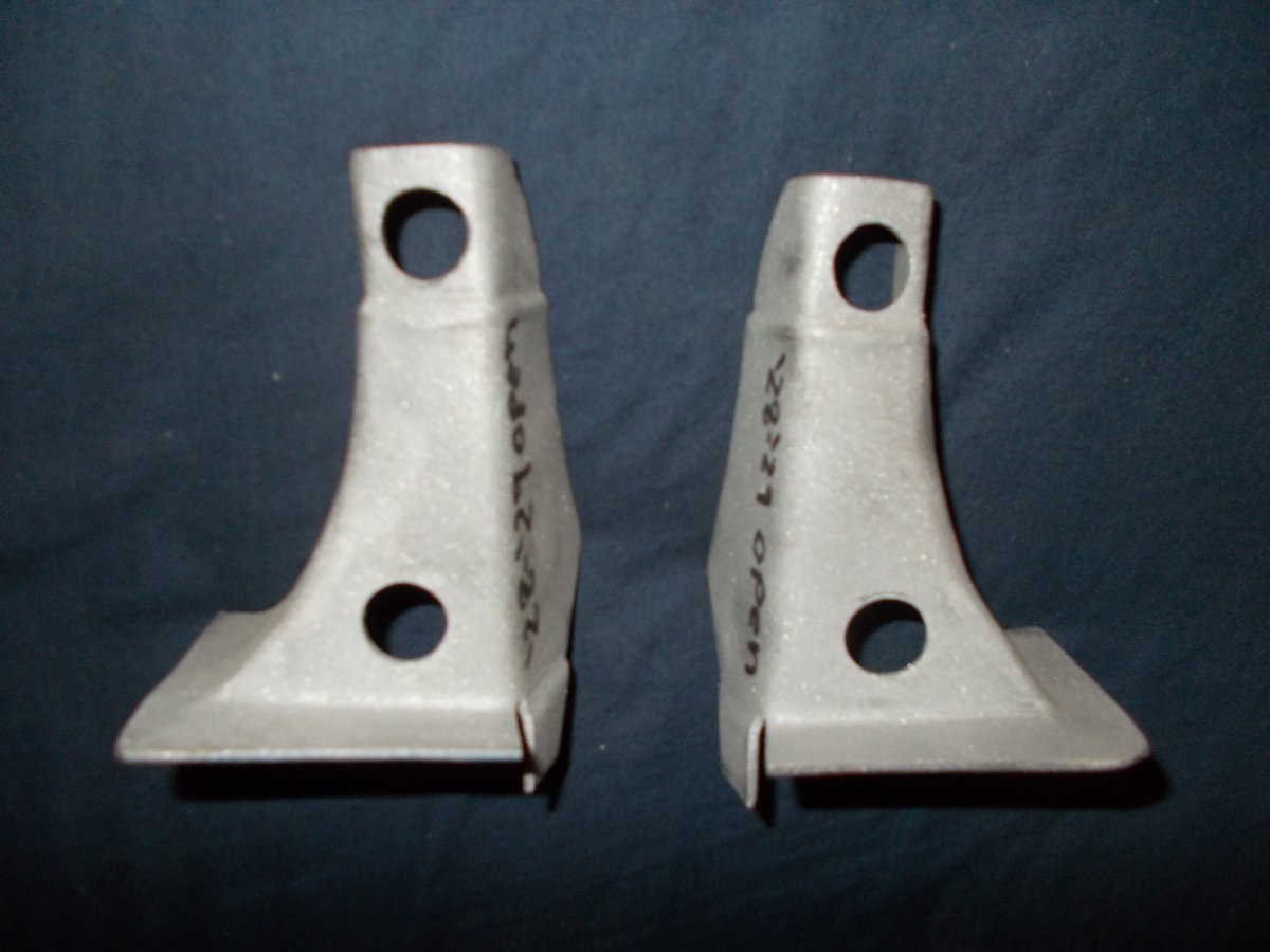

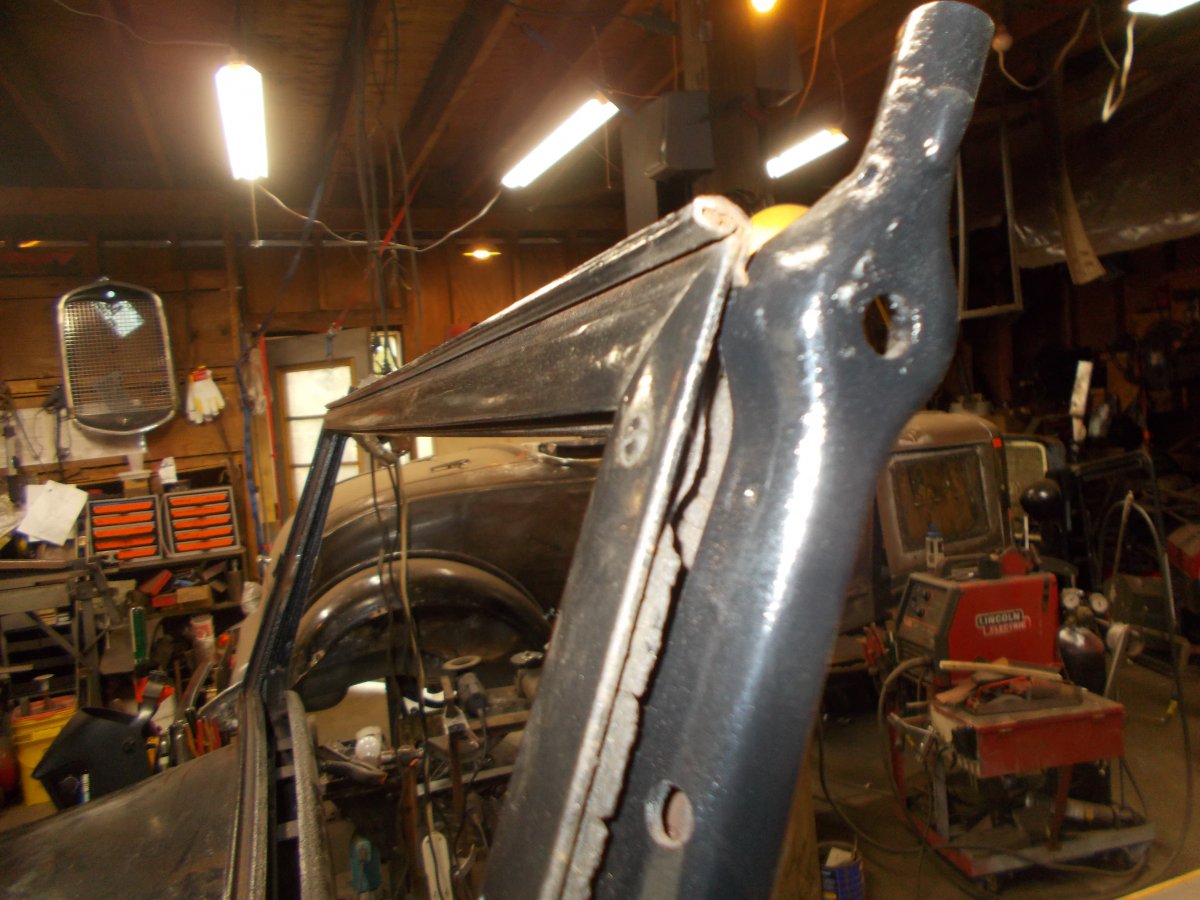

    bought a pair of '28-'29 open car stanchion mounts [ears] … [hamber, thanks]...
    DSCN5618.JPG DSCN5615.JPG .
    need to trim the new posts and the '30 posts to match... more pix later...
    DSCN4402.JPG .

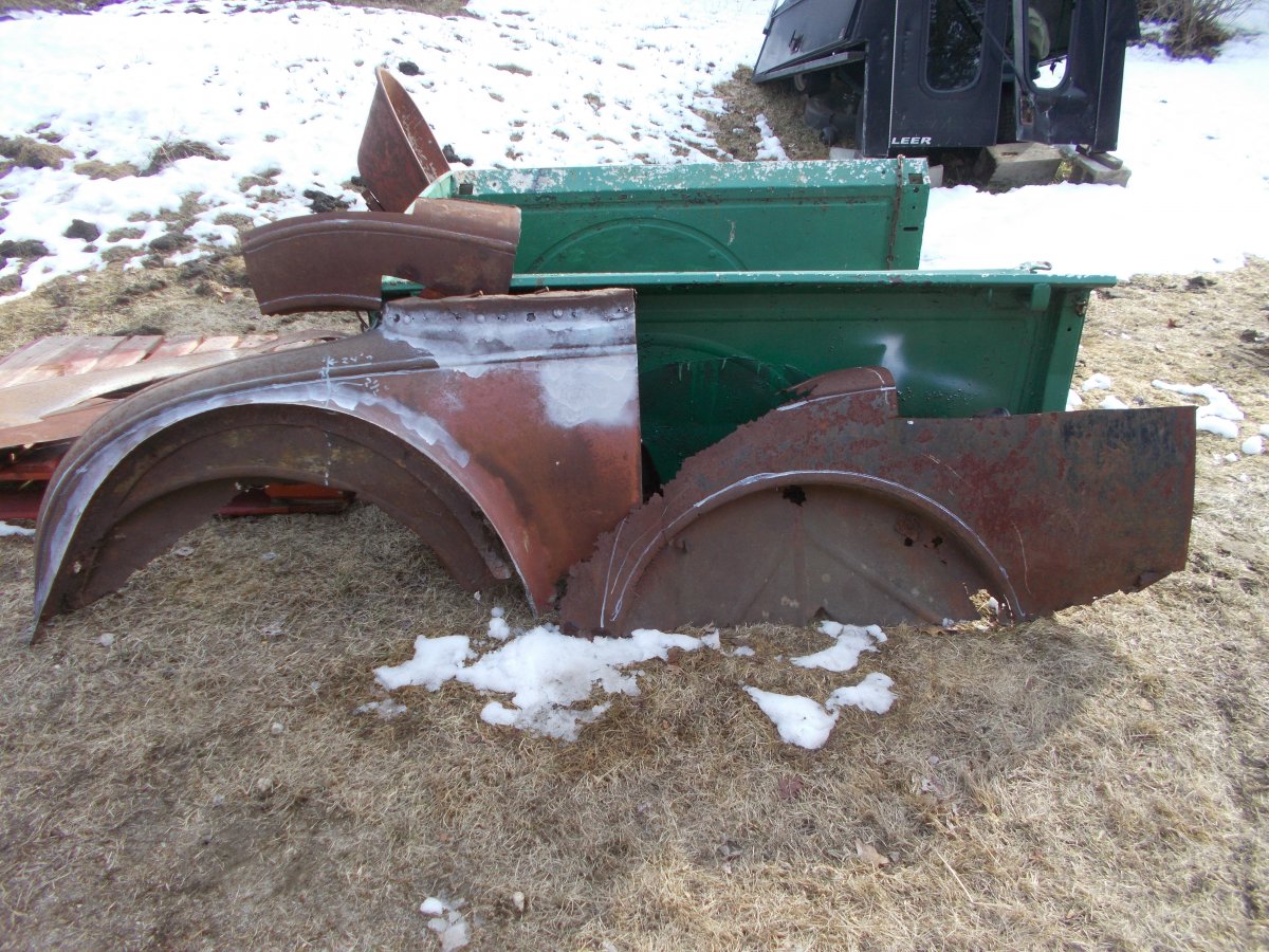

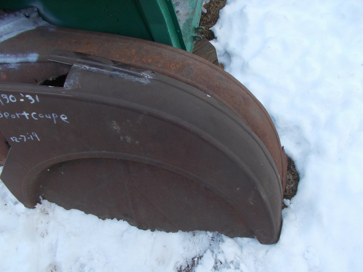

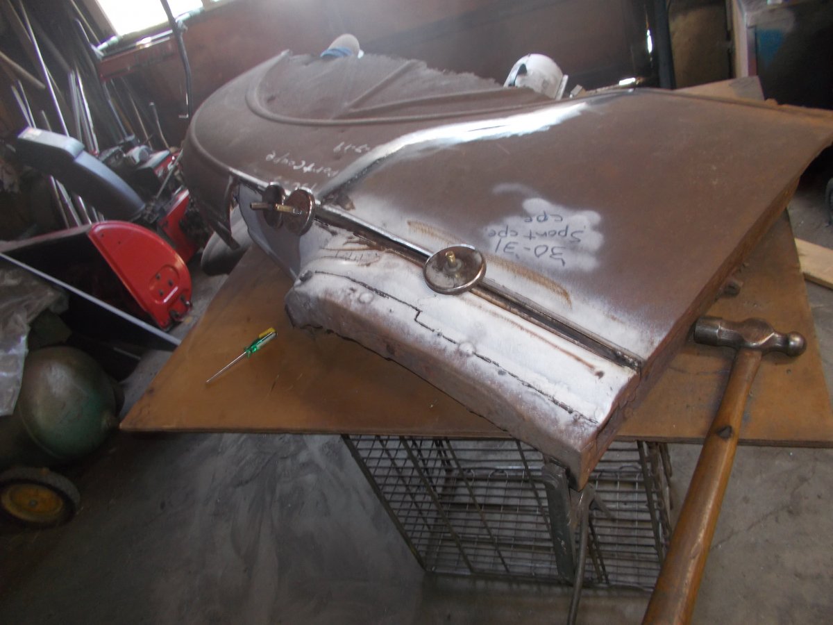

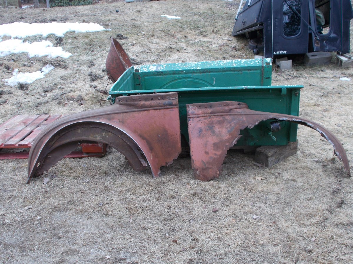

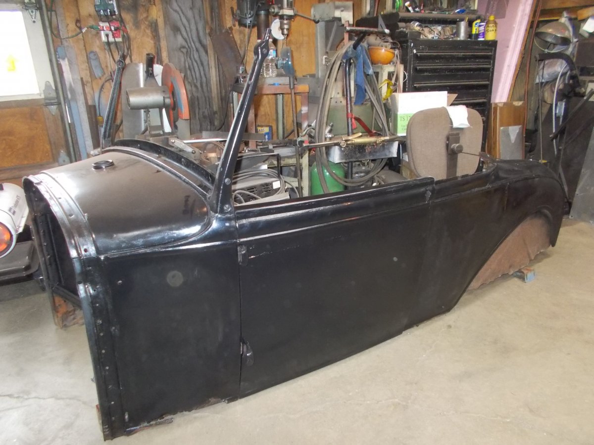

    Got a pair of '30 coupe doors,
    decklid, the '30 cowl....
    just picked up a matching tulip...

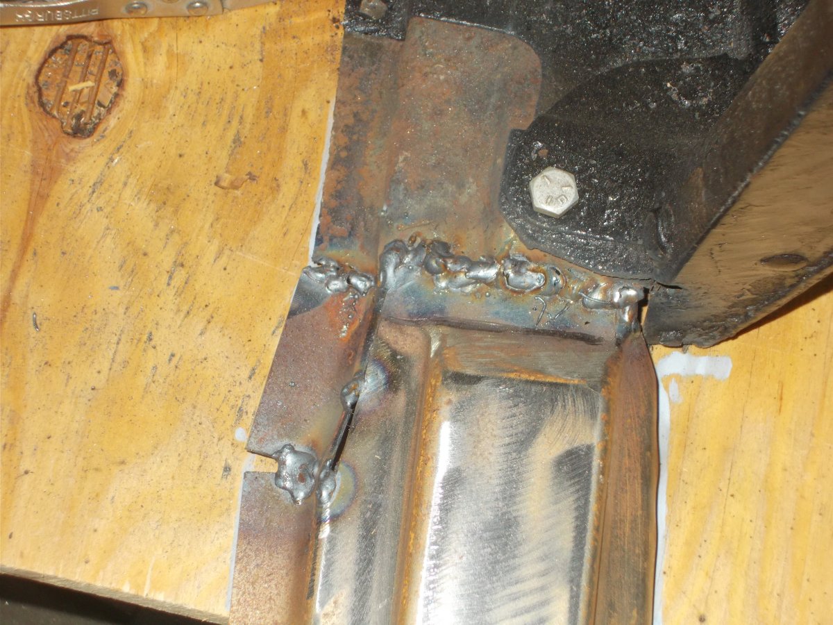

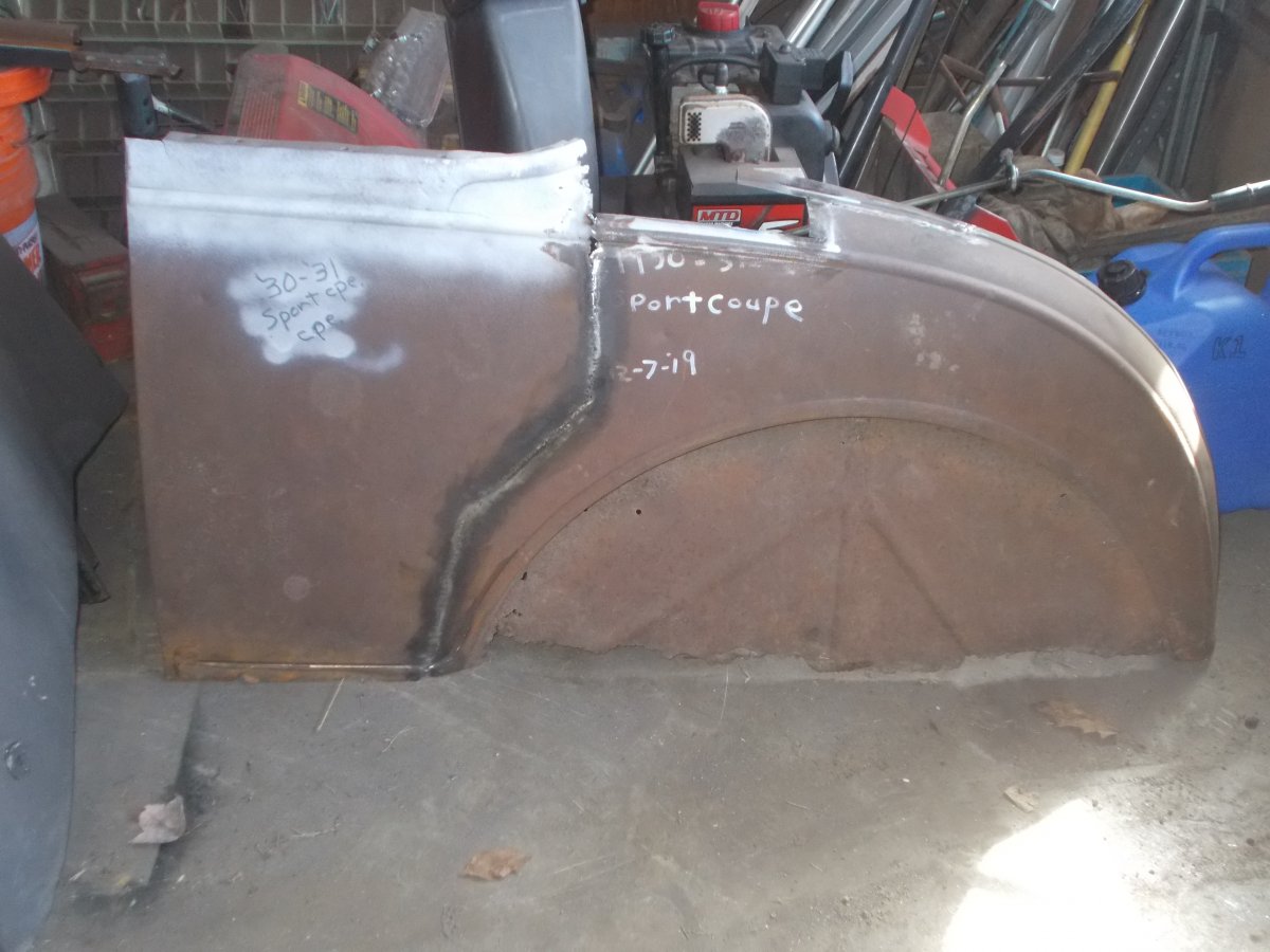

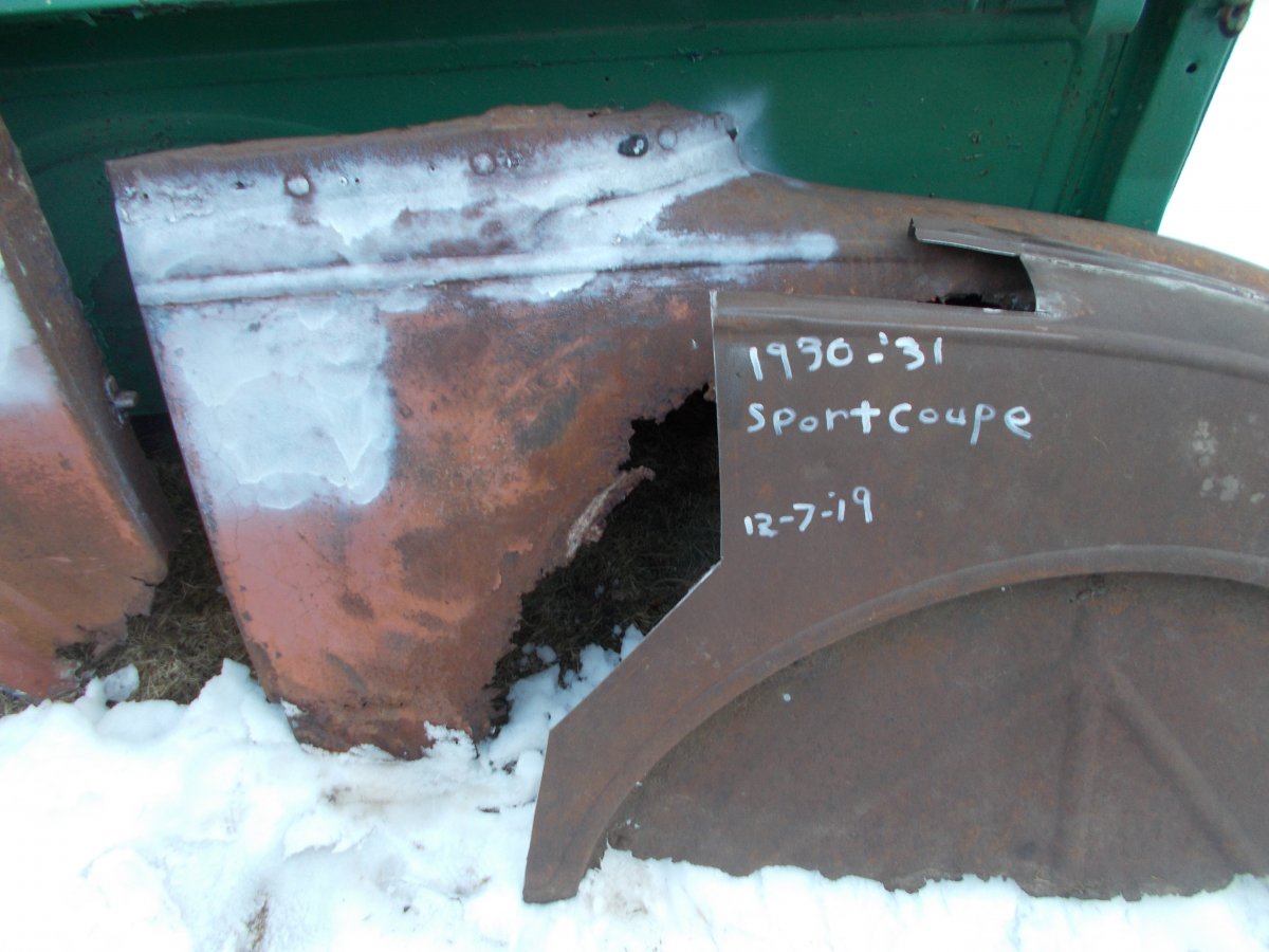

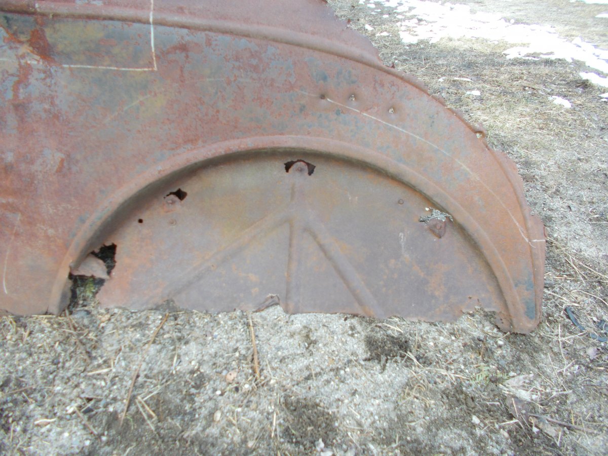

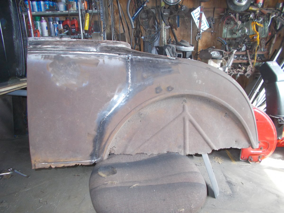

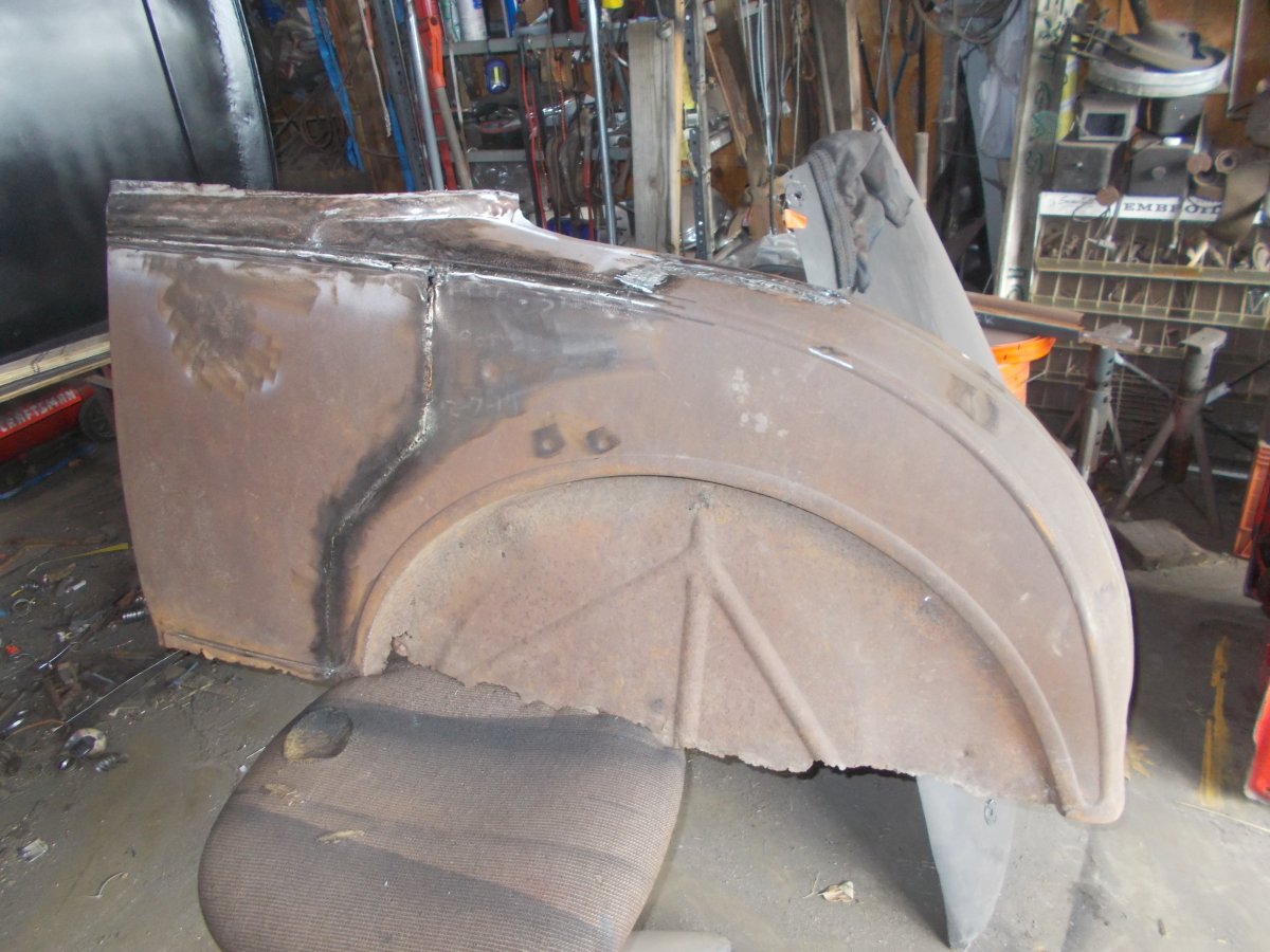

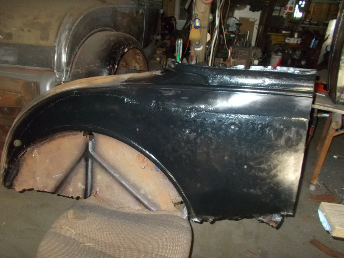

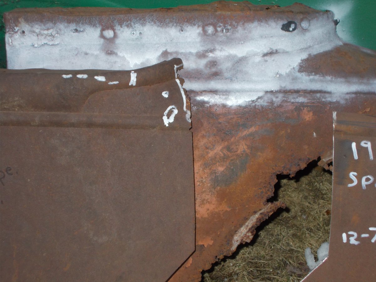

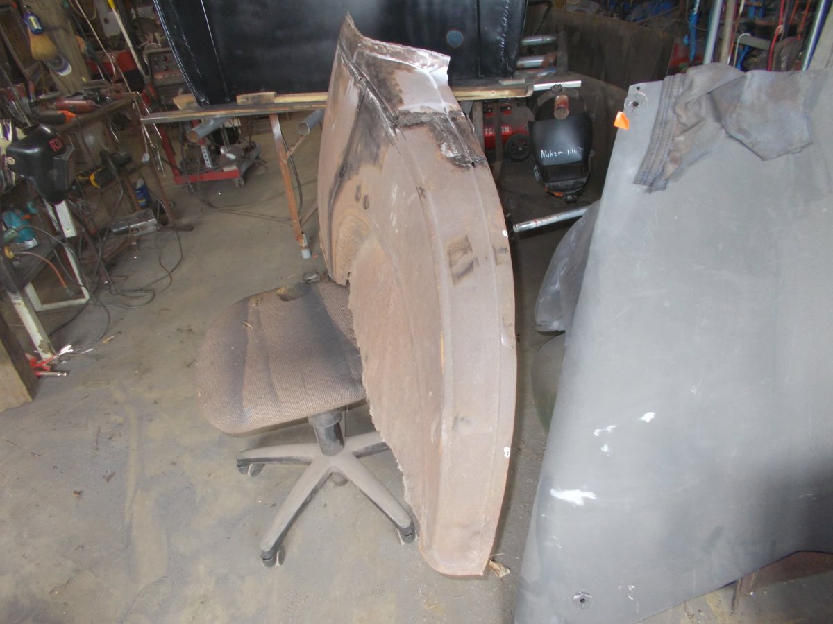

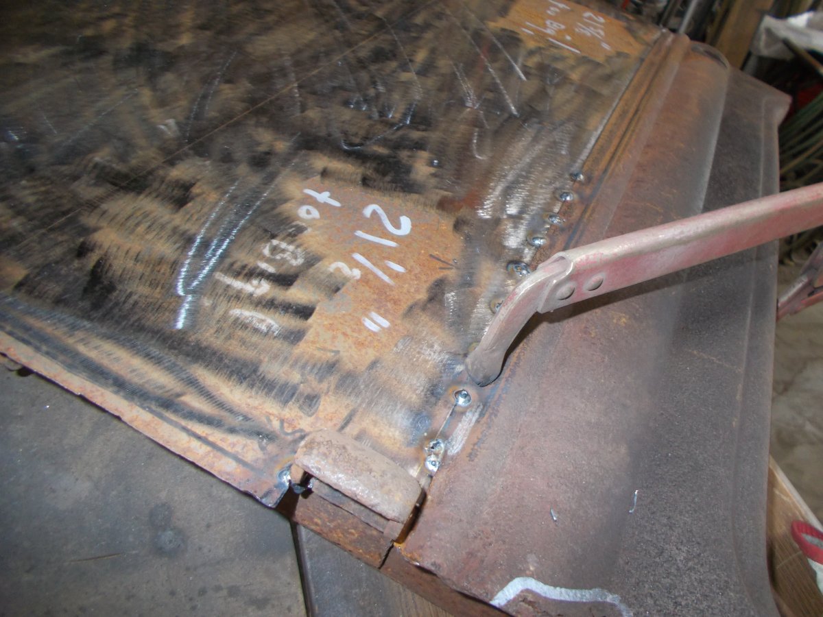

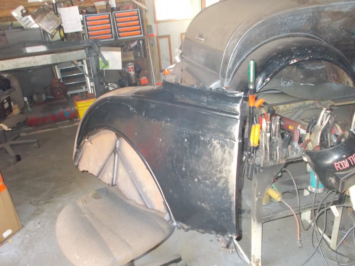

    Where the kahuna wants us to stay at home, I took 2 quarters and made 1...
    needs a little patching and dinging...

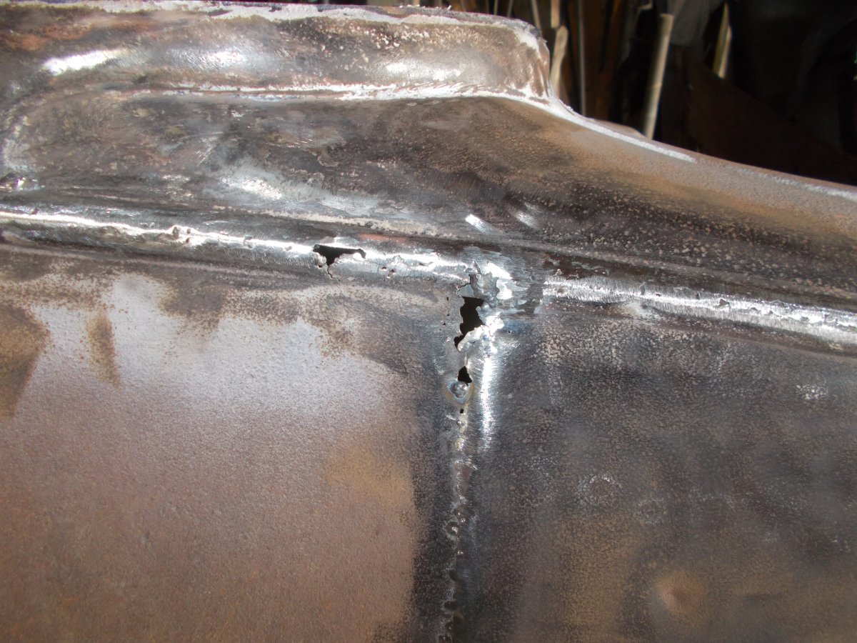

    split both quarters down the small beltline... beltline metal doesn't worp much...
    welded thin strips to the back... welded the skin front and back... looks shiddy but the extra steel won't let me grind it down to razor blades...
    needs a patch where the leftover quarter was rusted through...
    welded the quarter I had gotten to repair the left quarter of the "sportster" back together...
    used the leftover quarter to repair the next project's quarter...
    At $150 for the pair of quarters, [thanks KB] I am happy with this side, good enough for a hotrod...

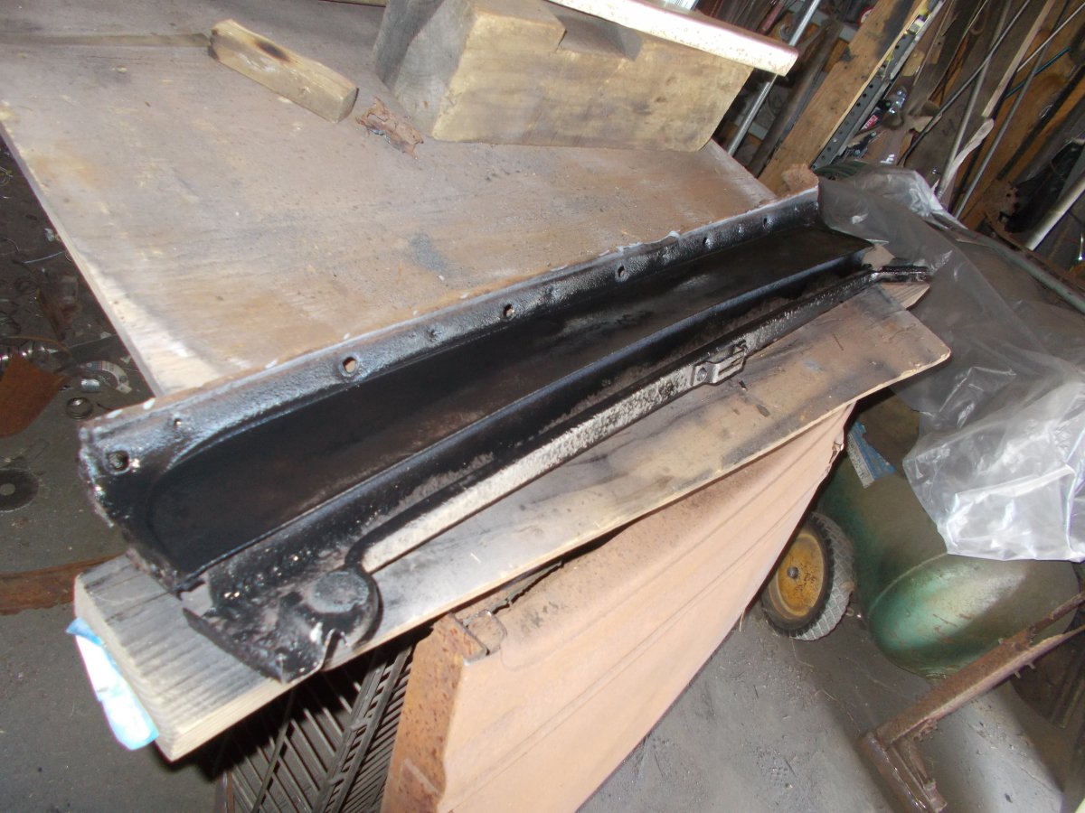

    left '30 coupe door cap tomorrow... well... no.
    I have a pair of the armrest sections cut off '30 coupe, sportie, fordor or cabbie doors...
    and another pair off a '31 truck or tudor... free for the shipping...
    door;
    door cap ;
    pix Thursday.

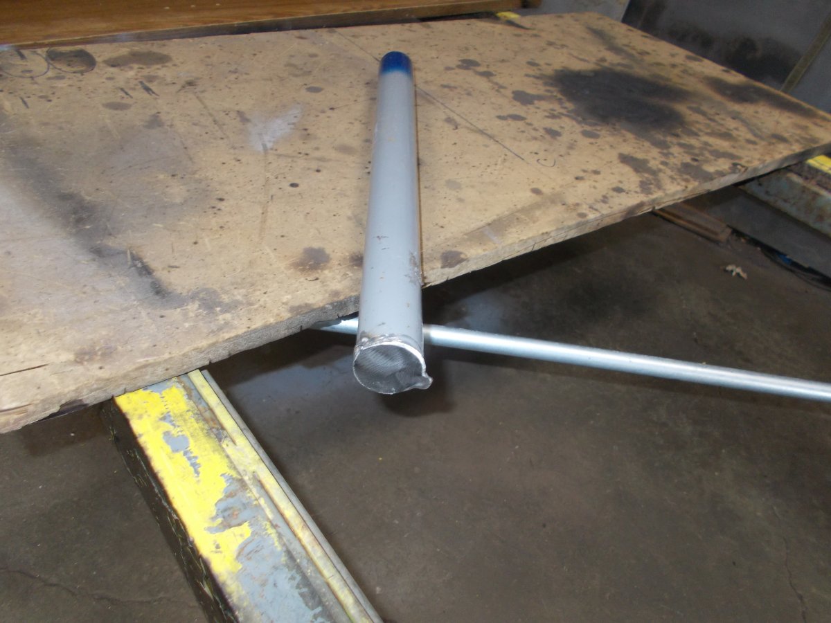

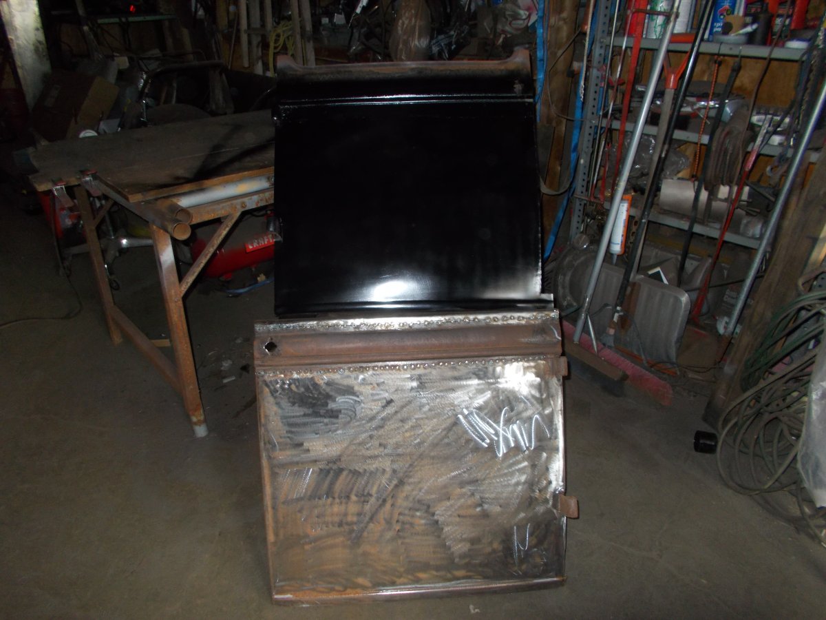

    Cleaned up half a 25 gallon drum of s**** steel from the floor, magnet on a 3' stick helps...
    set the quarters up for a before and after pic...
    ship luck... I only have 1 quarter patch... and its a rightie…

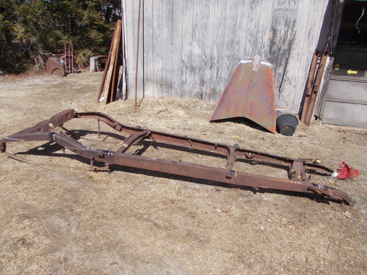

    I paid the kids next door $5 each to help me drag the '29 chebby frame within range...
    grabbed the tape measure and paint marker. plotted out the bed, cab, hood and grill... the frame kicks up about 4.5"... the model A rear crossmember sticks up 5"... no hole in the bed floor … im hoping that by t******* some cross bracing under the bed it may absorb the kick under the floor and set flat on the kicked rails...
    more ship luck... the distance between the frame rails at the front crossmember is 1/8" closer together than my '32 frame with model A crossmember... A crossmember and an A frontend may just fit...
    had a pair of model A frame horns about 5" long... just right.

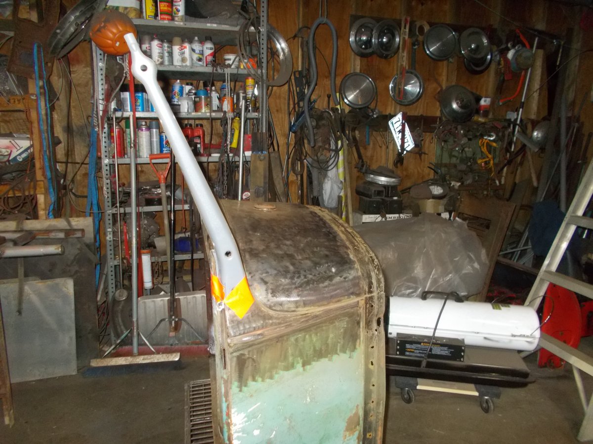

    DSCN5801.JPG Little sanding, little more t*******, seems to tilt back more than I thought it would...

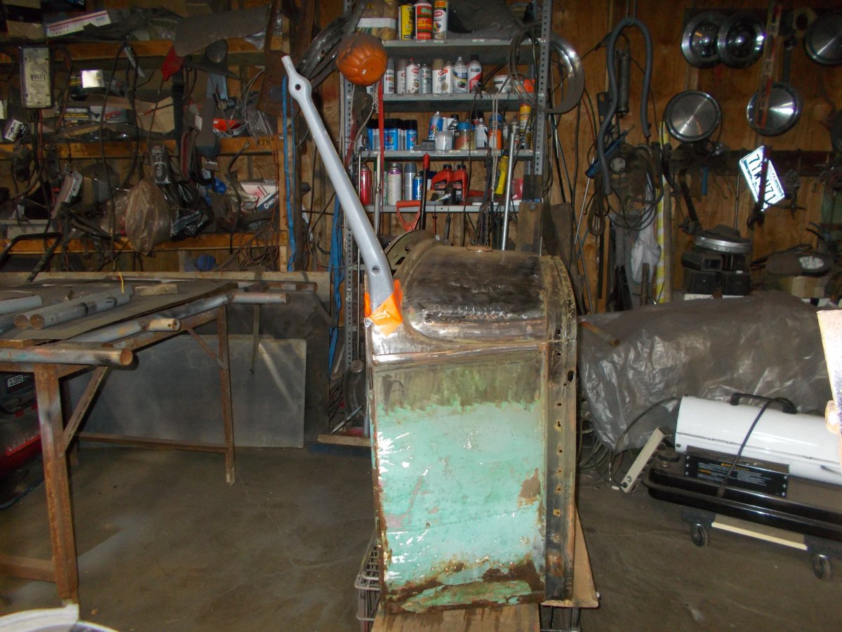

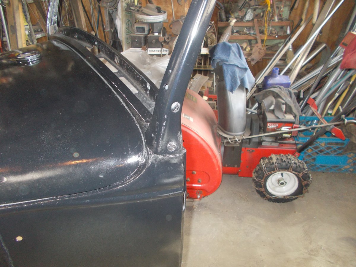

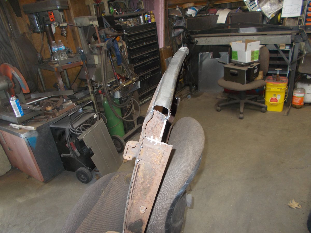

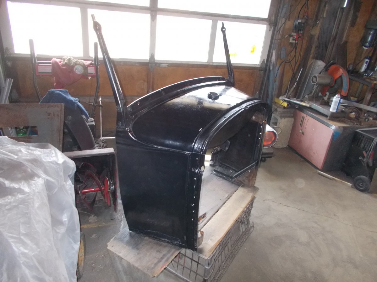

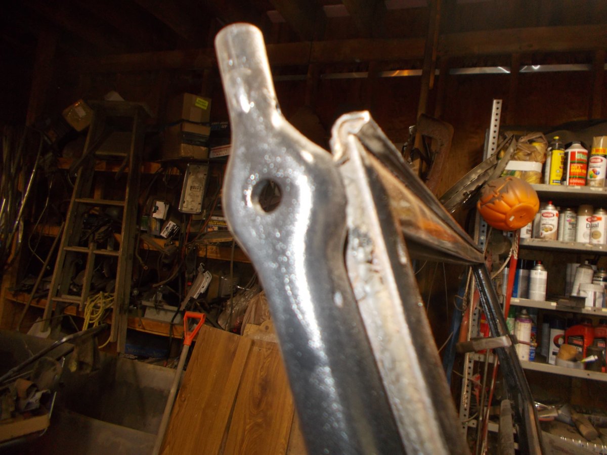

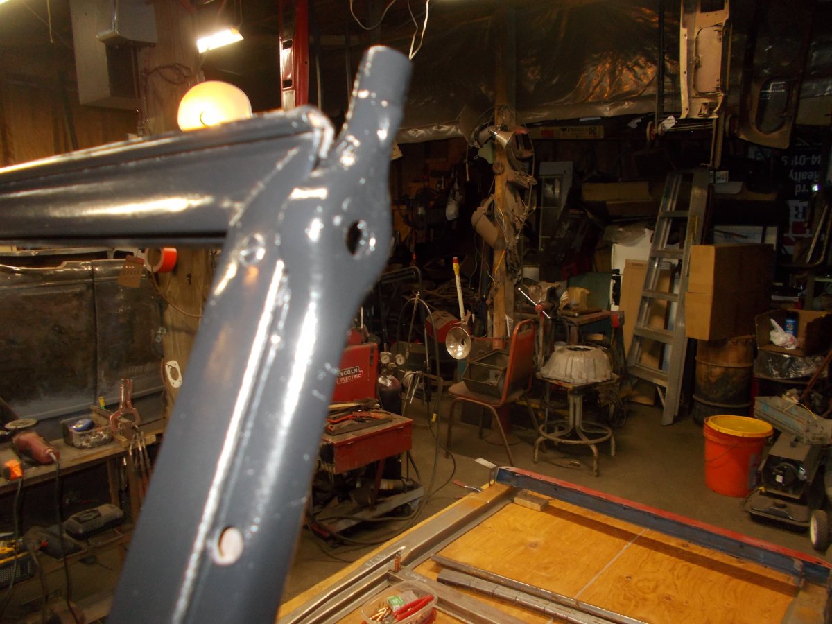

    Couldn't sleep...

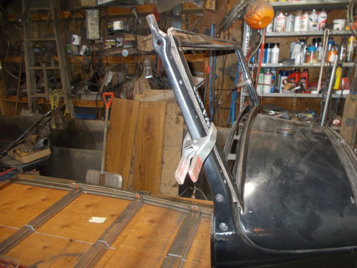

    1.30 AM went down to the garage, trimmed, fit welded the '28 stanchion brackets I got from a fellow hamber onto the '30 closed car cowl…
    needs fine welding and some careful grinding...
    funky cowl is gonna put the "ster" in coupester… DSCN5820.JPG DSCN5824.JPG DSCN5823.JPG DSCN5827.JPG

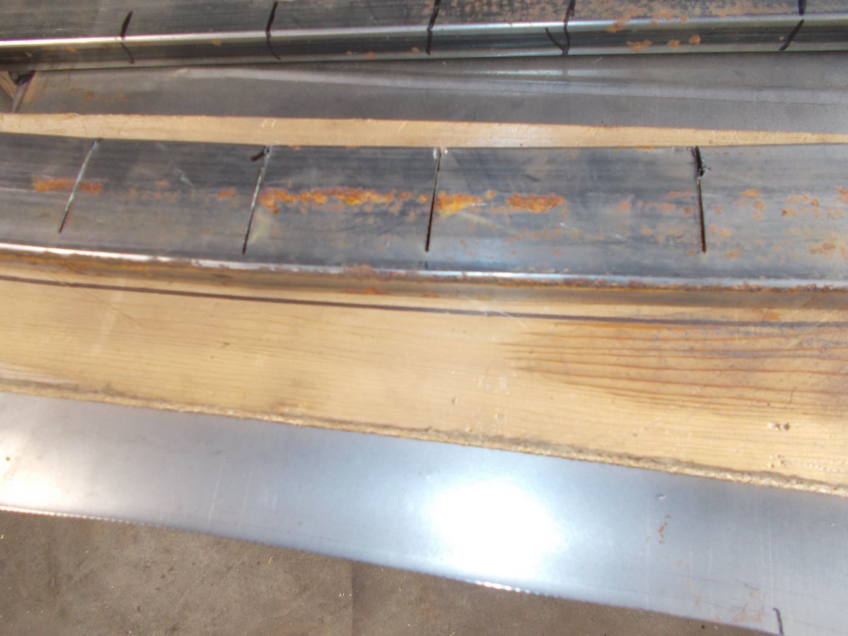

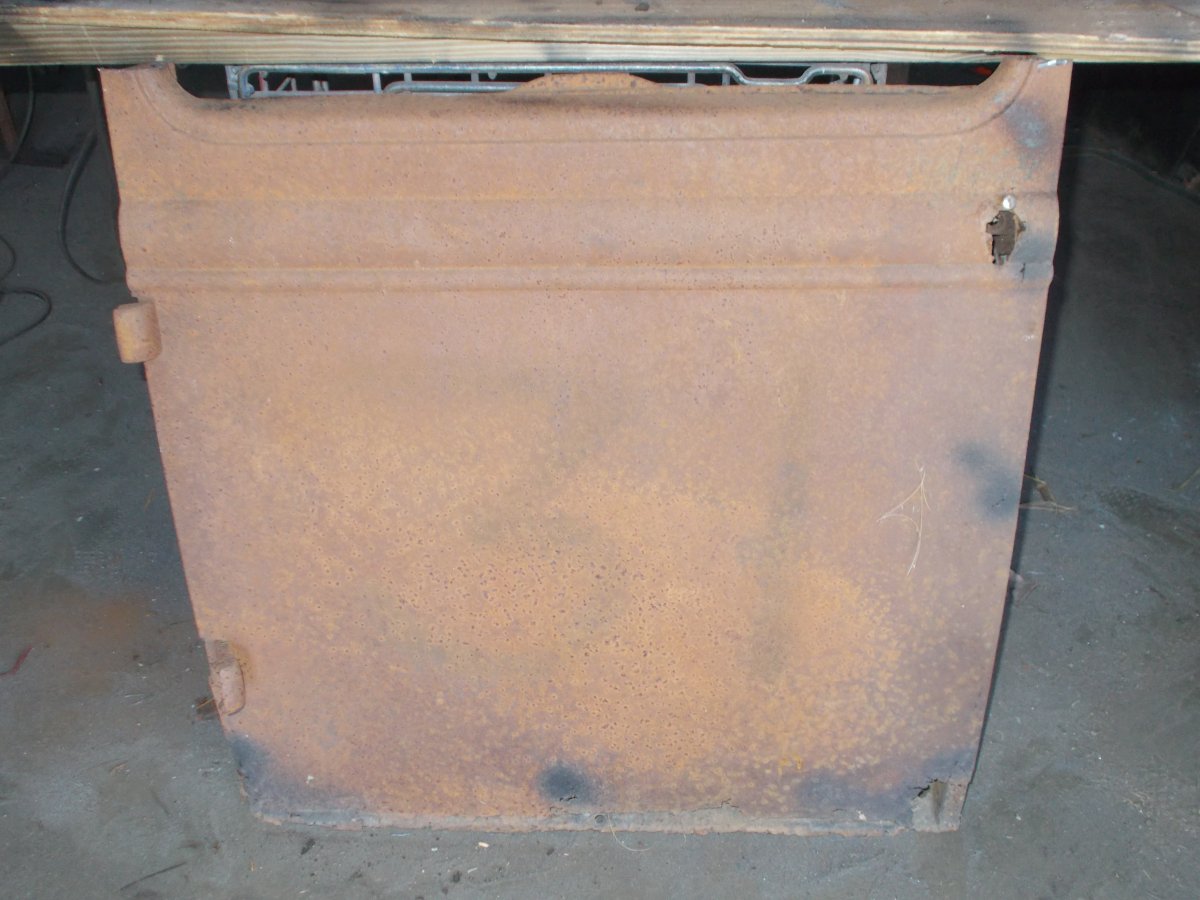

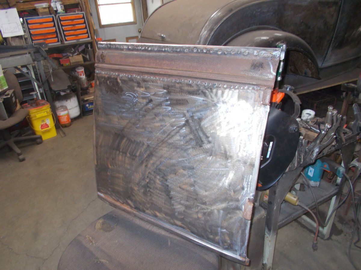

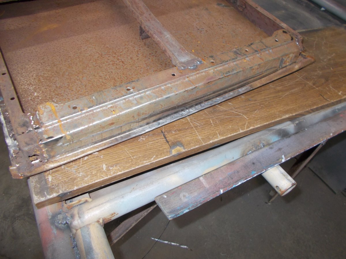

    Attacked one of my coupe doors that someone failed at putting on a MAC'S belt down door skin...
    removed it, check its size... too tall and too wide... might have been a tudor skin... flattened out his lumpy foldover… trimmed the skin to size... the rear edge is 1/8" taller than the front, measured from the bottom of the lower beltline bead down to the top of the lower reveal... R= 21 1/2" and F= 21 3/8"...
    re-aligned, checked twice, tacked, checked, nuked it on...
    I miss those "mistakes" that used to show up at a swap meet for the "get it out of my sight" price !
    DSCN5828.JPG DSCN5829.JPG DSCN5830.JPG DSCN5831.JPG DSCN5832.JPG DSCN5833.JPG DSCN5834.JPG

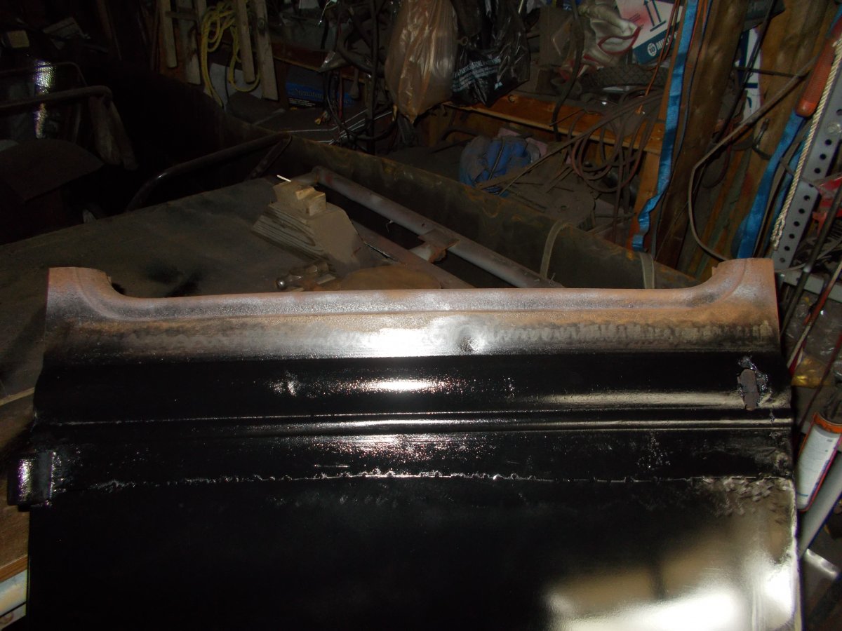

    Grabbed one of the door caps that "spanky" hammerforms for me...
    marked, checked, cut, filed, tacked, checked, nuked the cap onto the re-re-skinned door...
    going to trim the A and B jams to take the upside down garnish mld…
    Took me about 3 hours but I have a usable coupester door for maybe $75 with the cap...

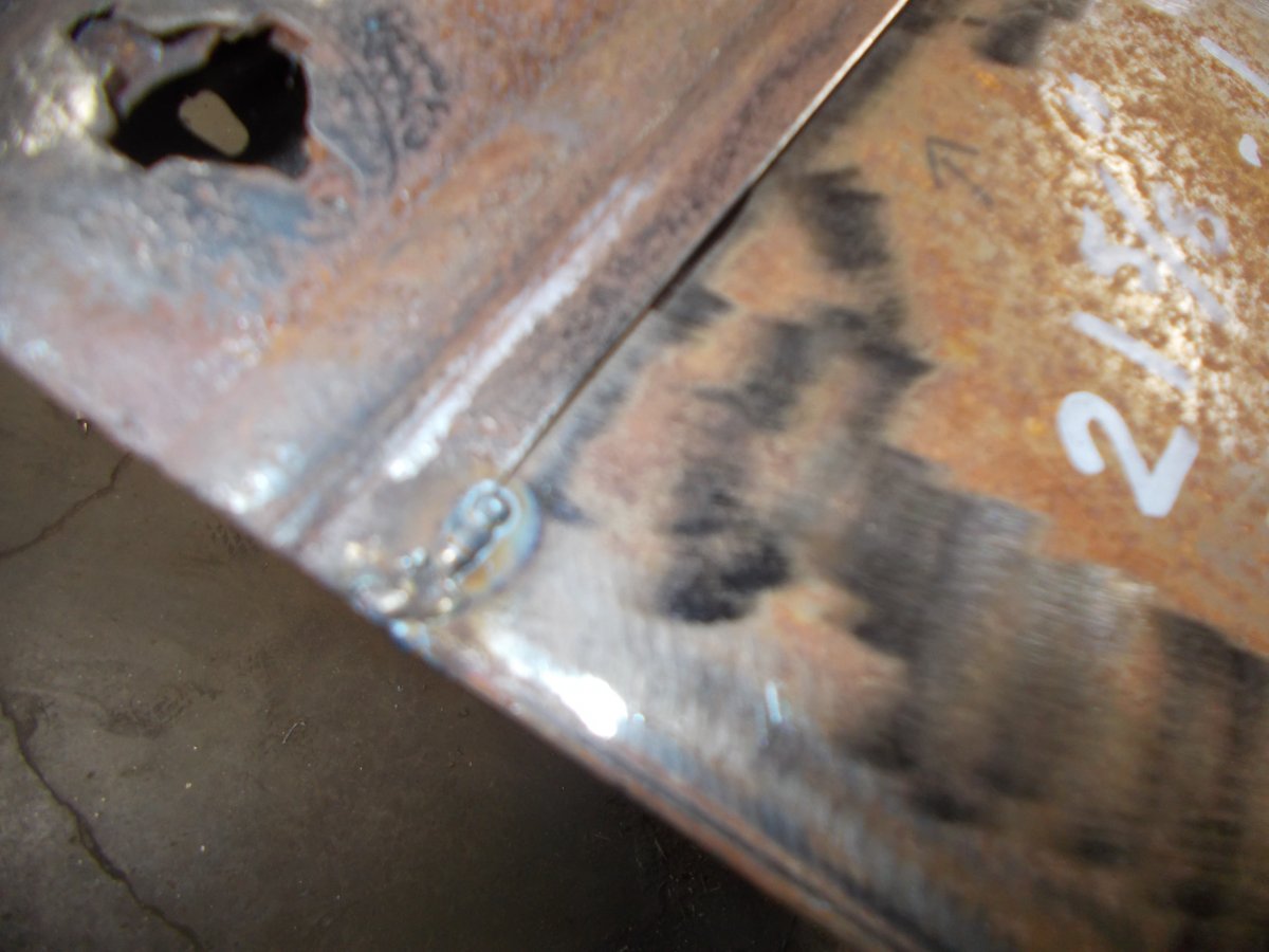

    Grabbed the left door saftanoon, had a new "belt down" tudor skin I didn't use...
    then I fit, trimmed, measured, tacked, and re-checked...
    welded across the skin, folded the hinge edge of the door skin over...
    on the latch edge i cut the extra length off...
    welded about half of the "on end" weld needed to join the old overlap, the inner structure and the new skin... later I will grind the high spots, and fine tune the welded edge with a 3" belt sander...

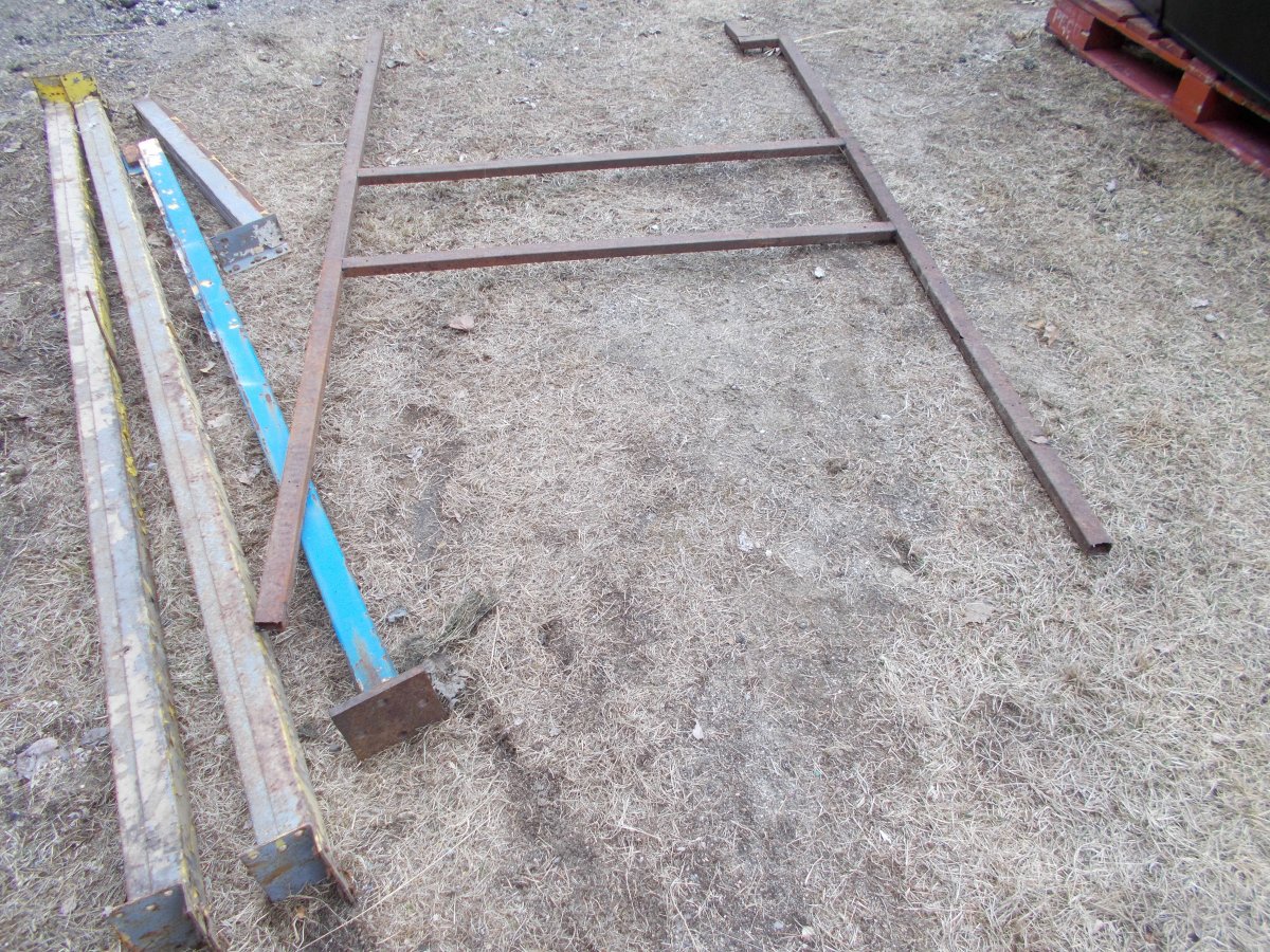

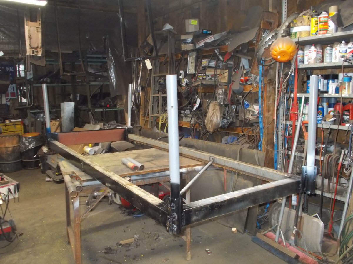

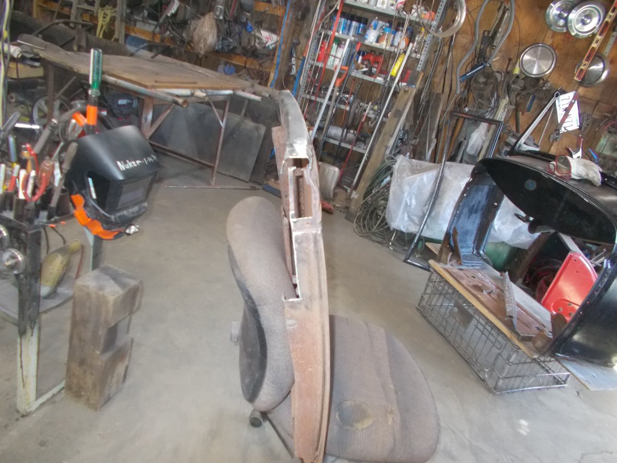

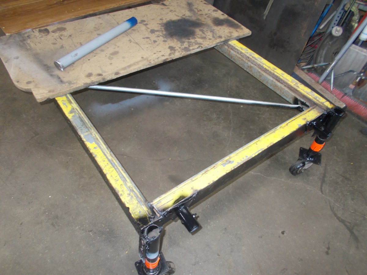

    Had a dozen thrown away barrel rack cross rails from my years at GE... 8'x 4"x 3" …
    2 of them and the cut up frame work from a crashed Winabego as cross braces...
    8' long by 38" wide either about 10" or about 25" stance...
    Going to weld up another build table as I don't think I can sell the bodies for awhile...

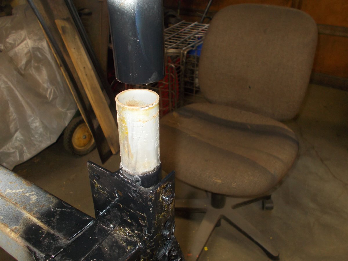

    I like to use junk 1.5" steel tube from colapsed canvas garages as the tubes slide inside of each other letting me make easily changed different length legs...
    Welded up this table... the stepped legs are 6" long, welded to the framework and the 1.5" pipe slides over them...
    the legs on it now keep the table at 25"... will make [4] 6" legs [pic] for when I want to work on a roof or door tops... they will have skids welded to the bottoms so I can slide the thing outside...
    going to make a pair of 36" long 1.5" pipes and legs to support them that bolt onto the front cross brace of the table... these will support the grill and hood if and when I need them, and I won't have to walk around them as if I had welded them on...
    have some heavy duty dolly wheels... hmmm. removable dolly wheels under the table...

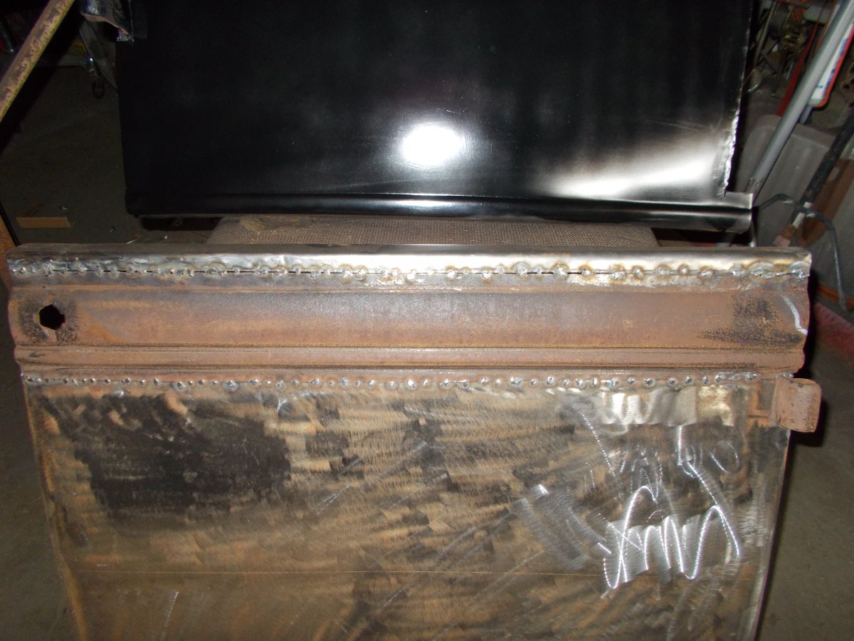

    Left door re-skinned and capped...
    the 2" section of lower reveal sticking out is from the skin being a tudor…
    . I trimmed off most of the overlapped skin...
    clamped the skin, inner structure and overlapped original skin together, welded them together letting it build up about 1/8"... ground the high spots, sanded the edge down with the 3" belt sander...
    trimmed the cap's outer edge and **** welded it to the trimmed down door top...
    couple roughed out doors while "sequestered" …

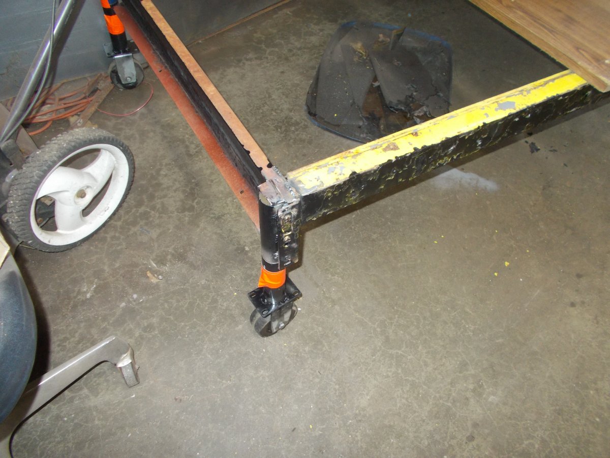

    Welded some dolly wheels onto the ends of the short legs... swivel fronts and straight backs...
    the orange tape is holding the bolts in that keeps the wheel tubes from sliding out...
    DSCN5885.JPG DSCN5884.JPG .
    welded caps on the ends of the long legs so they slide on the floor a little better...
    DSCN5883.JPG .

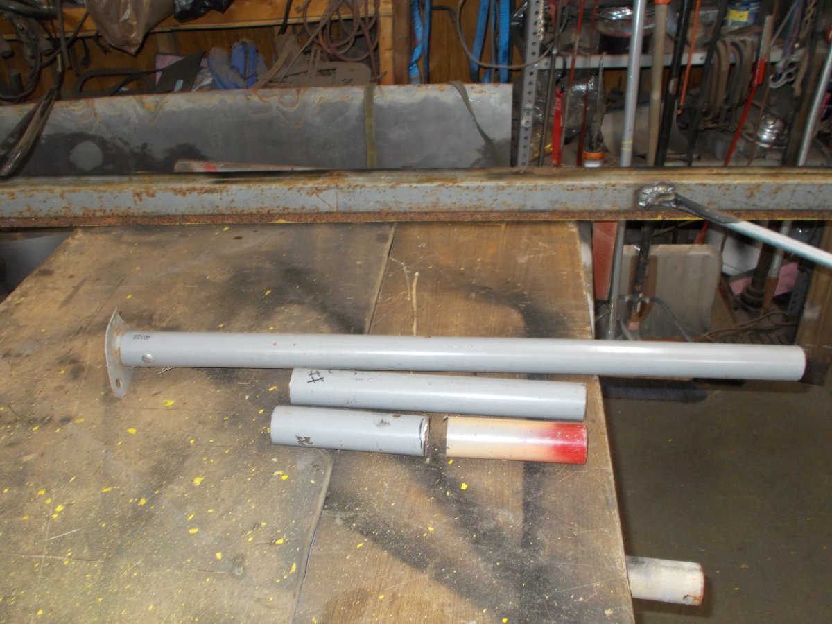

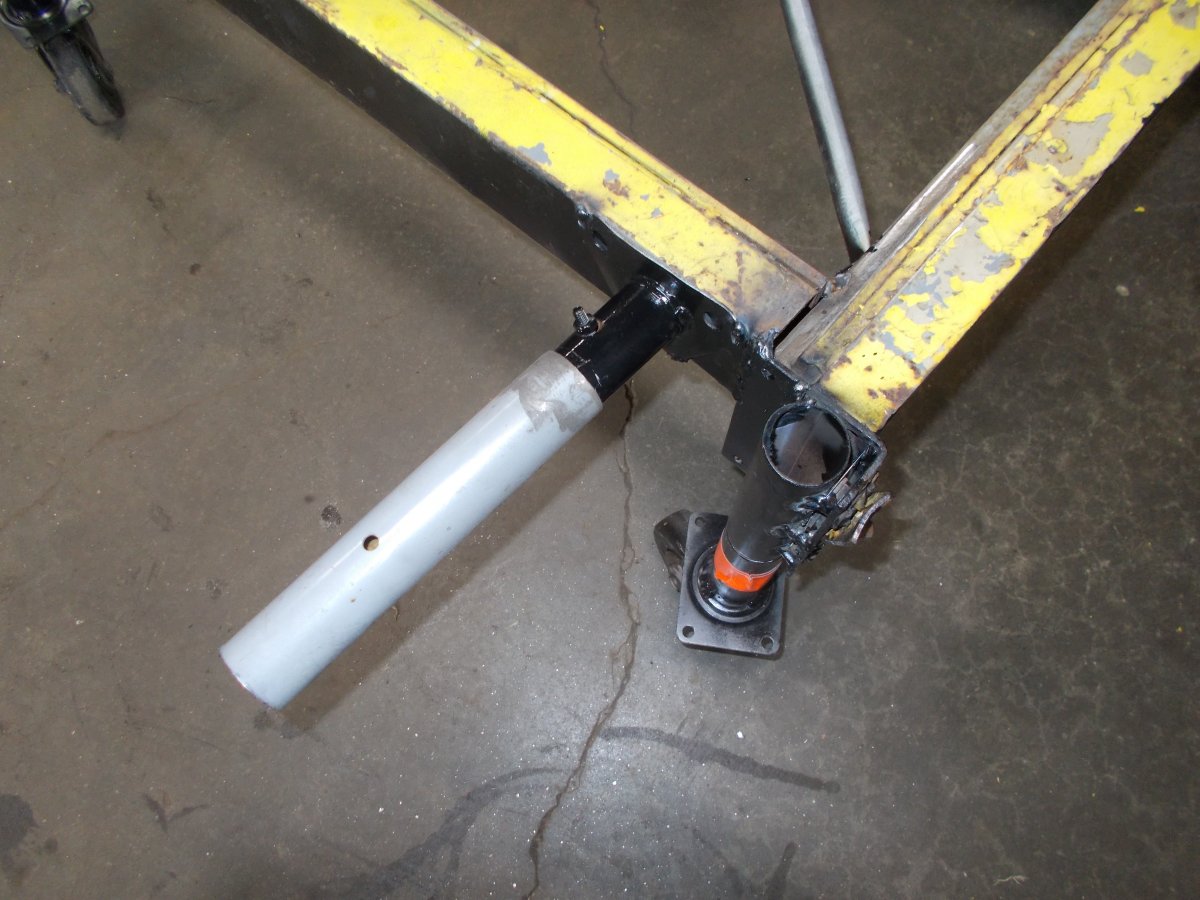

    welded 2 male tube sections onto the front crossrail… 35" long tubes will slide in and I will drop a bolt through both the male and female to secure them... they will support the grill / hoodtop…
    lower pic shows a s**** piece of tube...

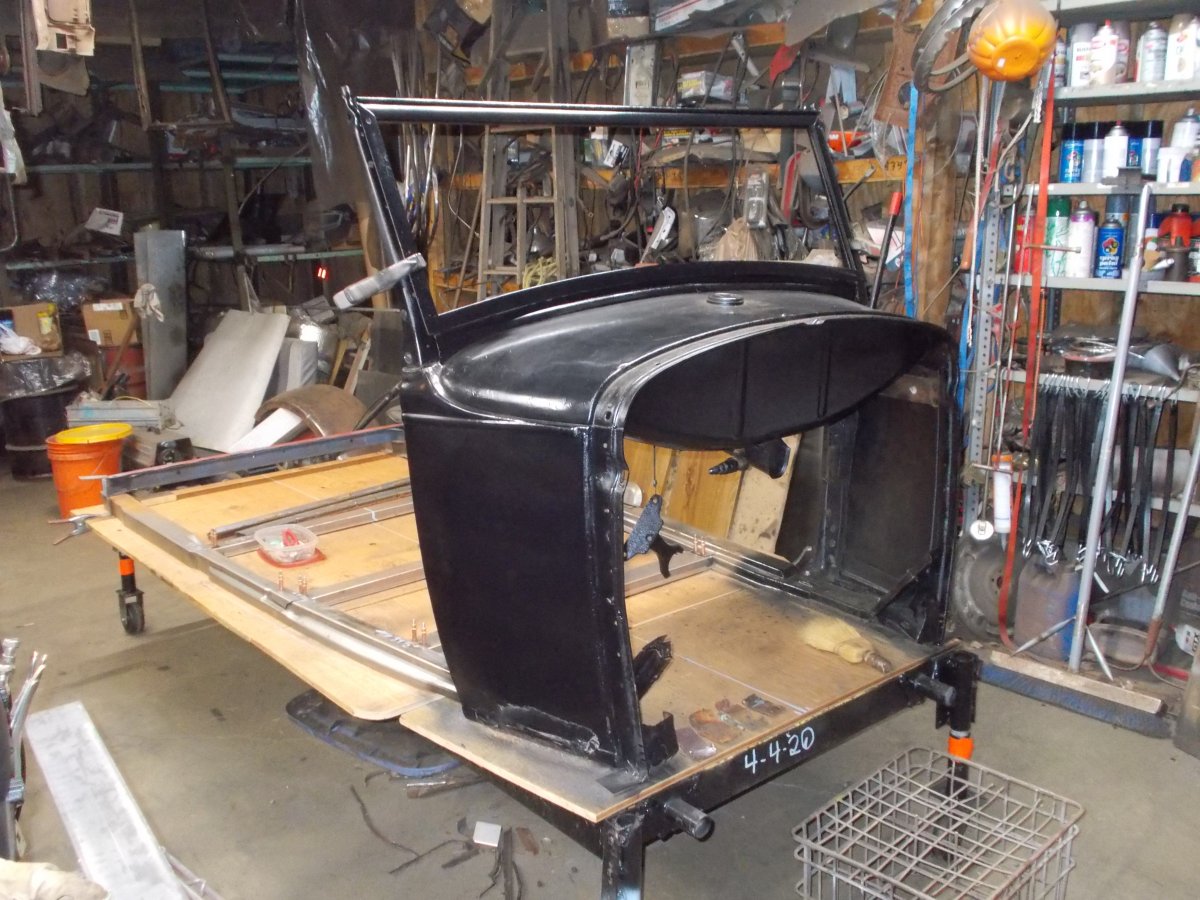

    sloppy jalopies

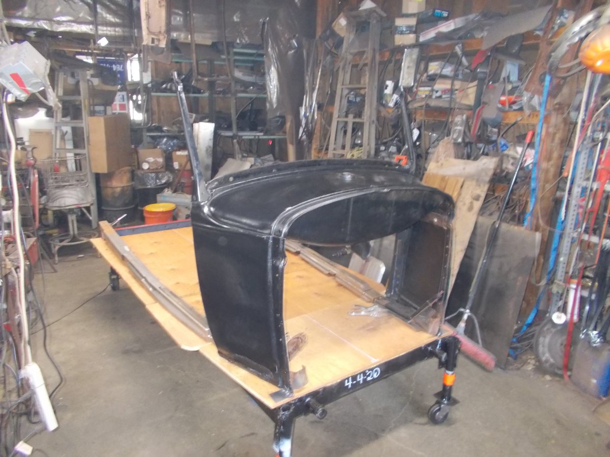

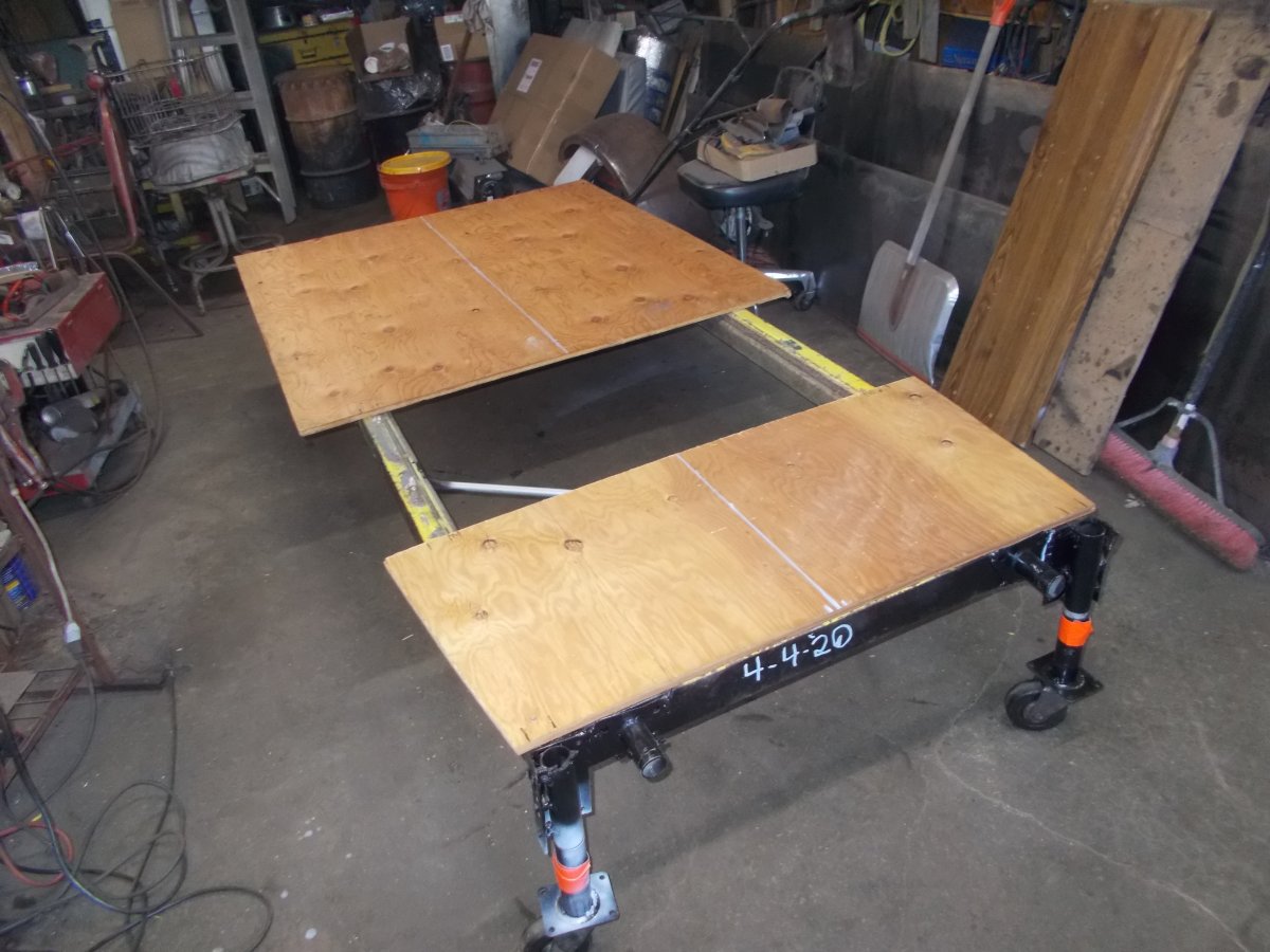

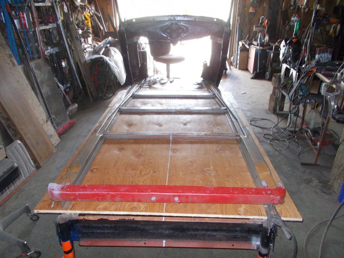

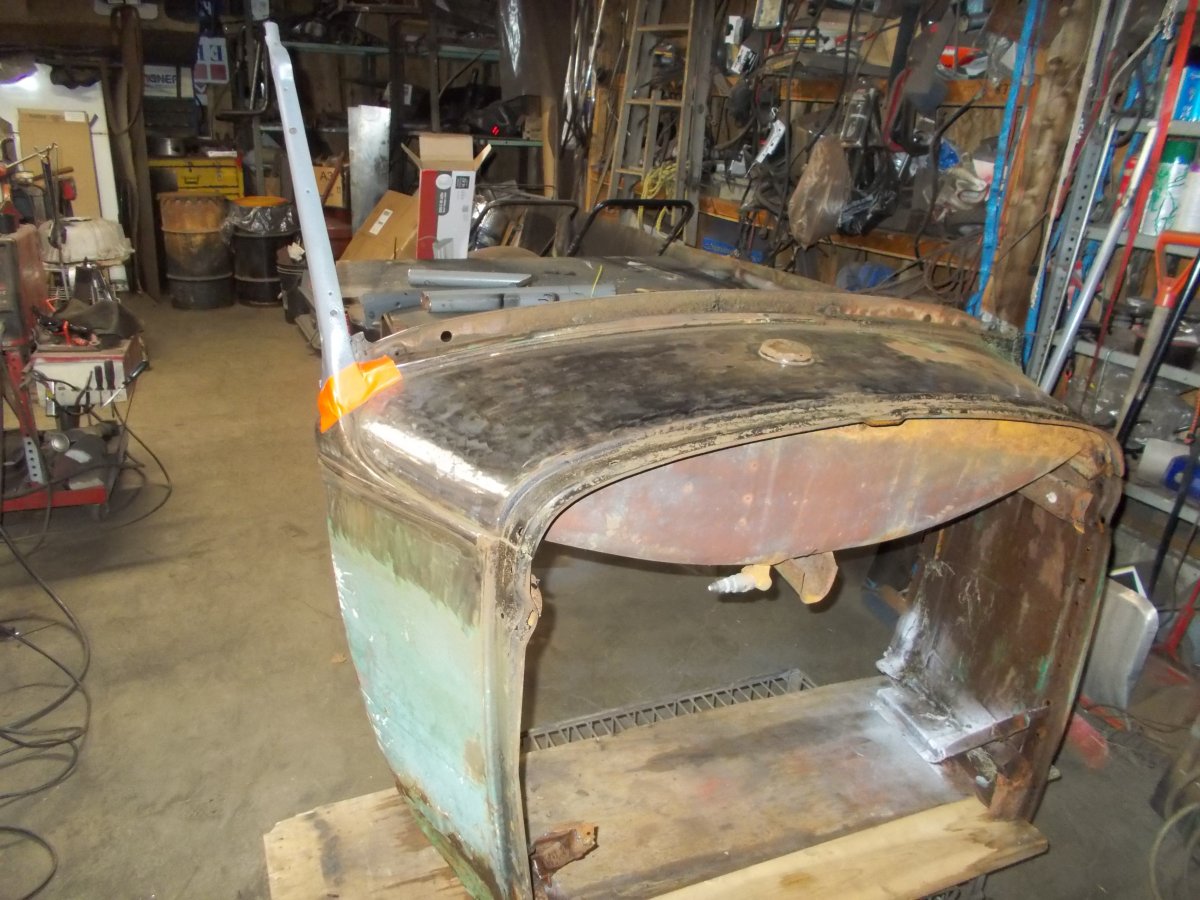

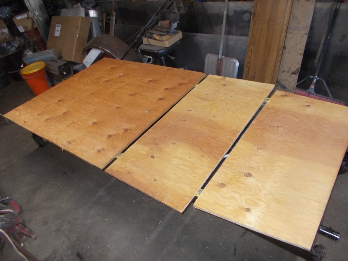

    Cut a 4'x8' sheet of 1/2" plywood into 3 pieces...
    Front 20"... A cowl is 16" and tapers wider towards the rear...
    center is 20" ... has the front corners rounded to help save my knees...and is removable so I can stand or sit inside the body if I need to...
    I drilled 1/8" holes through both the front and rear sections of plywood and the tables framework then dropped a nail in the hole so the wood doesn't shift...
    DSCN5891.JPG .

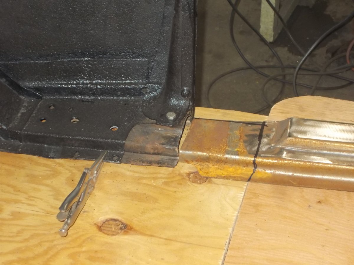

    Rear is 54"... I wanted to have the B pillar mounts and the heavy rear crossrail on the same section...
    DSCN5895.JPG .
    Cowl setting on the table...

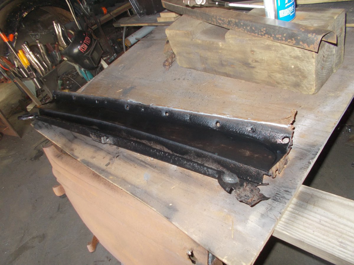

    I realize the subrails I bought 2 years ago don't fit the '30 closed car subfloor extensions... looks like a will cut and splice onto the stock subfloor ends that I stuck in the extension for the pic...
    DSCN5893.JPG 3/8" too wide and not deep/long enough [doesn't even reach the front cowl bolt hole]…
    tried [4] '30 cowls...the raised leading edge is straight across, my subrails [junk] have the raised ridge at an angle...
    any ideas ? .'28-'29 or maybe 31 slant w/s bodies ? …
    Went out to the s**** pile, they are '28-'29 tudor or coupe, open cars had areas for clamps for the sill plates... oh well cut and weld on what fits... having the wrong subfloor shouldn't affect the Nasty Nancy Coupester body's build...

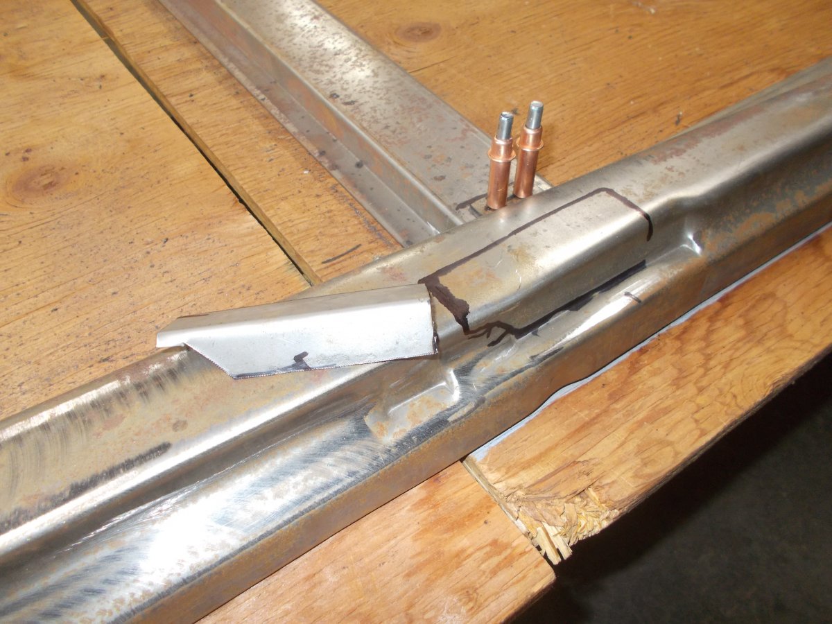

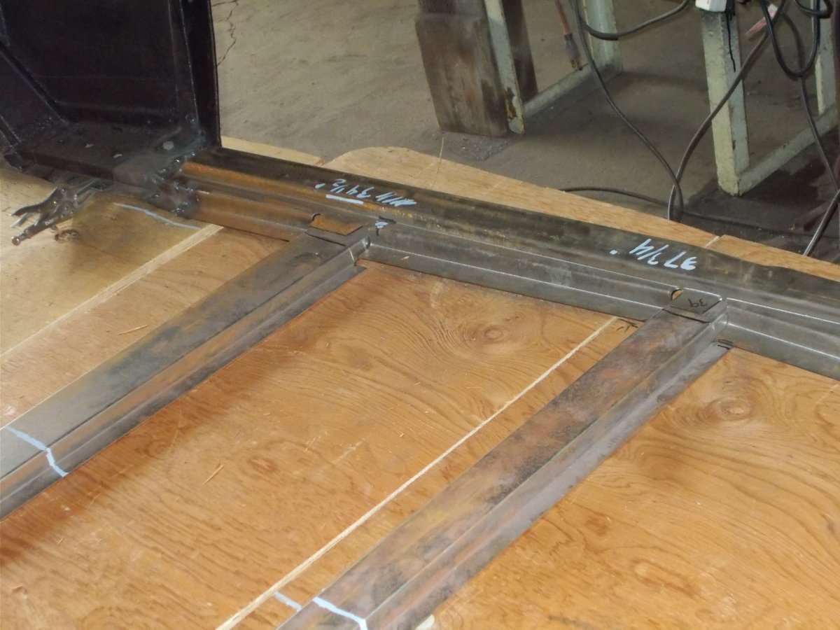

    Welded the front 7" of the '30 subrails to the cut off and narrowed '28s...
    set them under the cowl... sat the heavy rear crossrail on top of the subrails… DSCN5902.JPG
    Trimmed the 3 crossrails and slid them under the subrails…
    Careful when t******* the ends as the subrail curves top to bottom behind the door, you will have to trim the crossrail too long and bend the top down at an arch as it is riveted through the subrail...
    moved back 5 feet and cross measured from the 3rd crossrail to the rear cowl bolt
    less than 1/8" off... I weld that... ordered wooden mounting blocks today.

    Coming along great Smitty! I've got a sport coupe body in pieces I've gotta get to one of these days!
    Nick

    while the kahuna wants us to stay home I am going to make the best of it...

    Used my clekos and secured the cross rails to the subrails…
    bent up a couple 90*s, they will fit the B pillar section of the subrails… I will cleko them on so I can fine tune the B pillar when I am ready to attach the quarters...
    notice how the bottom center of the windshield frame contacts the top center of the stock under w/s panel... doesn't let the lower sides of the w/s frame pull in against the stanchions...
    also the rounded caps on the stanchions hit the top outer edges of the w/s frame...
    because I have already cut the lower rear edge of the stanchions I will trim them to let the top of the w/s pull in flush...
    going to need a slant w/s filler or under windshield panel as they are designed to deal with a tilted w/s...
    have a rusty dented one on a cowl out back...
    notice how far back the center reveal is...
    I had some 2" x 3/4" steel tube, I cut a couple 26" sections and pie cut one edge so I can copy the quarters curve...
    I traced the curve from a good door onto a strip of wood lying around, cut, bent checked went quick... DSCN5913.JPG
    Okie Pete and Nailhead A-V8 like this.
  30. sloppy jalopies
    Joined: Jun 29, 2015
    Posts: 5,256
    sloppy jalopies
    Trimmed the post's caps to clear the w/s frame... DSCN5932.JPG
    using a 1932-'34 truck w/s frame, did not cut it... I did remove the swing arm anchors so the frame would fit between the stanchions... still too tight so I trimmed off the strip that retains the gasket on the sides and bottom...
    much better...
    changed the "filler" panel to '31 Victoria...
    salvaged 1 male [cowl] hinge... need to make 2 lower and 1 center male hinge...
