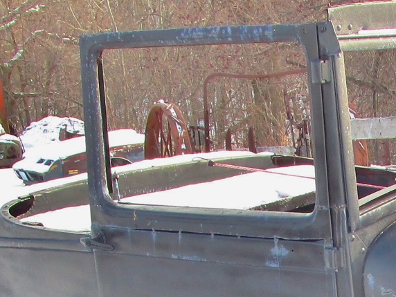

    A friend and I were looking at the coupster thread. He is wondering exactly how it is done w/o changing out the cowl. 32 stands were mentioned in one case. A or 32 windshield? custom width? He is missing everything from the belt line up on his 29 and a prior owner cut the door window frames off then tacked them back on. Anyone? IMG_14.jpg

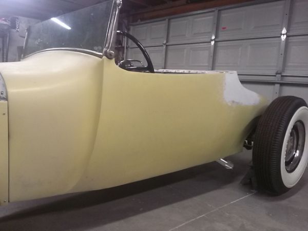

    This is how I did mine, 31 Model A Stancions & windshield. Home made mounts on the cowl.
    falcongeorge likes this.
