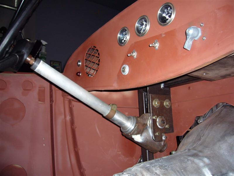

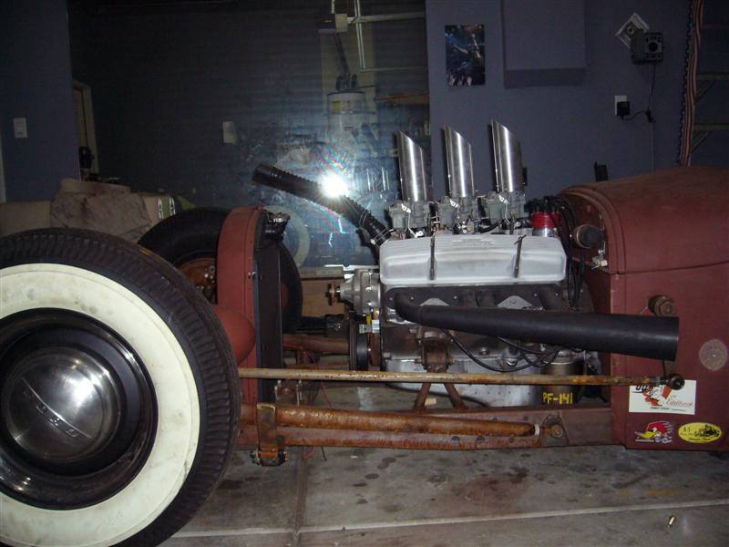

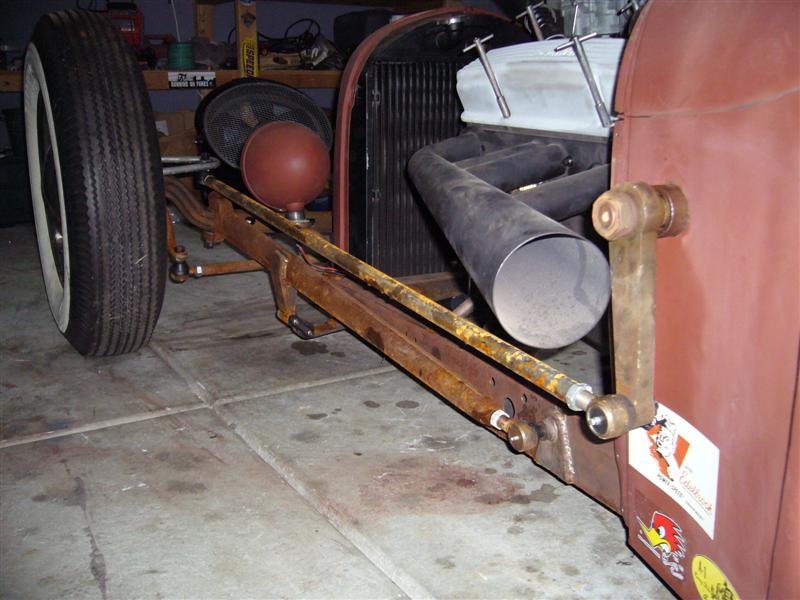

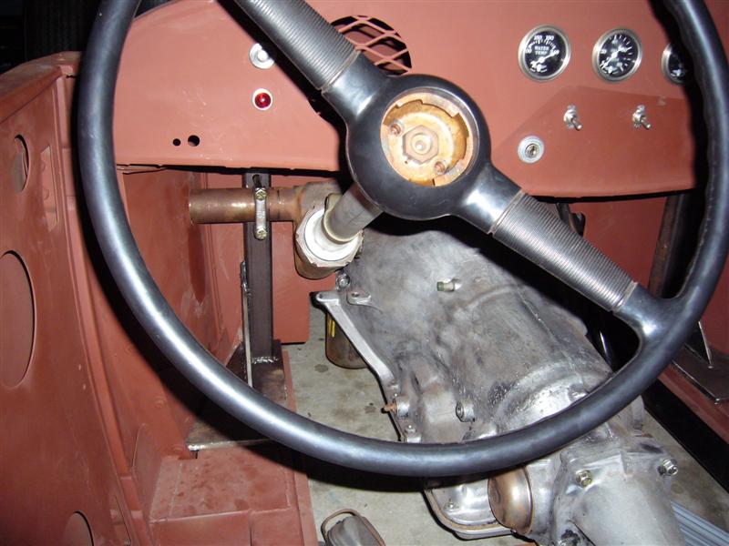

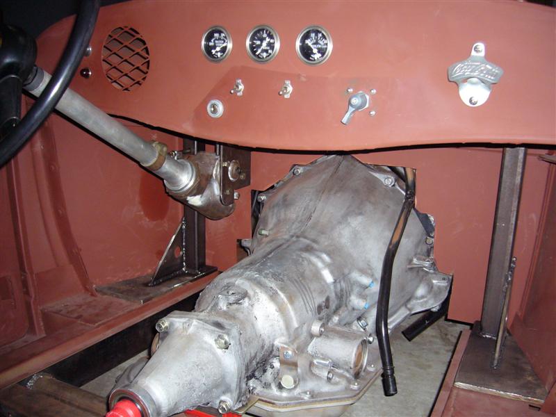

    Wheels and tires are 15x5 6.70 all the way around. Heres the box installed in the car. Still need to bolt it down to the frame but it looks to be solid.

    What steering box you got there?
    Gary
  7. wedgeii1
    Joined: Apr 24, 2006
    Posts: 552
    wedgeii1
    from california
    Its a reversed saginaw.
  8. Limey Kid
    Joined: Mar 5, 2006
    Posts: 1,024
    Limey Kid
    Is that a "Last Refuge" body?

    I'm dumb... What's a "Last Refuge" body? An do you worry about flex in the split bones with the spring mounted like that? I know the shackles are supposed to move with the spring flex but is there a chance it could twist. Your shackle mount makes a great lever. Just a thought with all this talk about split bones and all. Referring to your rear mounts is that plate steel? Were you going to reinforce them with a side gusset to the axle? I would think they could flex sideways? I'm not trying to be a **** I am just curious for my future builds. Thanks, I do really like the look of your car.:D
  13. wedgeii1
    Posts: 552
    wedgeii1
    from california
    The split bones are pretty stiff. Don't think they can twist or flex much. Havnt driven it yet though, so you may be right. I'll let you know. And if you look at the rear spring mounts close you'll see that they do have a gusset for support. Look at the first pics I posted. You can see them clear there. And yes, its plate steel.

    What did you use to attach the split wishbone to the frame.
    Looks like some kind of plate. I want (2) of them.
  20. edgeabilly
    Joined: Dec 10, 2006
    Posts: 735
    edgeabilly
    Yeah, could you post a pic of how you attached the wishbone to the frame??:D
  21. MUNCIE
    Joined: Jan 24, 2006
    Posts: 2,423
    MUNCIE
    from Houston
    Keep up the good work looks like the car is coming along nicely.
  22. wedgeii1
    Posts: 552
    wedgeii1
    from california
    Its a standard wishbone mount cut in half and welded to the frame. Would be easy to make one though too.

    WEDGEii1, you can take those cups out from under the headlights.
    The "ball" on the headlight will fit snug in the "cup" of the stand.
    They will hold there aim better too !
