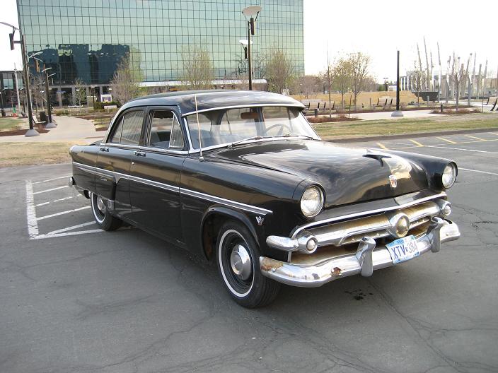

    It seems to be working the way it is. I cant take it out until I rebuild the brakes. If I pull the cable off the battery while its running it keeps running, so I assume its still charging. Here is a picture.
  9. That is a good looking car.
