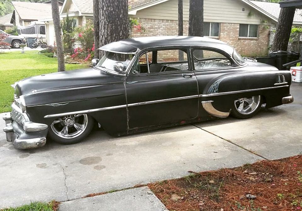

    image.jpeg This is the only pic of the car I have right now. I'll look in to a different wheel set up for it.
    Maybe somebody here knows the car. I picked it up in Houston last week.

    And that is a little "gender/identity crisis" on wheels to me. The wheels are way to big (for most HAMBers), it would look better with painted steelies, the visor looks like something out of a Mack B-series cab, why does the front bumper look like a snowplow, the car is so low that I doubt it would ride over my drive way (that is gravel like you see in a train yard) Mexican blanket (?) and no back seat but dynomate? Not typical HAMB stuff, in less you plan to change it.

    read your profile - my first thought was that you were a know little young guy that dove in too deep seeing/buying a ride that goes up & down - a good time to teach your kids the right way to correct things when you buy someone else's creation. nothing wrong with muscle cars, just not to be discussed here. your site texasdragracing.com is interesting - maybe one of your racing/muscle car connections would be interested in trading some good rims/tires for your set up.

    image.jpeg No offense taken at all guys. Been a hot rod guy for a long time. I know drag race suspensions. First time diving in to the air ride stuff. The car was someone else's project that's why it's not done yet. No interior....etc. Don't know anything about the front bumper but I looked at other 53's and it's pretty much factory stuff. Plan is to give it some nice shiny paint and restore all the stainless. Will probably leave suspension as is for now. But will look into an adjustable coil over setup. Also need to finish up the interior for it. My kids are still in drag race mode so I'm on my own on this one. This is my 1957 Belair I did a few years back. So I do have some taste lol

    It could be a 53 chevy with 54 front sheet metal and grill. But it is not a Belair. Looks like 53 tail lights
  21. Jalopy Joker
    Joined: Sep 3, 2006
    Posts: 33,702
    Jalopy Joker
    maybe 53 1/2

    I have caught a lot of flack about the 54 nose lol. But it's a 53 Chevy. Domt really know if it's a Belair, 150 or a 210. It's missing all the stainless around the windows and the lower trim. But all the holes are there for it. I imagine after 63 years some stuff has been changed around. I just love the ole girl. Takes you back to a time when cars had character and became part of the family.

  25. It most likely is a 53 210 series with a 54 front clip. Side trim and dog egg trim say 210. 210 had belt line and window moldings.
