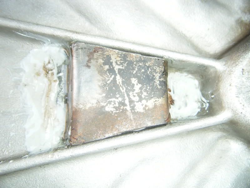

    Another vote for concern about the epoxy.
    What you gotta realize is even though the intake itself probably won't hit 240 due to cool air on one side, +240 oil temps are extremely common and that baffle's gonna get oil splash. But I could be full of shit. Wouldn't be the first time.

    People use JB Weld on intakes all the time. I really think it'll be ok. I didn't want the constant worry of some tiny screws backing out and ruining my engine.

    As to the epoxy, your concern is noted. I understand your point. I think it'll be ok though, but I'm no expert and I may be full of shit too. Worst case scenario is it doesn't work and I have to take the intake back off and have it welded. I'll only be out some time and intake manifold gaskets. The baffle is too large to fit through any holes (which is why I didn't want to use any screws) and will just sit in the valley. I imagine I'll know if the epoxy fails if oil starts getting into the carb or I get a lot of smoke in the exhaust.
    For the record, your'e entirely right. Welding it would be the best way to do it.

    Here's the pictures. Now nitpick and criticize all you can. Seriously. It'll only end up helping others.
    PCV Valve with rubber grommet on top of the intake manifold...
    The Bottom side of the intake manifold with the baffle in place...
    Closeup of the baffle. The gap on either side is roughly 1/8" (I'm talking vetical gap, side to side is much less)...

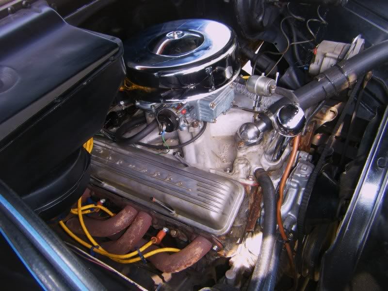

    Now for the finished product. Before, dull, ugly and boring...
    After, a tiny bit more exciting. I think besides a little clean up and some small details here and there, I'm pretty much done under the hood. I will be doing something about those ugly headers, by the way. I painted the engine bay, firewall, inner fenders and under the hood. I got a different air cleaner, new carb, and some black heater hoses. And of course, the vette valve covers and old timey Edelbrock Torker intake manifold...

    What's up with all those hoses and V12 Dizzy?? Would look better with breathers on the vavle covers.

    I'm swapping that one for an even bigger distributer and I'll put a breather right in the "v" in "Corvette" on both sides. That should look awesome. I've been thinking about taking some sand paper to those valve covers too for some even awesomer patina. Or maybe paint them? Pea soup or maybe snot green? What do you think?

    Terd, Engine bay looks much better, I am digging it for real. Now we just need to section that SOB.

    I got the timing set and it runs really well. I lost a little low end but gained a bunch of midrange. The pcv is working just like it should. There's no smoke from the exhaust, and no oil from the breather cap on the filler tube. The only downside is I've got an oil leak at the distributer now. A new seal should fix that up and I'll be as good as new. But with an awesomer engine.
    I'll have to keep an eye on everything, but all in all, I'd say that this has been successful elective surgery. Not much cash outlay from the free valve covers and a smokin' good deal on intake from a hamb'er and a little elbow grease. A massive improvement for the effort involved. Now to do something about those ugly headers.
    Thanks everybody for the suggestions. I'll let you all know how this is working as time goes on.
