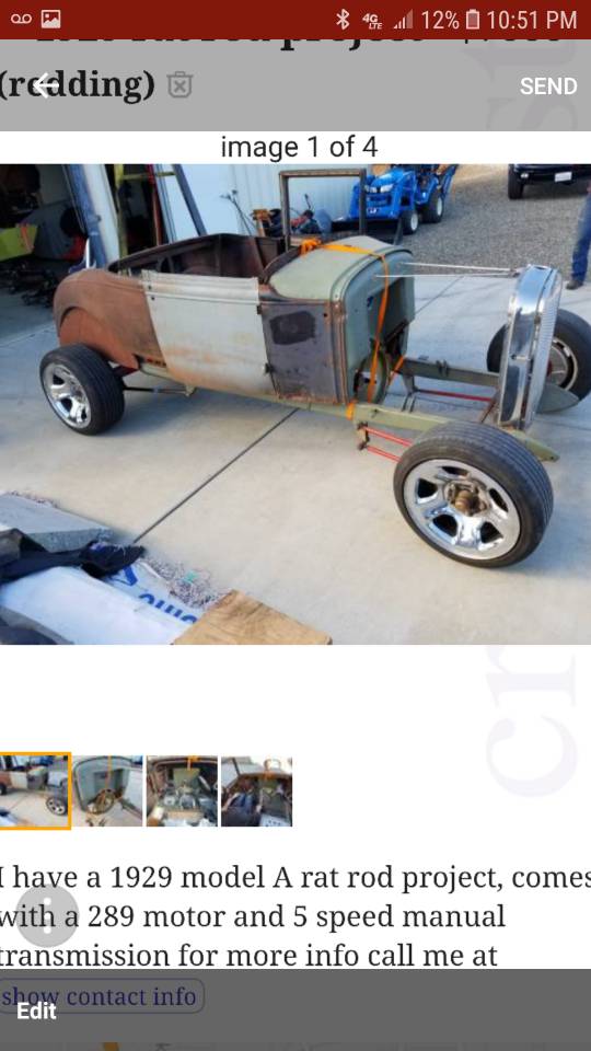

    Do I call it a coupe or roadster with DMV? If I have to do a light and brake test and they see a coupe, it could cause problems.

    Coupe (CP). It is not now, nor will it ever be a roadster. That is a different body. You just cut the roof off a coupe.
    Why would you have to do a brake and light test?

    I should have added that I didn't cut off the roof, and that I plan to do a thread soon. I'm not trying to trick anyone. DMV on the other hand can be difficult to navigate.

    Thanks for the photo. Maybe you have to go with what it is, not what it was. Even if you'd cut the top off, I wouldn't call it a coupe. DMV might make you register it as a reconstructed vehicle?

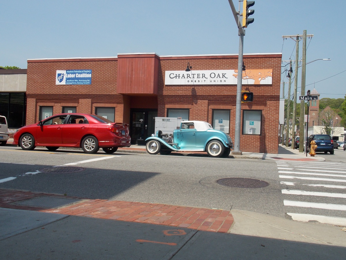

    I agree, find out what few designations they will allow in Cal.
    I agree, you should not list it as what it once was, but what it is now. The written designation is for visual identification for Law Enforcement. That is no longer a coupe body style, and does not look like a coupe.
    My 32 former 5w coupe is now legally registered in CT as "conv". It sure doesn't look like a coupe anymore. Long ago in my state, there would have been more allowable designations, like "convertible coupe" or "convertible sedan", which were factory sales terms used many decades ago, but they now have made the choices very limited, and "conv" is now used by CT DMV here for both.

    I literally handle this, as an agent of The State of California.
    It gets registered as what it started life as.
    Also, you need to do your paperwork BEFORE beginning your project, not after.

    Since you are getting a lot of advice, much of it inapplicable, or flat-out wrong, and from other states, I will run you through my standard questionnaire. I am a California Licensed and Bonded Vehicle Verifier, and I am not guessing.
    1. What supporting do***ents do you have to prove ownership of this vehicle?
    2. Are any of those do***ents ones that were issued by The State of California?
    3. Have you verified that the numbers on the state-issued do***ents match the ones on the vehicle, in the proper locations (In this case, engine block, and left frame rail, adjacent to the body mount.), and that they are the OEM stamping?
    4. If you do not have state-issued supporting do***ents (***le, old registration, old plates, etc), are you prepared to bring the complete vehicle to CHP for a tear-down inspection to verify the serial numbers?
    Yes, I said tear-down. The serial number that CHP will be looking to find is between the body and the frame. They will be taking the body off of the frame. No, you don't get to supervise. If there is an issue at that point, you don't get the car back.
    If that is a boxed and modified stock frame, you should be fine, provided that you verified with the DMV that the serial number was clear, prior to purchase.
    If it is an aftermarket frame, you will need the Manufacturers-Statement-of-Origin (MSO), and all of the other do***ents described in the SPCNS program: https://www.dmv.ca.gov/portal/dmv/detail/vr/spcnsreg
    As for the body style, you have one, of other of the Model As that had a soft top, with a wood structure, and were not a cabriolet or convertible (e.g: special/business coupe/sport coupe). It is hard to say with no top on it.
    If there is a records mismatch between any existing records regarding how this vehicle was previously ***led, and how you obtained the current paperwork, your ***le and registration can be revoked (true in all 50-states, for you California bashers).
    You can apply for a body style change AFTER it is ***led as what it began life as, not before.
    As for what body style that it gets registered as as a specially constructed vehicle, of that is your route, that is up to the inspector, not you.

    That body looks a little on the rough side. If that were mine I would give myself a period of time to collect some extra panels maybe a rough coupe body and combine the 2. Build a coupe. A piece here, a piece there ya know they come together. Good luck
    I have no knowledge of what you should do at the DMV but I have built a coupster. I think they can be cool but if I were to do it again I would have put a roof back on.

    If the body shown is one of the open-topped cars with wooden inner structure you might want to look elsewhere if all the wood is gone and you are not a skilled fabricator. Without a steel inner structure there just isn't very much there to build on because it was all put together with nails and screws. It can be done, sure, but if you are not an experienced builder you'll find yourself over your head very quickly.
    Even if you should decide to replace the original wood with new wood the structure won't be very strong without the top structure and upper door frames. My coupester was built from a Sport Coupe (I think...) by somebody who had no idea what he was doing and ended up being a very poor hot rod - too flimsy with no way to make it strong without a complete make-over. I still have lots of work to do to correct as many of the previous builder's mistakes as I can, but it will never be as good as a coupester made from a real, welded-together coupe.

    I have a bill of sale with matching Vin on all three places. I've checked with DMV and the VIN is not on record cause it's been so long.
