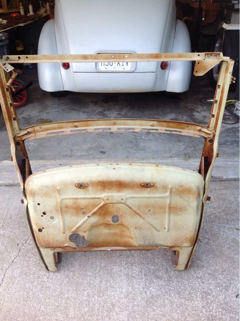

  1. Stopped by my buddy's tow lot yesterday and saw this cowl in the back of a truck going to scrap! Couldn't let it go. Now that I have it home...what is it?! I'm guessing late 20's ford maybe? Also thinking truck with the high hinge???
    Any thoughts are appreciated ImageUploadedByH.A.M.B.1400195662.083405.jpg ImageUploadedByH.A.M.B.1400195683.543631.jpg ImageUploadedByH.A.M.B.1400195696.031790.jpg ImageUploadedByH.A.M.B.1400195710.388320.jpg

    30-early31 Ford

    What he ^ said...30/early 31 Model A

    yup, good save.

    pretty sure that's a 30--31 ford cowl and I am not even a ford guy

    Definately 30-31 Model A. Here is a tank if you get far enough in the planning that you need one. Rod

    The cowl above is a 30/31 coupe cowl. They are shorter than a 30/31 sedan cowl. If you have a cowl missing the small second body line I would wonder if it could be a 29 four door cowl. They looked similar.
  13. 31s had recess for fuel bowl on firewall.
    That's probably a 30.

  17. Mo rust. The horizontal body line is there. The one it doesn't have is the vertical that runs on the front edge on the cowl. The back edge of the hood would meet up to it.

    Ah. I think your talking about the area where the stainless cowl band bolts down. I've seen some bodies have a raised line, some have just some raised bumps an inch or two long and some without anything. It might just be a difference of which factory the cowl was stamped at but that's just a guess. I've seen this in both open and closed bodies.
