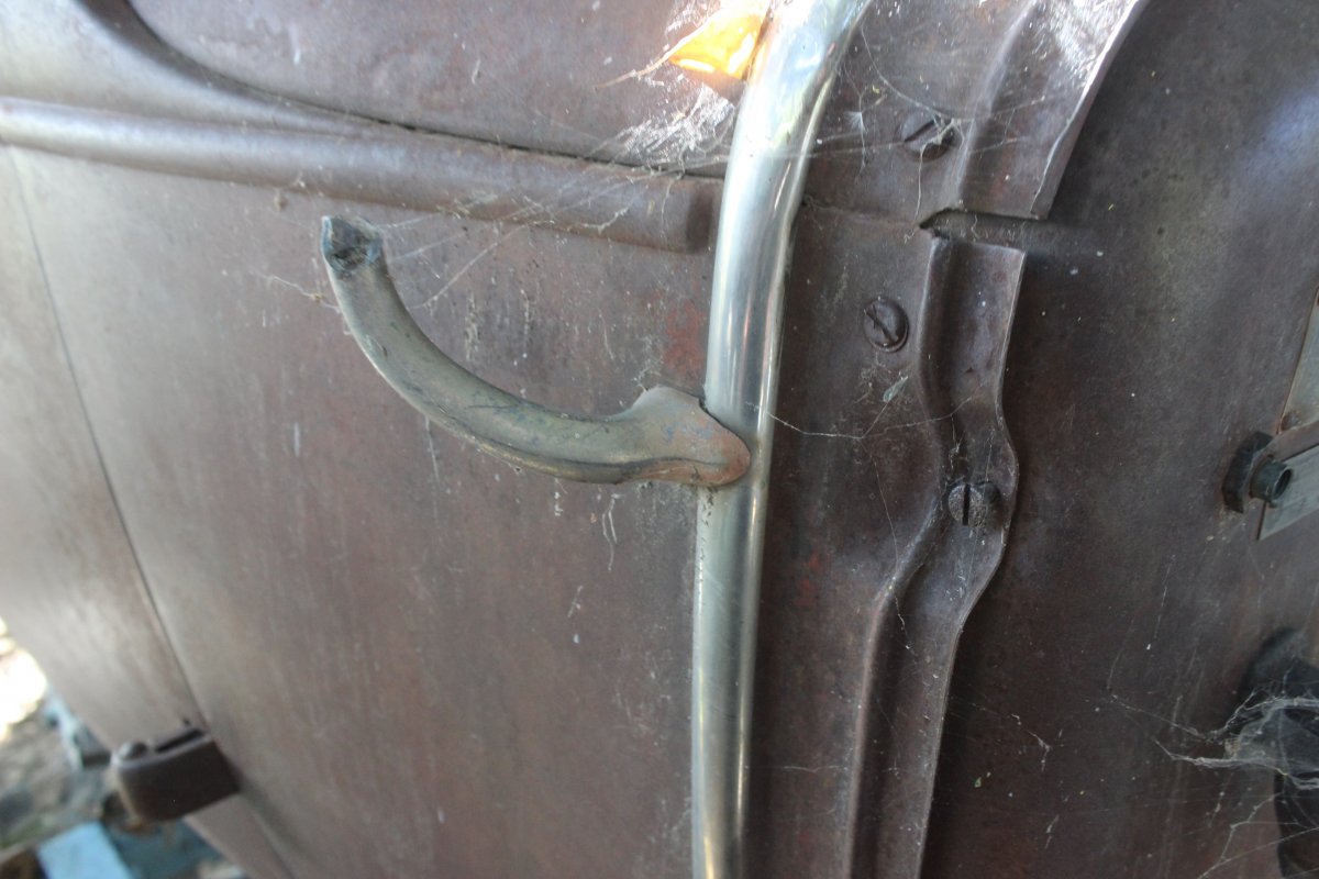

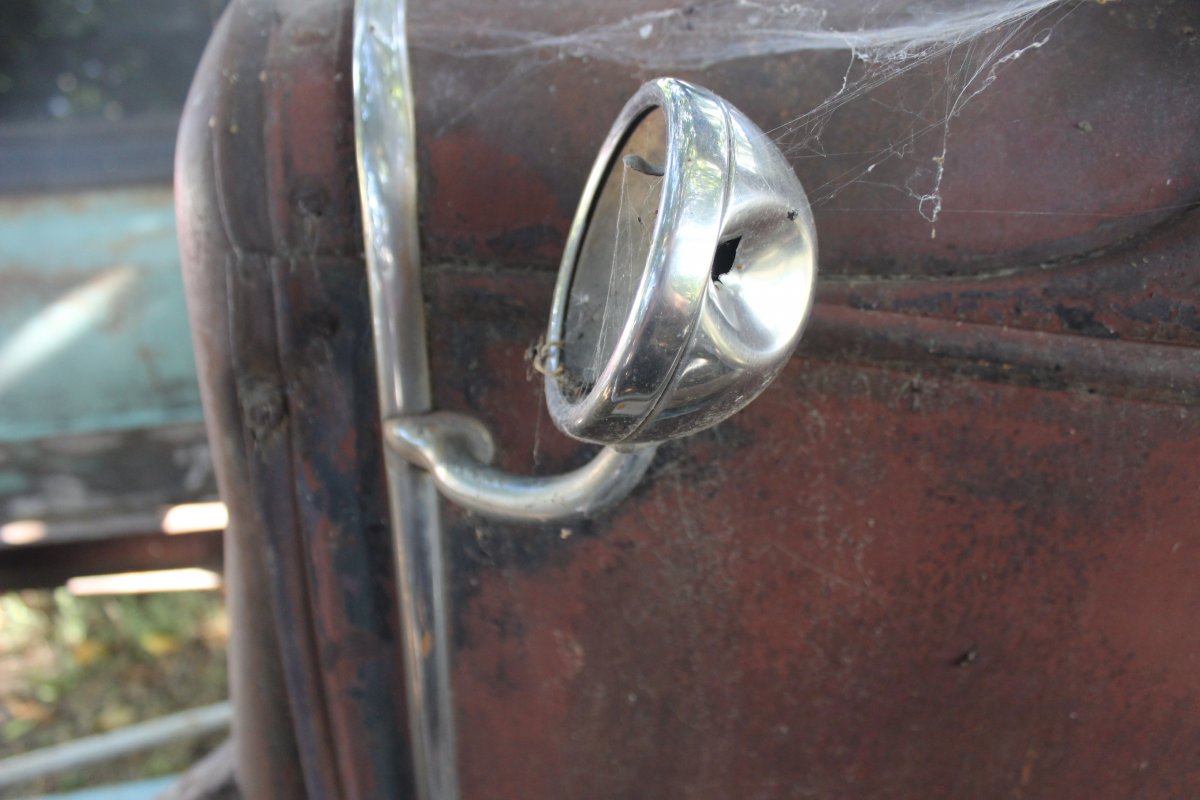

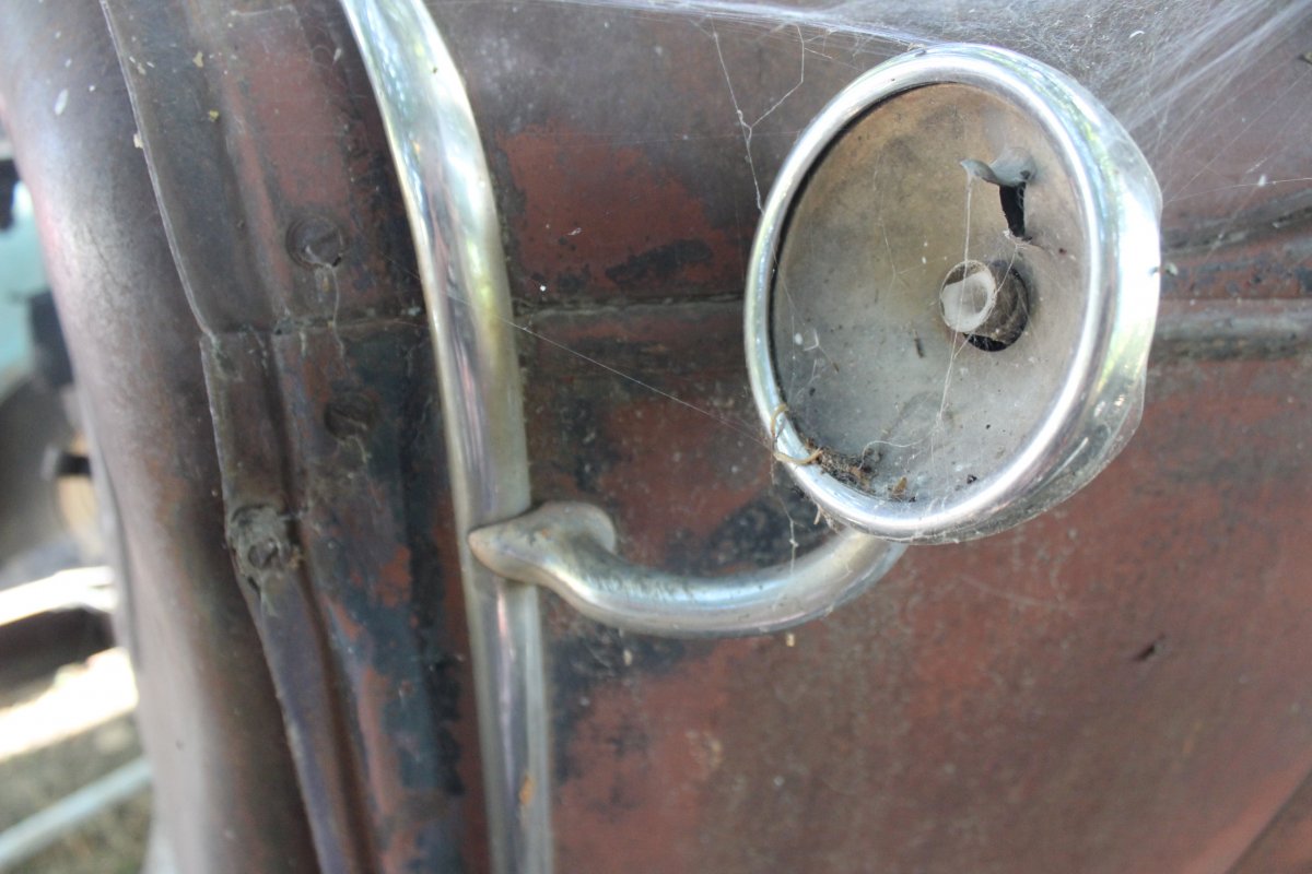

    This is my 31? Victoria. Left side has stainless / shiny right side I'm not so sure if te chrome has deteriorated or it wasn't chrome .
    Both are obviously damaged but should show what the guys are saying. IMG_8064.JPG IMG_8066.JPG IMG_8062.JPG IMG_8063.JPG

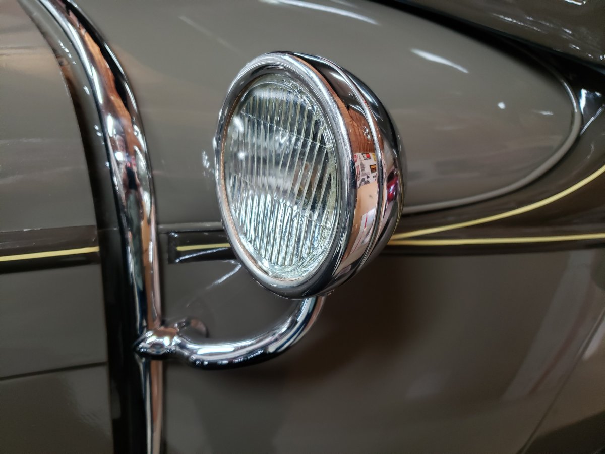

    Here's another example of the '30 - '31 .
