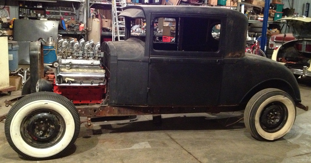

    Hi, I am building a 31 Plymouth coupe, and plan to use a mid 60's Mopar manual steering box mounted under the cowl, with the pitman shaft (or an extension of the pitman shaft) protruding throught the cowl. The car will have a straight axle and parallel leafs in front. It will soon be time to build mounts for the steering box. I need to determine the length of the pitman arm so I can determine the height of the box. Ideally, I would like to mount the box up high to provide room for the pedals and my big feet. But it seems that the the pitman arm would be excessively long or the drag link would not be level.
    If anyone who has experience or knowledge could please advise, I would be very grateful. Some of the questions I have:
    Should the drag link be fairly level, thus requiring that the bottom end of the pitmman arm be even with the steering arm on the axle? What about a 2 peice drag link with a link, or a bent drag link if I mount the box up high?
    Should the pitman arm be the same length as the steering arm on the spindle, to give a 1:1 ratio, or is there a formula to calculate the ideal length of the pitman arm?
    Would there be any better way to do it, like mounting it under the floor?
    Any other help or advise?
    Thanks, Joel

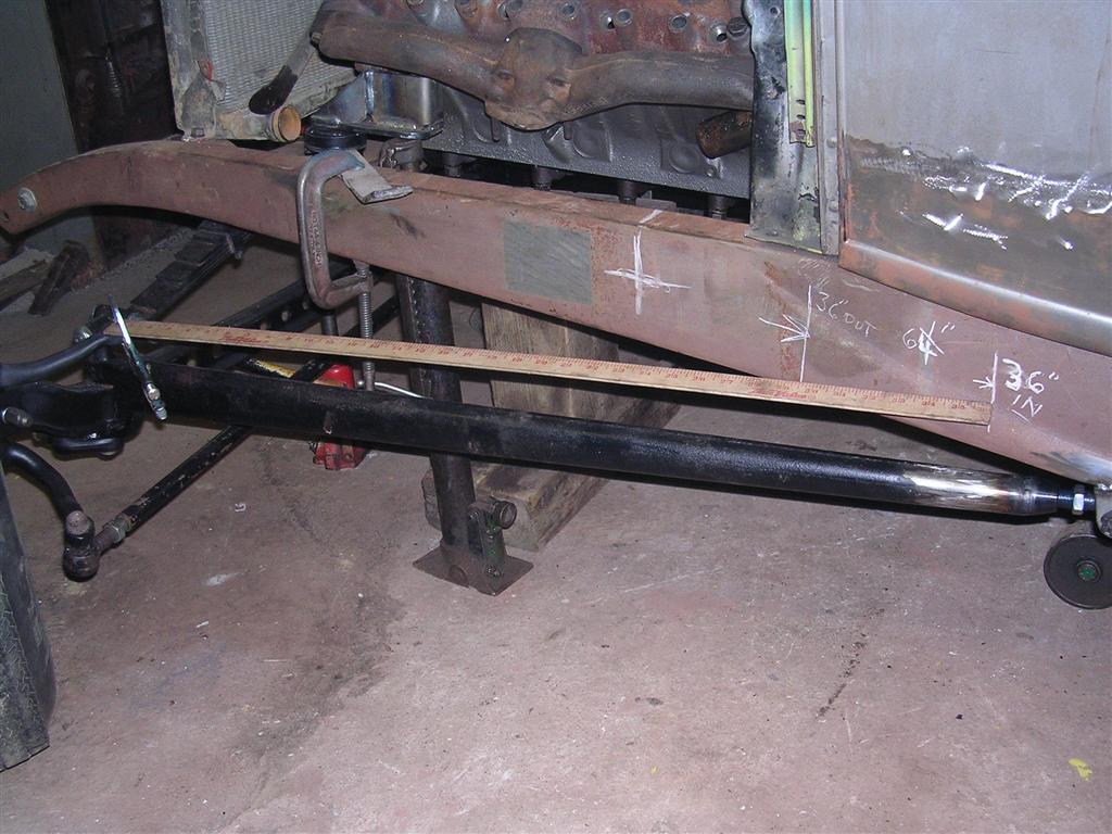

    Start by mocking up the box with the arm on it. You can do this on a table. Count how many turns from lock to lock, but also make marks on the table to show where the draglink hole is, on both locks. Then measure how much distance the imaginary draglink has moved from lock to lock. When I do this, I use a yardstick, and mark further away from the box to make errors less likely. Just keep the box stable on the table while you turn it.
    Now do the same marks on the side of the frame or cowl, with a yardstick, measuring from steering arm hole on LF spindle, to see how much distance the draglink must move, to go to full turns, both directions.

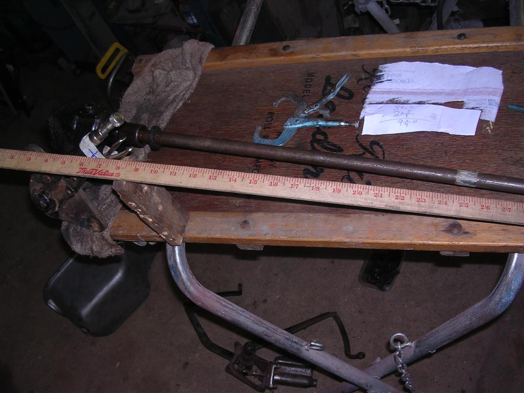

    I forgot to answer your question about a much longer arm.
    Do the mock ups like suggested with the stock pitman. Then figure out how many turns of that box/arm will go lock to lock, if it was hooked to the spindle arm. It's just math. :)

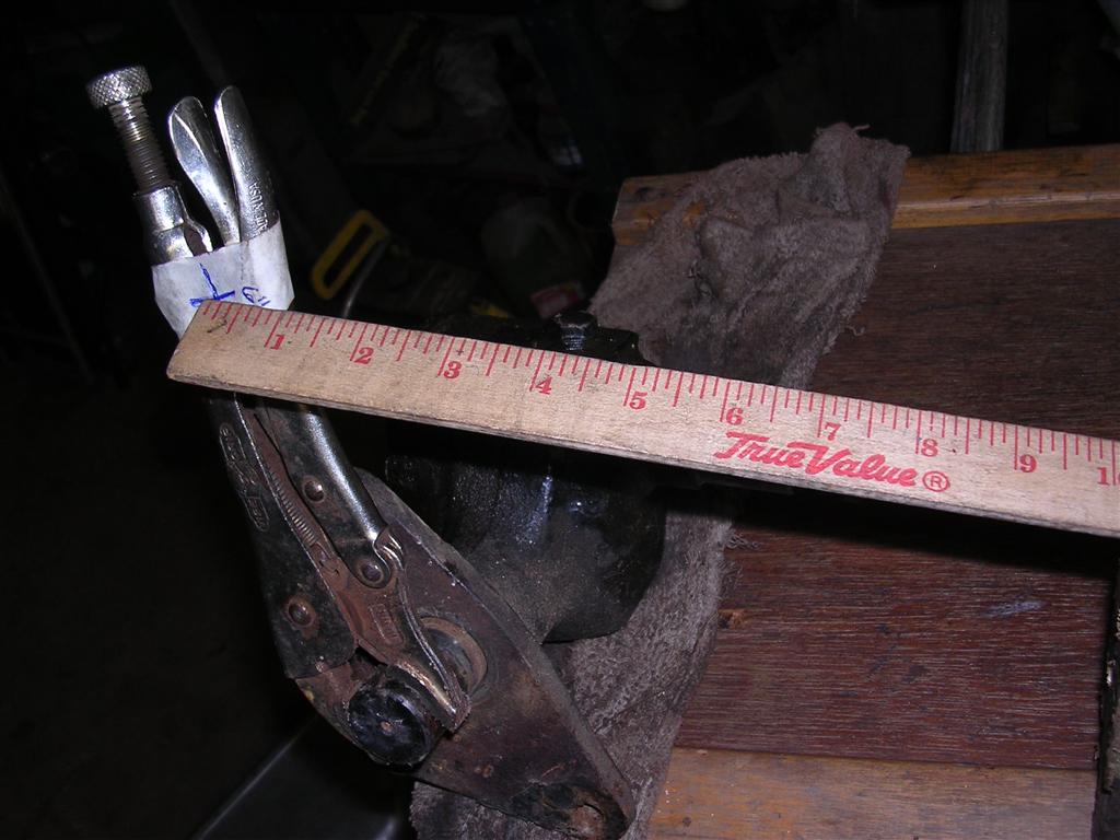

    Now if you want to know how many turns it would take with a longer pitman, clamp a paintstick to the pitman, and mark the "new" draglink hole on that stick.
    Now run through the lock to lock on the box, to see how many turns are needed on the steering wheel, to move your steering arm from lock to lock (going by how many inches the imaginary draglink has travelled). If it ends up under 2, I doubt you will like the feel. It will be heavy, and dart like a go-cart with a slight movement of the steering wheel.

    Some pics to help make sense of the above "imaginary" stuff;
    Pic of how the yardstick is used to make marks on framerail. Also the F100 box on the table with Visegrips with a tape mark showing me where a stock F100 pitman hole should be. I did not have an arm yet, so Dreddybear gave me that measurement from his arm.
    I ended up with 3.5 turns when all the parts were finally installed, just like mock ups suggested it would be. If I wanted to go quicker, I'd have to make the pitman longer. But I could not do that, as the draglink angle would be worse. And I could not make it quicker by shortening the spindle artm, because then the draglink will hit the tire on a full left turn. So 3.5 it is, and feels good to me.

    In my opinion the car in the pic is a real bad candidate for cowl steering because the piman arm is 6 or 7" hole centers and the drag link from pitman arm to spindle steering arm needs to be level.
    So measure from the ground up to where the steering arm end is located then add say 7" and measure on your cowl - that is where the center of the cowl steering should be. I'd guess it'll be only halfway up the cowl and that'll put the steering box right into the pedals.
    Again, the tube running from the pitman arm to the steering arm needs to be level so that it raises/falls at the same 'rate' as the front suspension. If it runs downhill then when the car hits a bump the axle rises against the drag link and the tires will toe-out. Bump steer.

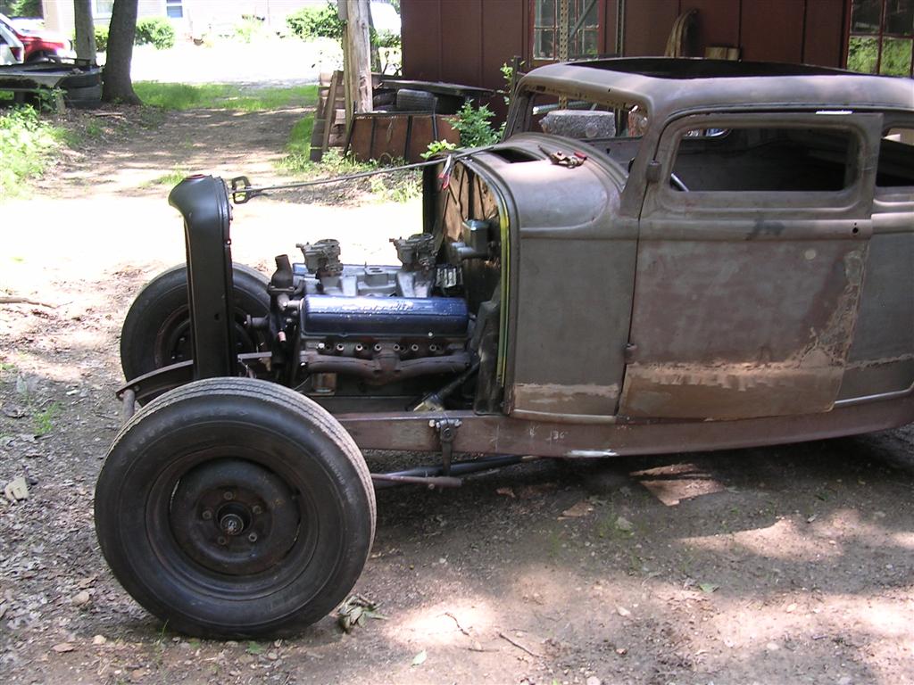

    You can raise it, but there must be an engineering limit as to how far, with whatever style of arm it is.
    The 32 in the above pics is not mine. The owner wanted traditional F100 side steer. The angle of that link is not the best, but it is better than most 32s with the same box, because this axle is not dropped. Also, that spindle arm was dropped lower than stock 32 arms are. And, the steering box mounting holes were drilled as close to the top of frameail as possible.
    We live in an imperfect world with the old style side steer. You won't find many that are textbook perfect on length, or angles.

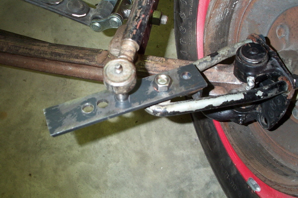

    F&J did a great job explaining, I would like to add some more food for thought to this thread. If one wants to do a cowl steering and the car sits fairly high it stands to reason that the box would have to be closer to the pedals to keep geometry in line. Raising the box up and adding length to the pitman arm to keep the geometry in line, lengthening of the spindle steering arm the same amount will bring the ratio back to what it was.
    Another option is to make the spindle steering arm taller or arc upwards more, this can look busy but can help to get the box higher in the cowl. This will also help with drag link tire clearance in full turn as the tire link interference is less the higher it is. Also as far as steering effort, or turns lock to lock, what is perfect or acceptable depends on ones preferance. Steering wheel size also makes a big differance and is directly related to steering effort/ratio as well.
