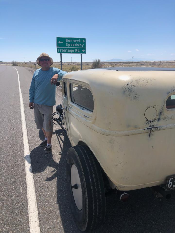

    22575 (1).jpeg KIMG5730.JPG View attachment 5840659
    I had the pleasure to help Judy out with her Bone's 32 Tudor, An got to drive it down rt. 80 up to 75-80 mph...
    She has Schroeder in her's...
    Perfect!!!
