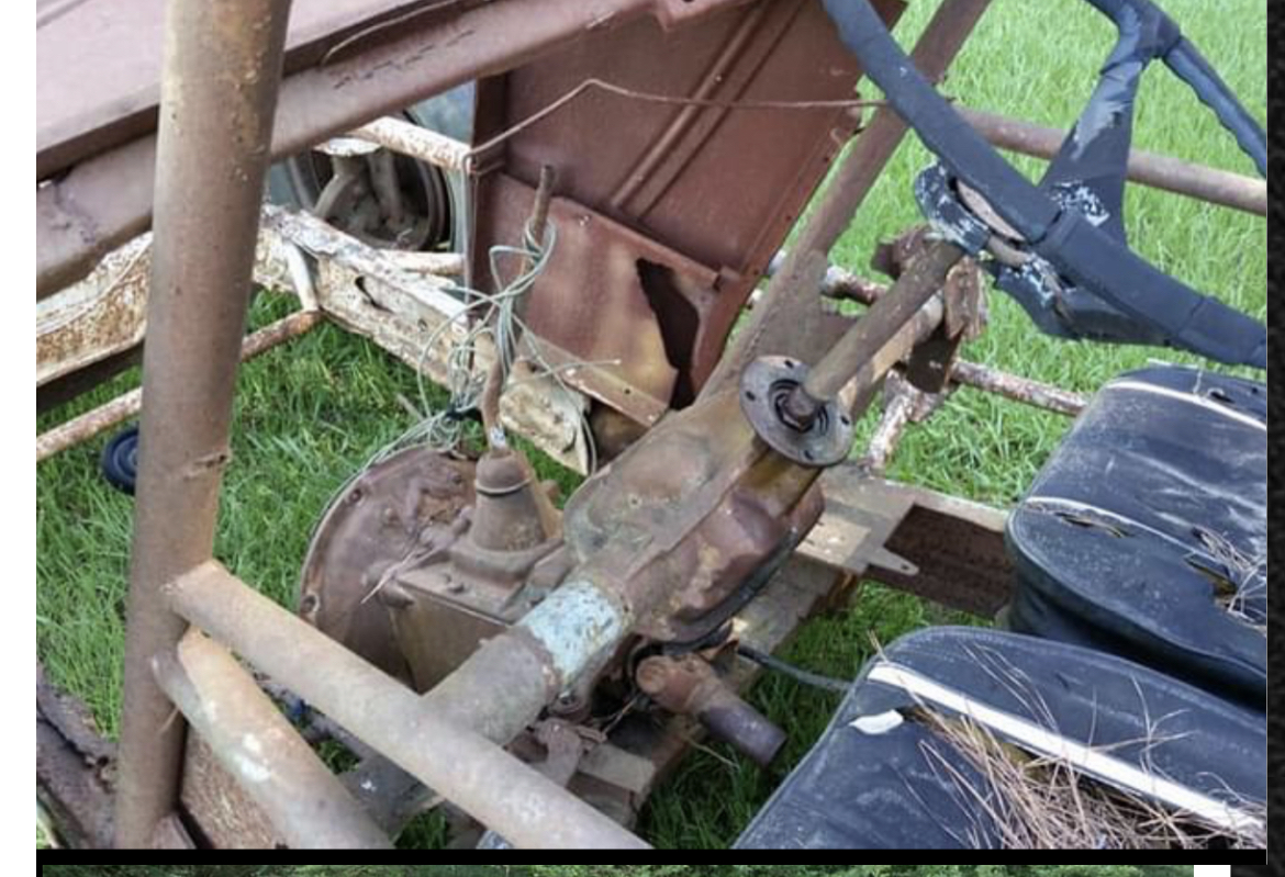

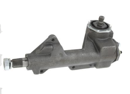

  10. alanp561
    Joined: Oct 1, 2017
    Posts: 5,681
    alanp561
    Not trying to hijack the thread, just asking a question. I've seen some 16-year-old posts on here from people reversing mid-70's F150 manual steering boxes to use for cowl steering. From what I read; the ratio is 24:1 with 6 turns lock to lock. The pictures don't exist anymore. Has anyone on here actually seen one used for cowl steering or seen it done?

  13. SimonSez
    Joined: Jul 1, 2001
    Posts: 1,671
    SimonSez
    I am using a RHD F100 box in a vintage sprint car project.
    It was pretty easy to reverse - I followed the instructions on reversing a Saginaw mentioned above.
    Here's some pics of the seal adaptor and plug I machined up. They are a press fit with bearing retainer to seal.
