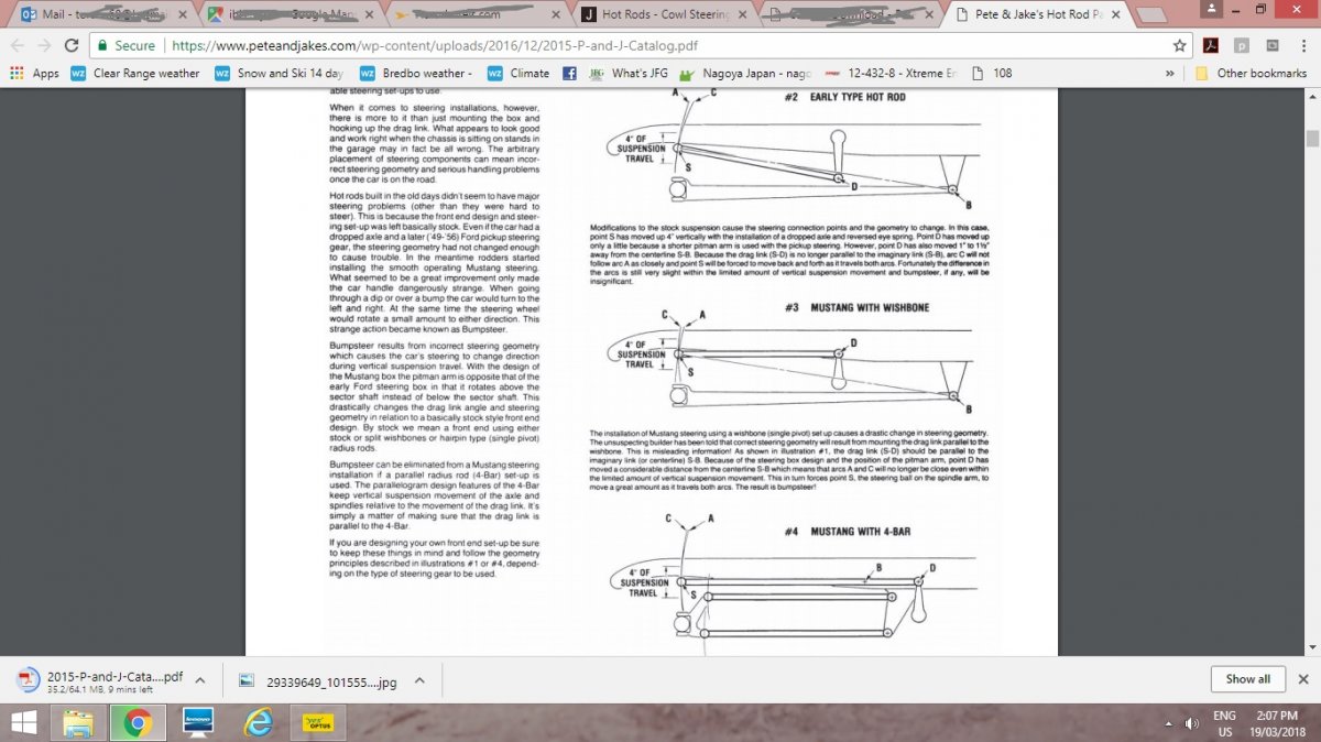

    Serious question. I tried to duplicate your diagram accurately and unless I am missing something, doesn't the diff. in radii yield bump steer? bump steer diagram.jpg

    yes you are missing something. you need to go back and read Pete's thread (I know it is 15 pages) there is where it is explained. here is a copy of the pete and jakes catalog. this may explain it for you peteandjake.jpg

    Based on my limited understanding of Pete Eastwood's wonderful cowl steering explanation, I believe that it is not simply different radii that creates bumpsteer. It is intersecting arcs. In the diagram you drew, those arcs will forever be perfectly co-eccentric, which will not cause bump steer

    It is the centre of the radii that matters, not the length. As long as the centres are very close the length makes no difference. That is the whole ‘core’ problem of the bump steering issue: different centres of the radii.

    the problem is @wstory used the wishbone to axle area as one of his arcs. this is incorrect. both pivot points are where the drag link connects. it is spelled out in the pete and jakes catalog pic above and also in Mr Eastwoods thread I referenced earlier. 15 pages
