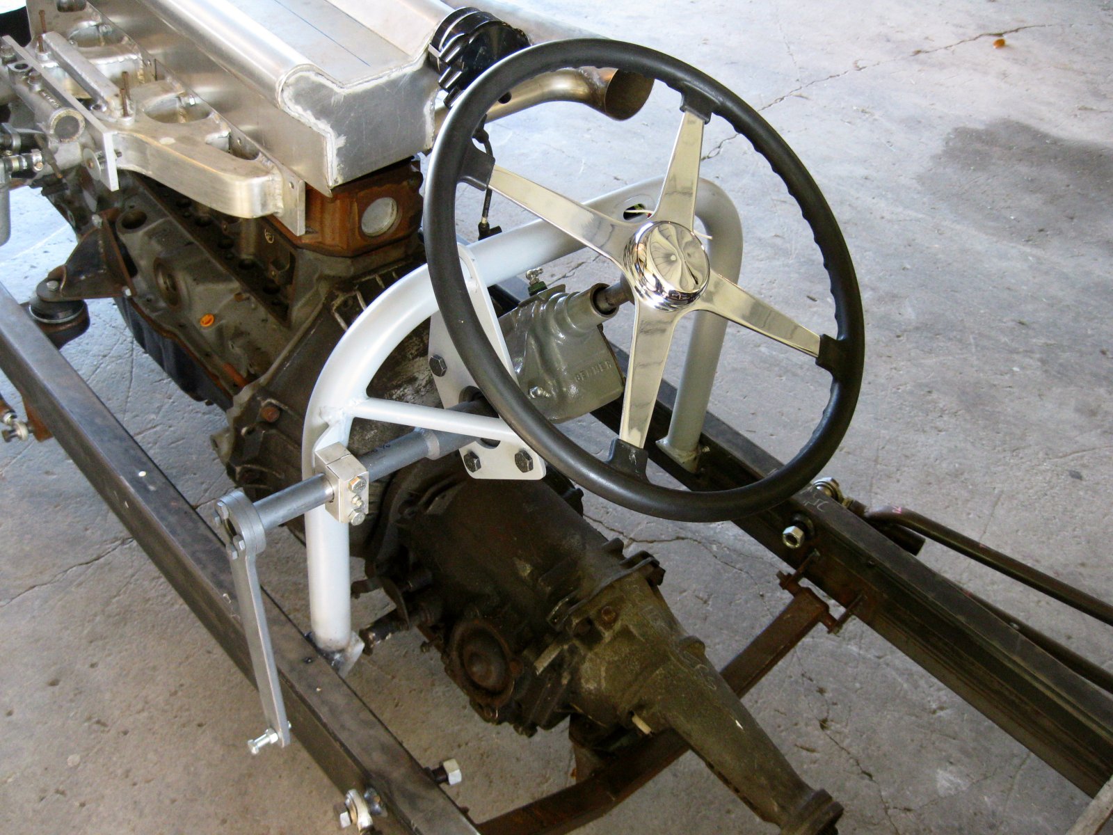

  1. Read all the posts against cowl steering but still determined to give it a try. The Rolling Bones seem to be able to drive across country each year so must be doable. I realize that they are using the Schroeder box as well. IMG_1573.png
    A little backstory, my new to me Vicky had cowl steering but due to an issue with the box, he was in the process of replacing it with cross steering. He installed a Flaming River box under the left engine mount. The car has a 401 nailhead and with the Sanderson headers, the collector is extremely close to the shaft, plus it does not even come close to the center line of the present column location. I have an assortment of Borgenson joints but can’t seem to get it close. I picked up a 69 Ford F100 box which I will reverse.
    Couple of questions to anyone who has got this in their car and has it working.
    1. What is the dimension from the bottom of the cowl to the center of the output shaft of the box where the arm attaches ?
    2. What is the center to center length of the pitman arm you are using ?
    The previous owner thinks that the box he was using was too high so I am thinking it has to be lowered about 3” to run parallel to the split bones. I also think that the original deuce pitman arm is too short and all the research I have done mentions 7” as the correct length.
    All advice appreciated.

    Ford didn't build an F 150 until the mid 70’s, only F 100, 250 and 350. So you must be working with an F 100 box. Good luck in your task.

  9. My bad and you are correct, it is a F100 box.

    Yeah, it's not good.
    Yeah, they use different parts, but...
    Check my math and tell me how to make it work.:rolleyes:
    You are going to have to do body work to move the pivot down.
    You are going to have to weld on the frame.
    You are going to made or buy parts.
    Lots of places sell good reliable setups.
    https://www.peteandjakes.com/partslist/?cat=12
    My advise is to use a good setup that will fit your car.
    If you just must have the rolling bones setup, copy it exactly.
    If this was the '50s and you were building a field car out in BFE with no knowledge or help and didn't plan on driving it with other people around, use a darn tractor box, who cares.
    Today, you have the experience and knowledge of 80 years of tinkering, swapping and improvements. The roads are full of other people driving cars with better brakes, suspension and steering while also distracted by a thousand things.

    The Big 3 created what was called "heavy 1/2" with a bigger payload (heavier rear springs) to beat the emissions requirements. That's why Ford went to the F150 designation.
    Randy Gross can alter the F100 box to work

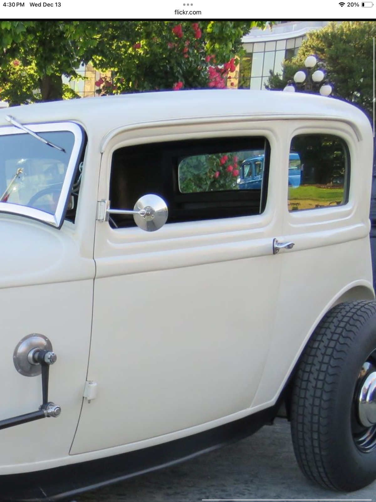

    Here's a converted F100 box in @DeadFast 33 's 32 Vicky project, before he sold it. I think this box came from Mike's Speed Shop in NC.
    I have no more information, just passing along some info I've seen on the interwebs.
