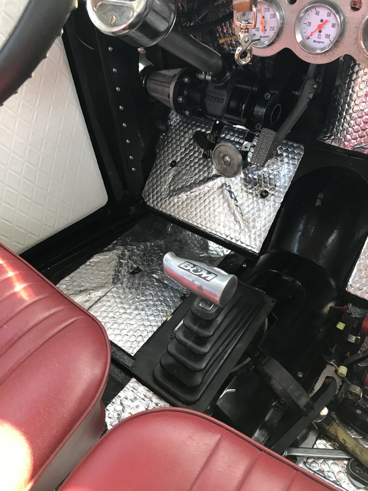

  11. flynbrian48
    Joined: Mar 10, 2008
    Posts: 8,699
    flynbrian48

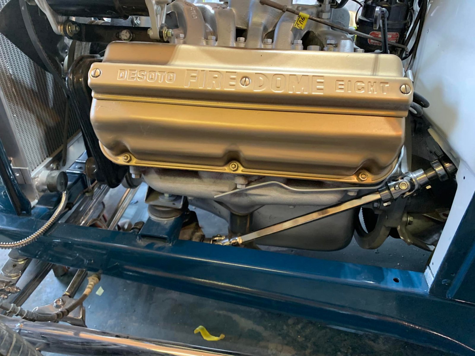

    EA141627-0CD3-424B-BCD0-8BFFD1875FDD.jpeg So, it's got Vega style box mounted now? I've got a Vega cross steer set up in my '29 on '32 rails, box under the engine mount, two U-joint gets the shaft around the DeSoto Hemi. It drives GREAT. I can't see how it'd be impossible to get a steering shaft to the box. Kids used cowl steering on their hot rods to imitate race cars 70-80 years ago, there's no reason to use it today. (edit) My steering colomn isn't at a goofy angle, although I could have lowered the bottom mount for a little more clearance at the engine, I didn't want the wheel above the windshield. 4BF8E05D-2E53-47BB-937D-ED6E69148F83.jpeg 8E5D3484-ED3D-4296-A05E-CCF4CAEE6B00.jpeg

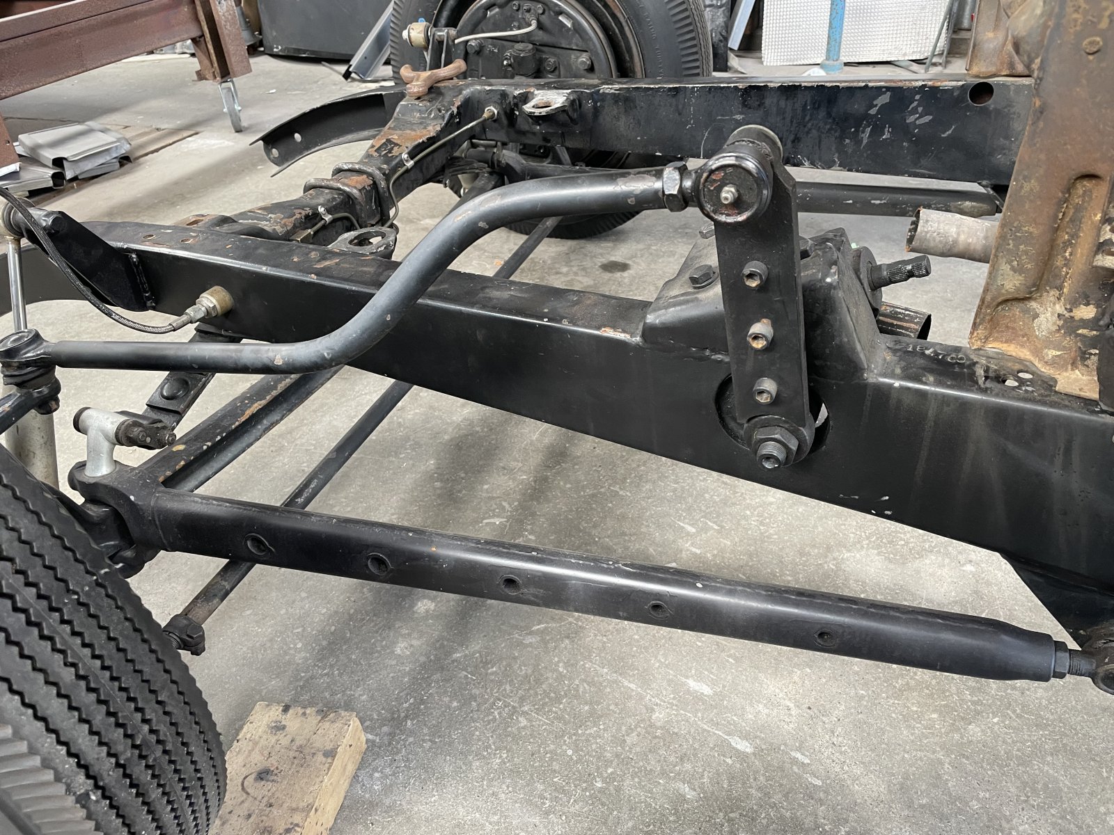

  13. dumprat
    Joined: Dec 27, 2006
    Posts: 3,572
    dumprat
    from b.c.
    @deucepickup32
    I warned you Roger! Lol
    As I mentioned, as long as your drag link and wishbones are in the same arc you will be fine. They Shouldn’t be parallel!
    Ned Ludd and deucepickup32 like this.
  14. When I set the Schroeder gear up in my friends T I did set the drag link parallel with the axle links, but that was for aesthetic purposes, that will do nothing for making it perform better.
    You have to keep in mind that the cowl steering is not the same as a 4 bar suspension set up with parallel links. On a 4 bar the end links are attached to points on the ch***is that only have one point of movement on each side of the bars, the bushed ends.
    On a cowl steering car your drag link is attached to points with 2 points of movement on each end, the spindle which which rotates on the king pin (point 1) and one tie rod (point 2). The other side is the pitman arm on a rotating sector shaft (point 1) and its accompanying tie rod (point 2). So now when your arcs of travel start to not match each other, something will give to compensate for the arc mismatch and it will either be the spindle turning on the kingpin or the sector shaft will rotate causing the steering wheel to move and that is where the bump steer happens.
    On the above mentioned T, it did indeed have movement at the steering wheel when the front suspension was jounced. That being said, it's still a very light car with maybe 1.5" of suspension travel even with the little Dodge HEMI in it, driving it was manageable even at 85 MPH on the freeway, on a heavier vehicle with more suspension travel it would be a huge problem with a very real potential to lose control.
    Long story short, most cowl setups will have bump steer if the pitman arm tie rod is not near the original side steer plane, each individual setup will have different degrees of bump steer it's just that your severity of it will vary depending on a whole host of factors beyond simple geometry. To say it can be eliminated entirely by some magical setup is silly.
  15. dumprat
    Posts: 3,572
    dumprat
    from b.c.
    There are three things that will help this geometry.
    #1 the spindle end of the drag link needs to mount ahead of the axle like an original spindle.
    #2 the drag link and hair pin cannot be parallel!
    #3 the wishbone or hair pin needs to be much longer than the drag link.
    this is not a parallelogram, it’s two similar arcs with a single center point. The closer you can get to that the less bump steer you will have.
    Ned Ludd and twenty8 like this.

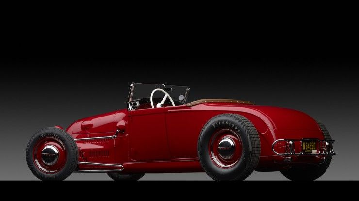

  21. twenty8
    Joined: Apr 8, 2021
    Posts: 3,690
    twenty8
    Strangely, early pics of this car show that it also wasn't originally built with cowl steering......
    Maybe a few tried it purely for looks, but most knew better.:rolleyes:

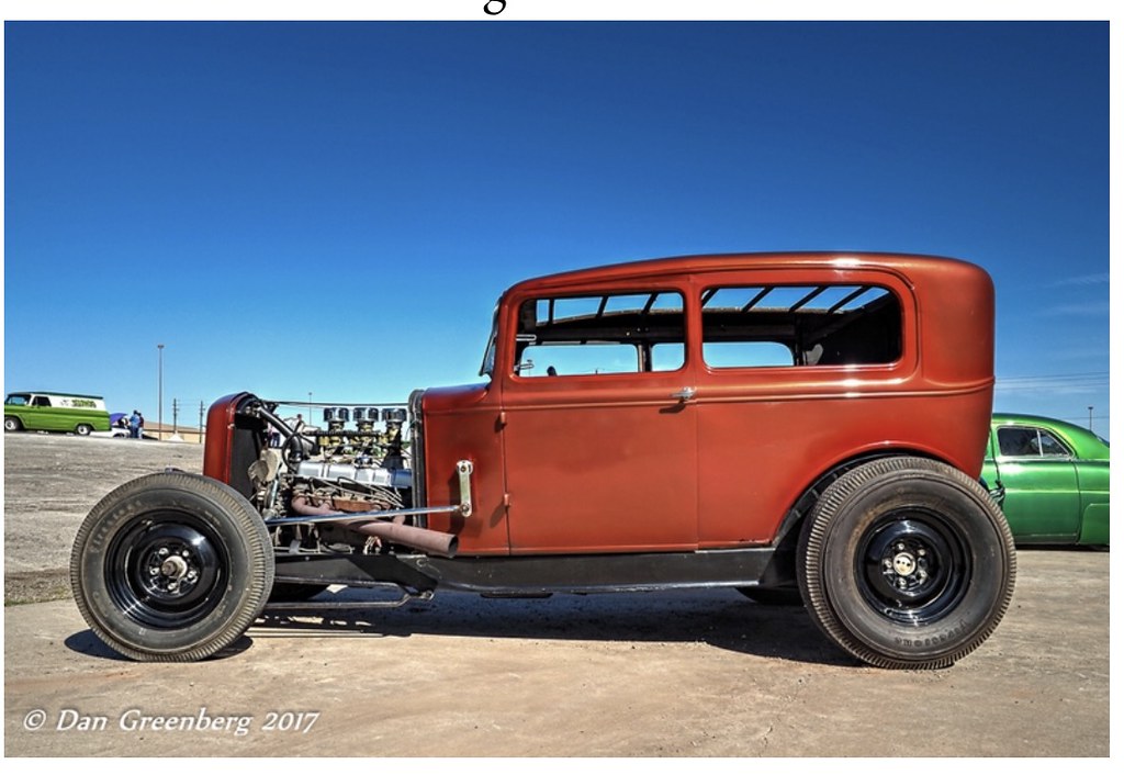

  27. ukgav
    Joined: Jun 16, 2008
    Posts: 361
    ukgav

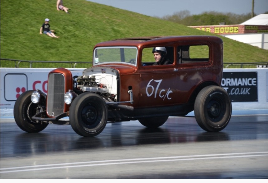

    Is the geometry correct? No. Does it become an issue with the limited travel of early style suspension? Not in my experience.
    My A sedan came to me fitted with cowl steering using a shroeder 8-1 ratio box so I had to work with it.. If you jumped up and down on the front then yes the steering wheel would move but I never experienced any sort of bump steer in the real world.
    The ratio though did mean that steering was very heavy, particularly for smaller UK roads.
    We took ideas from the rolling bones cars and dropped the box while raising the steering arm at the spindle to get the drag link parallel which improved things a lot.
    In this guise I used the car extensively on the road, at the drags, at hill climbs and running over 100mph at Pendine.
    The steering always felt very planted and never suffered any bump steer but the heaviness was still an issue so I stumped up the cash and bought a converted F100 box from Mikes speed shop. With a 16-1 ratio the car became a bunch easier to live with on a day to day basis and didn't lose too much of it's 'directness' on the track. I even road tripped it through Europe and continued to hill climb in it.
    As I said I know the geometry is wrong but it can work just as the rolling bones, hilton hot rods and many more have proven. The funny thing is, despite the fun I had in that car, I don't think I would run cowl steering again. My 32 is being built with a vega cross steer set up so it will be interesting to see how that performs.
    Xman, pprather, dumprat and 1 other person like this.
