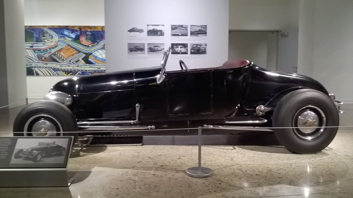

    Frank Mack's roadster is probably as good as you are going to get with cowl steering and split bones. Drag link end of the steering arm is close to the rear mount of the bones. Suspension travel, steering box ratio, and steering wheel diameter will all contribute to the feel when you are driving. Side steering is still in use in modern production vehicles.
