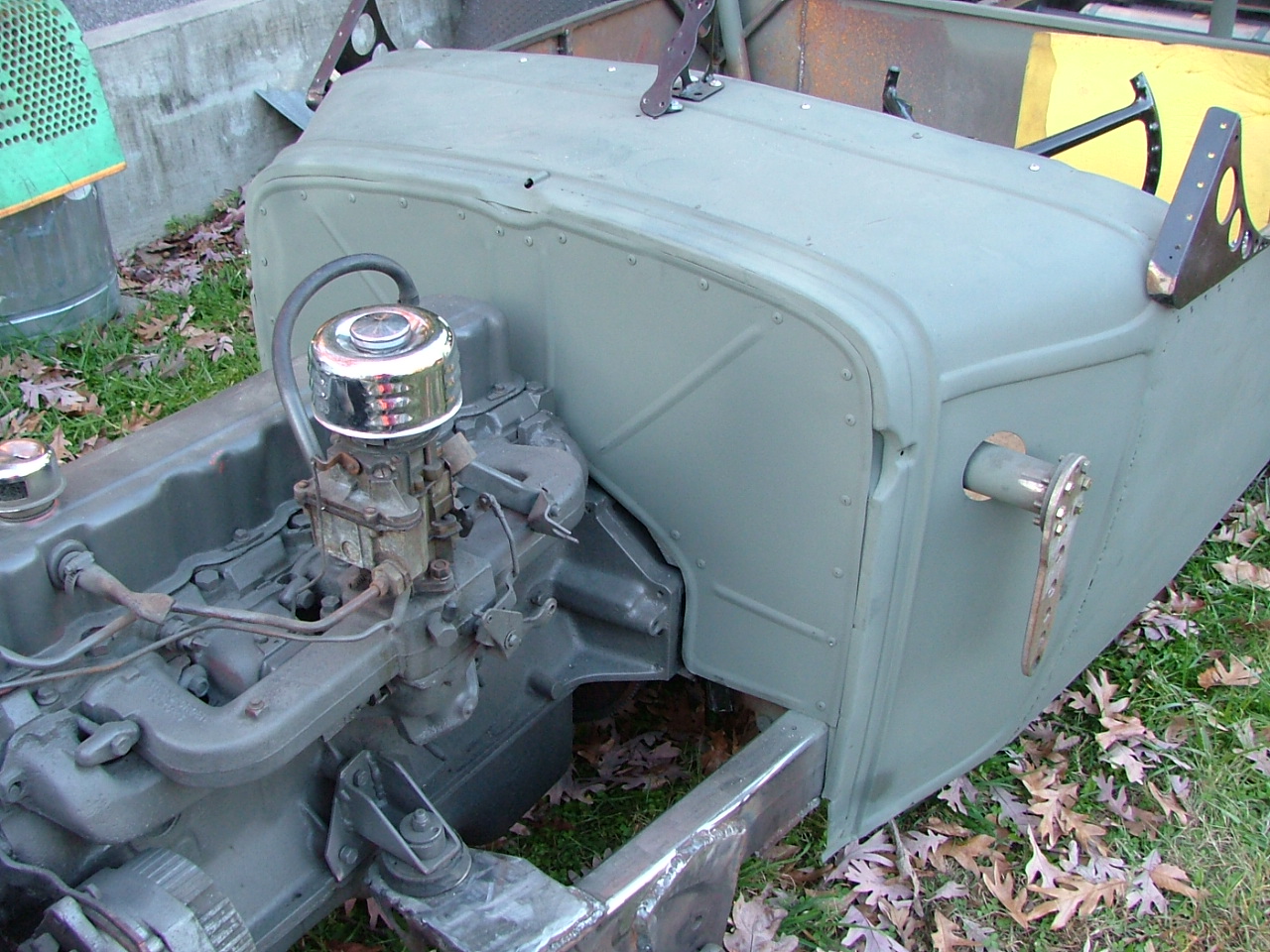

  9. I used a BMW 2002 steering box and made my own pitman arm.
    kidcampbell71 likes this.
  10. I used a box from a BMW, a '70s 2002. It worked grart for me, quick & simple. Found all the info right here on the good ol' HAMB.

    Early Volvo's used a box that is almost the same as the BMW one.
    They are made by ZF.
    Here is a picture of the one I used in my T roadster.
