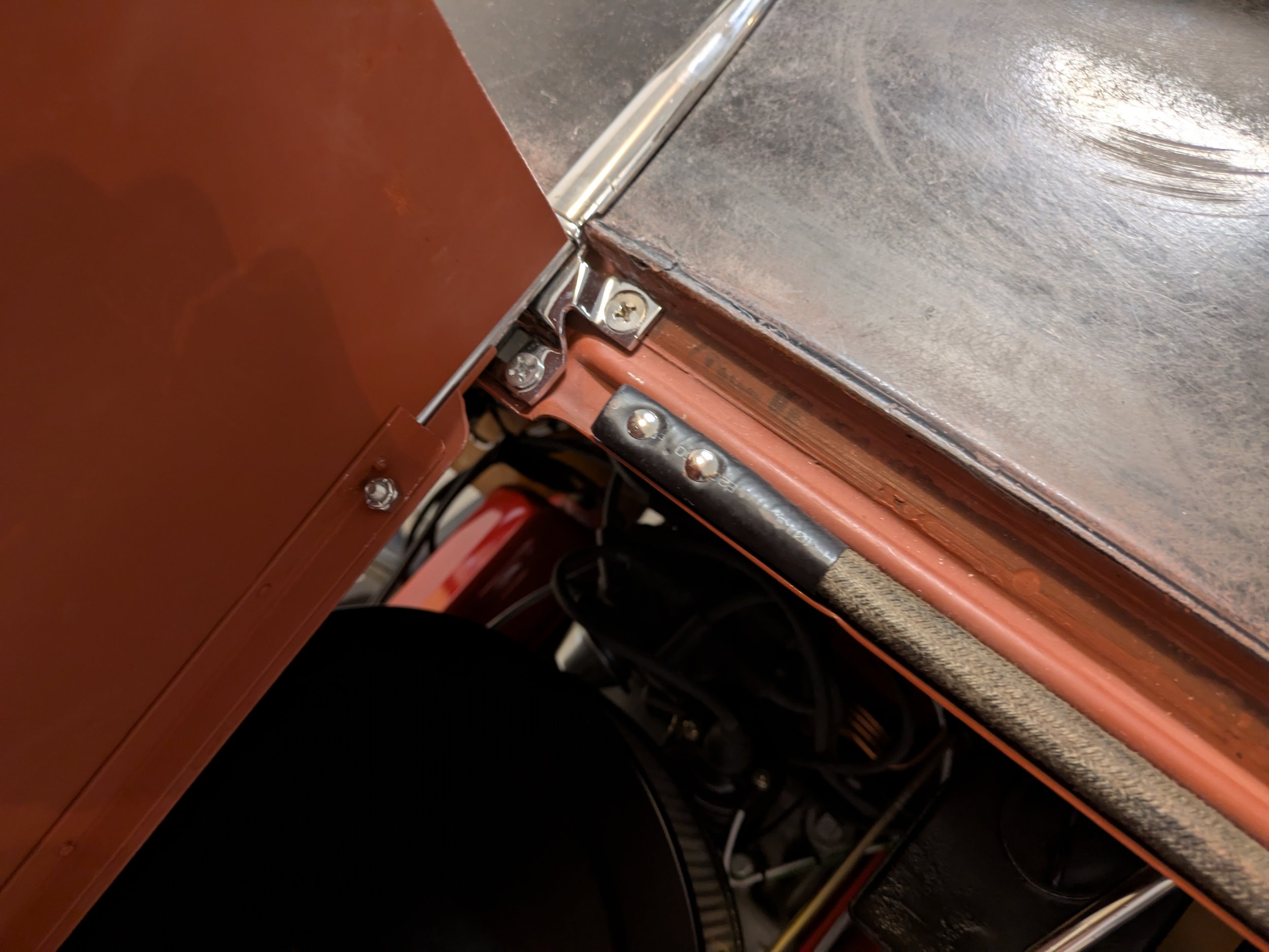

    Shrink tubing first, rivets next. No glue needed! Works great!

    I am liking the shrink tube idea. Use the gluey kind or like one of the professors on here suggested recently, slice a sliver of glue stick and add it to the tube prior to heating.
