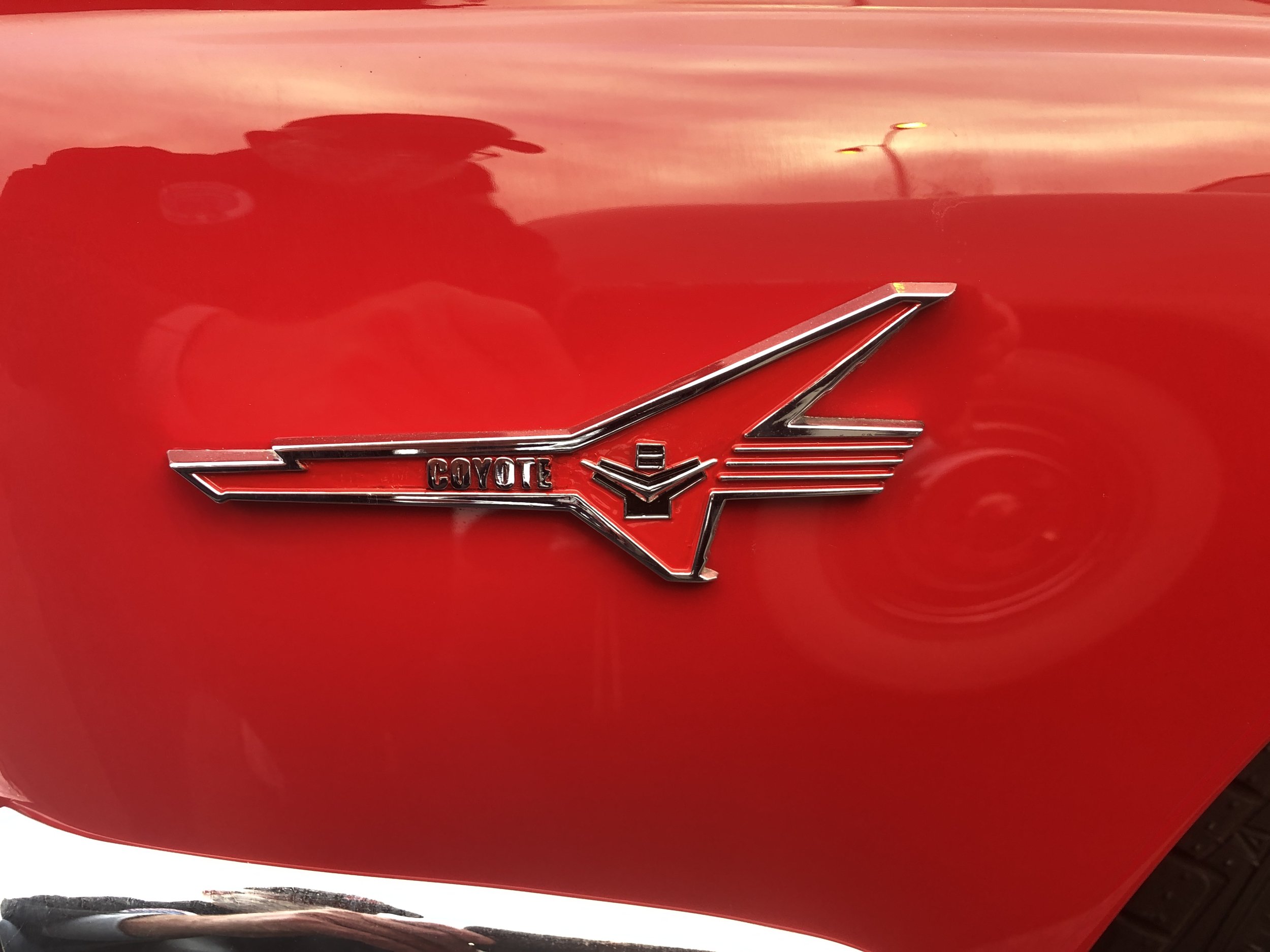

    The 56 Wagon with this side emblem replaced the entire chassis with an Alston. I have seen one other on that used the stock chassis but had pan problems along making his own mounts. They are very wide. The same exhaust manifolds are on both cars but the Birds have way more room. IMG_3242.jpeg
