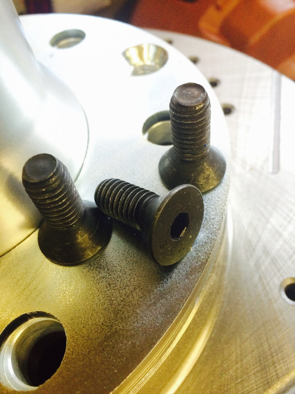

    Straight away I noticed the holes in the Hub are too small for the countersunk bolts supplied in the kit.
    The bolts supplied in the kit have a shoulder which sticks through the retaining plate.
    This means that the hub has to drilled out and countersunk for the plate to sandwich the hub tightly against the rotor.

    Here are the 3 bolts supplied in the kit.
    The depth of the shoulder of each bolt means they protrude through the securing plate.
    So without countersinking the hub the "securing plate" would just rattle loosely.

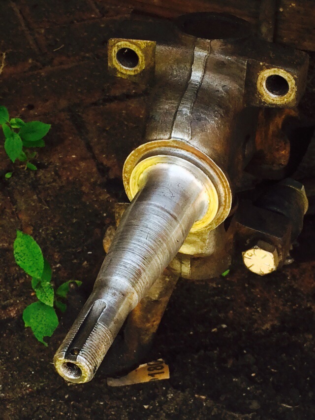

    Here is my spindle and back plate.
    Once you have removed the drum, and the shoe assembly this is what you will see. That's a 3/4 spanner I'm using on the front. On the back there is a castle but and split pin, remove the the split pin. Undo the nut. The bolt goes through some of the steering components, gently tap both bolts out.
    I gave them a good squirt of WD40 prior to disassembly.
    On top of the plate are 2 more securing bolts. They are not held in with castle nuts.
    Keep everything as you may need it later for reference.
    In this picture is a tapered bearing yours may not look like this if you have the earlier roller bearing type.
    I found that the best way to remove the bearing was to use 2 sturdy screwdrivers underneath the back of the bearing gently levering forwards.
    Often some people use just one screwdriver so the bearing gets cocked and can be more difficult to remove.

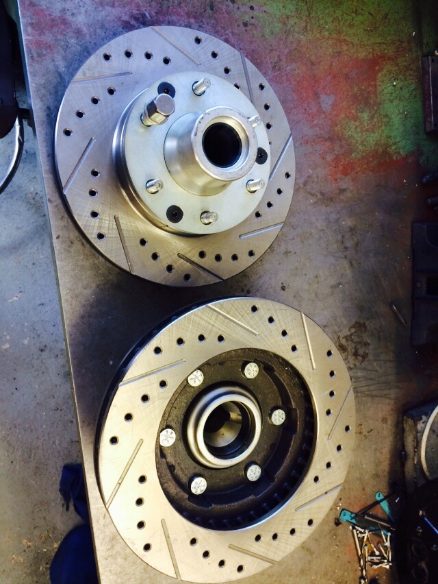

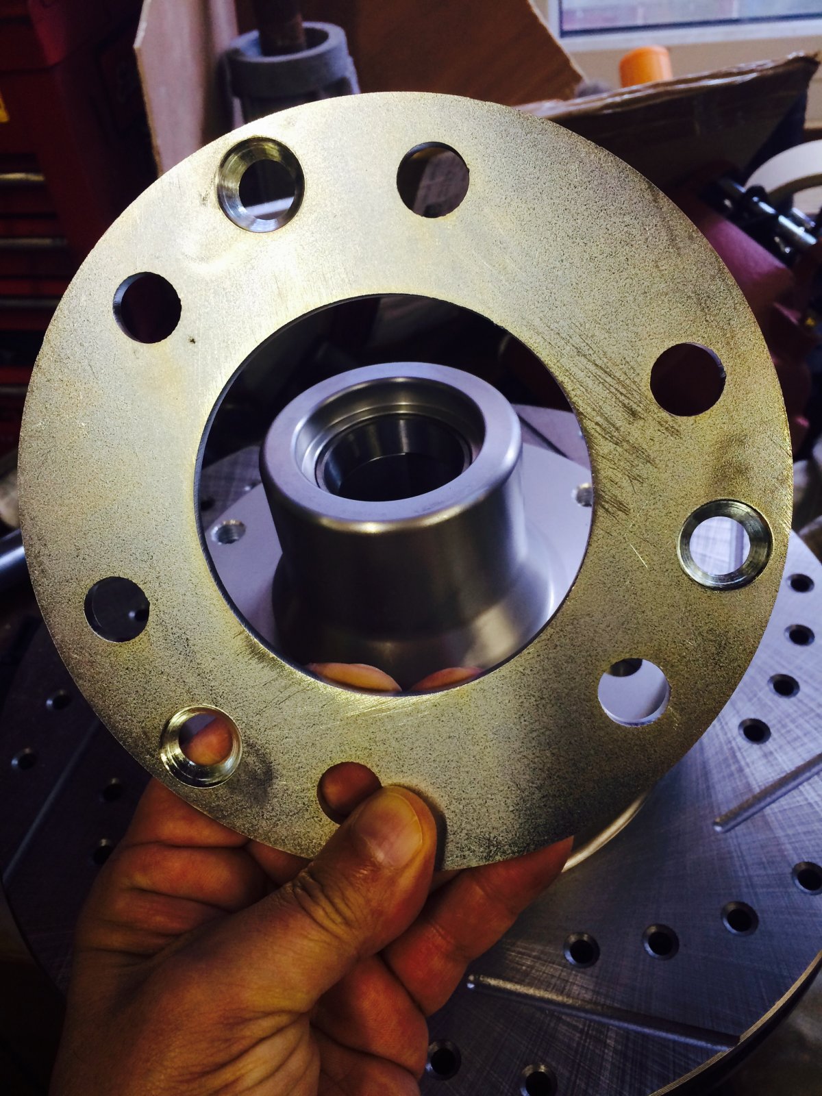

    image.jpg image.jpg image.jpg Update. I dropped the the Aluminum hubs at the machine shop.
    The holes drilled into the machined hubs did not line up with rotor holes.
    The solution was to make some Aluminum plugs. They were welded into the "new hubs" the holes were then re drilled and correctly lined up.

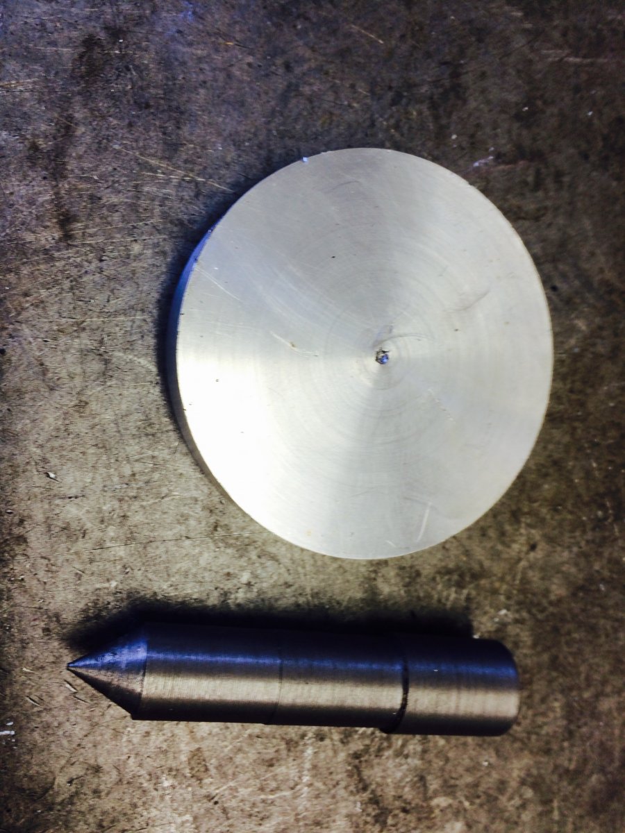

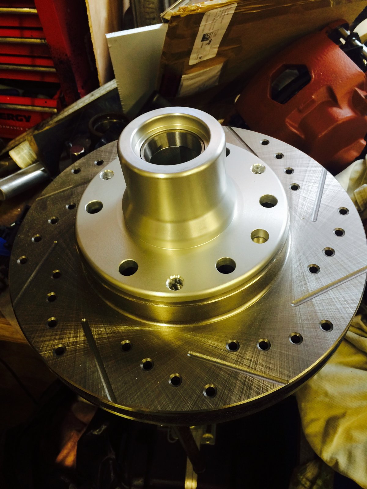

    A centered aluminum piece was machined. This gave us the exact centre of the rotor. We used this to then get the exact centre of the hub. The hubs were marked and accurately drilled.

    The lugs were then pressed into the newly drilled hubs and loctited into place. I assembled the rotors and new hubs.

    I cleaned up the spindles. Some 180 emery cloth works well.

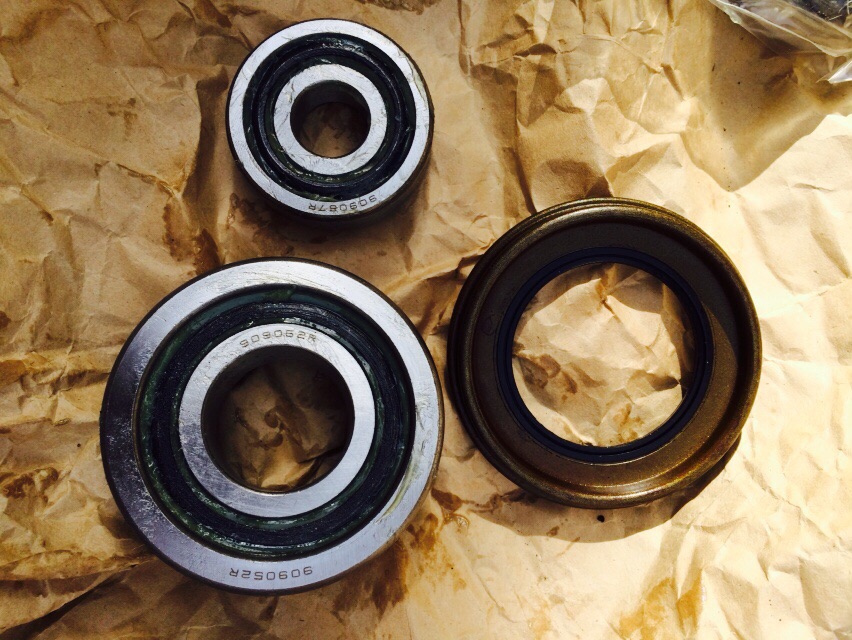

    This is the so called upgraded bearing.
    It doesn't fit

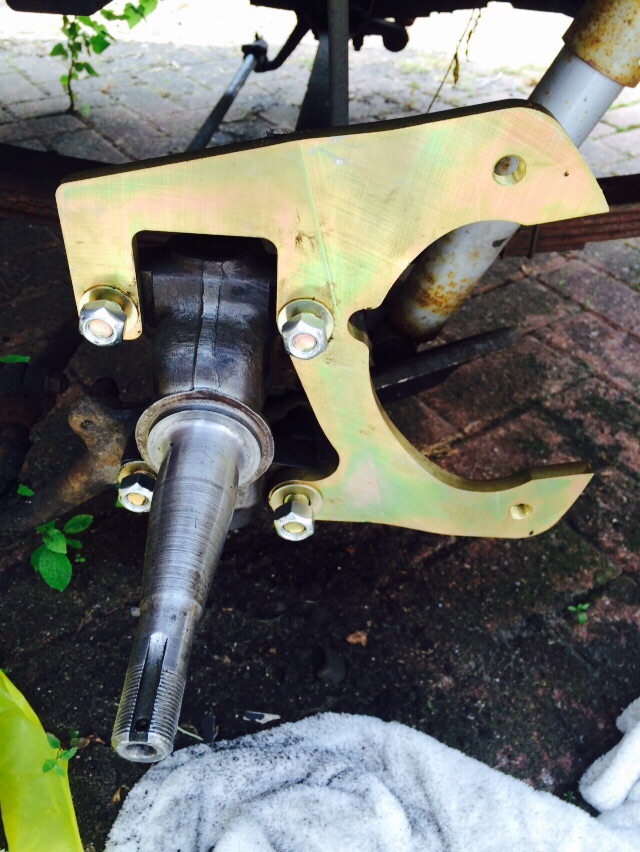

    I fitted the bracket supplied.

    image.jpg image.jpg Today I went back out to fit the calipers and rotors.
    I seemed o get everything to fit ...kind of...
    There's a lip on the calipers which hit the bracket. I filed off a few millimetres with a hand file.

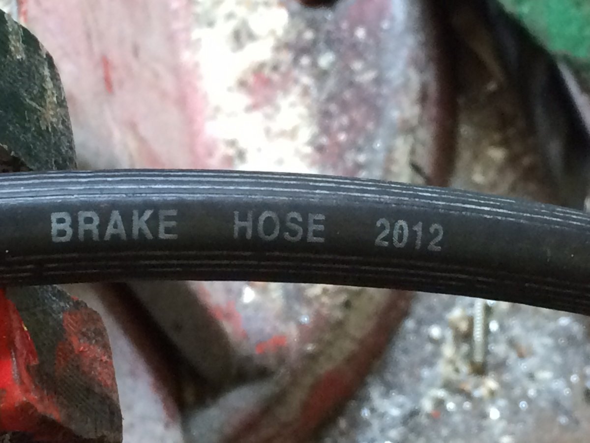

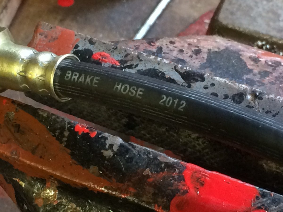

    image.jpg I ordered this kit in May 2015 from CPP.
    The kit includes brake hoses.
    Have a look at the picture of the hose supplied in the kit.
    It's stamped and dated 2012.
    Hey thanks CPP you've stiffed me yet again. I don't think there is any doubt about the date. They were made 3 years ago maybe. I'll have to replace them.

    1 pair of replacement brake hoses $80.00
    I pair of steel wheels $160+
    I can't wait to get started on the CrPP bolt in brake booster and master cylinder.

    A family member is having a disc conversion update on a 57 Caddy, it's ok though as the kit didn't come from CrPP.
    The kit comes with some spacers about 1/4 inch thick, no biggy as such IMO, anyway I've ordered a pair from a well known internet auction website. For about $15.00 bucks. I am going to try these before I commit to the new wheels.
    I'll let you know how I get on.
