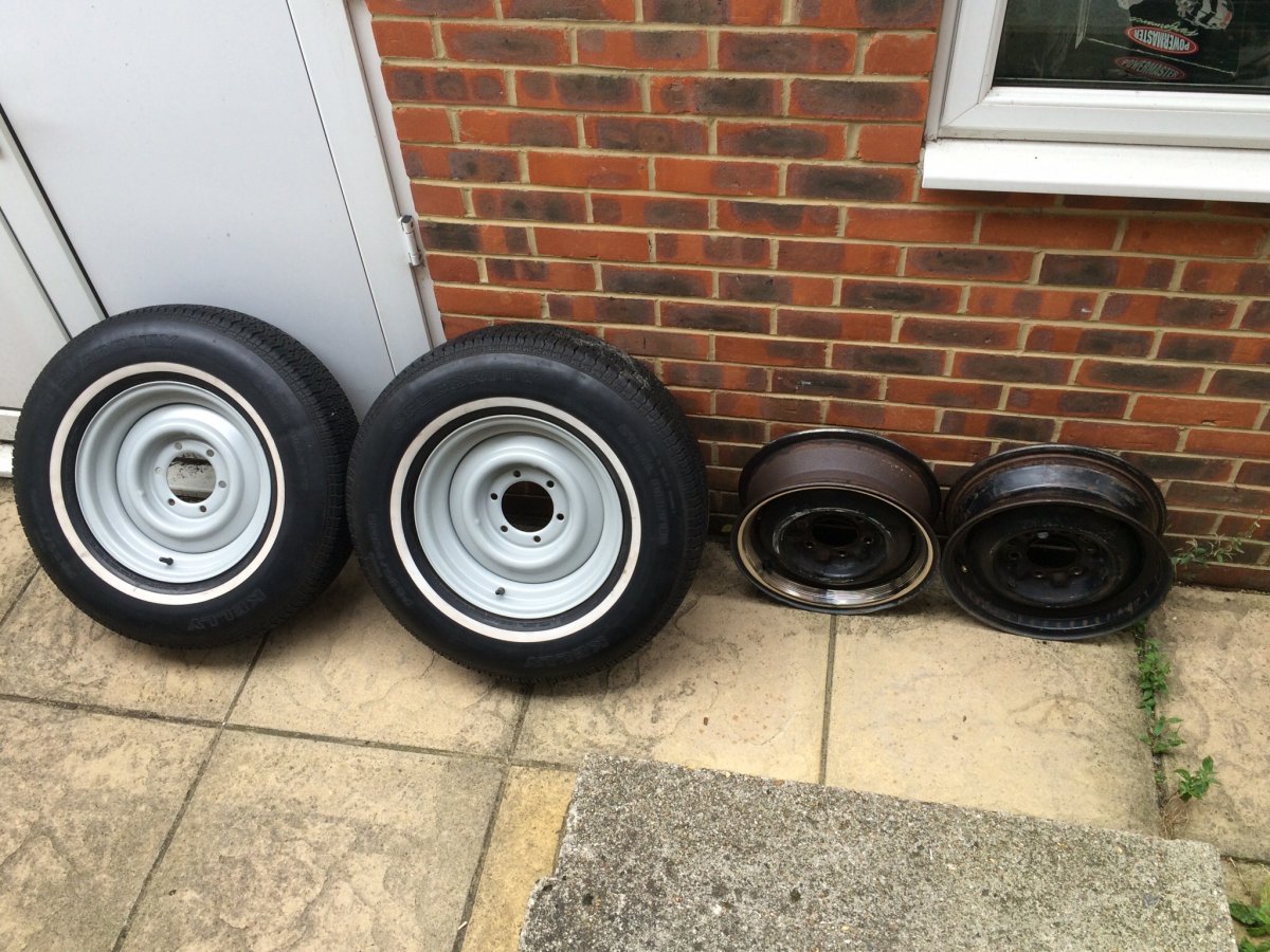

    image.jpg The spacers arrived!!
    They look ok I guess they are made in Taiwan ...
    I tried one spacer 1/4 ... No luck wheel still hits on the caliper. I tried both spacers so 1/2 inch in all still no good.
    I'm going to order up a new pair of wheels from Jegs a company I've used before. They do an online price match which is brilliant. You find your product as cheap as possible post in the URL or company name and price and they will match it!! image.jpg

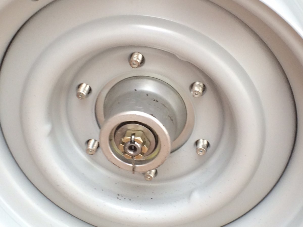

    image.jpg image.jpg image.jpg image.jpg image.jpg image.jpg image.jpg I ordered up 2 new wheels from Jegs on Thursday and and they arrived on Monday great service guys many thanks. $59.97 each.
    These are 15 x 6 - 6 studs on a 5.5 Pcd
    Because they are welded together not riveted they fit perfectly, I'll use my old tires until I get everything else sorted out and ready I may get some wide whites later.
    The wheels have a really good quality primer on them they look almost powder coated. A great base for paint or powder coating later.
    I ran the new rims to the local tire place they swapped out the tires and fitted new valves for under $15
    Here's a few pics image.jpg image.jpg image.jpg image.jpg image.jpg image.jpg image.jpg image.jpg

    The original steel wheels, the black ones on the truck in the first picture, do not fit the front now because of the disc and calipers. I bought 5 new ones from Summit racing, I love Summit they are the best!
    They are wheel Vintiques. Really well made, lazer welded and have a slightly squarer internal shoulder, because of this they easily fit over the disc and calipers I have fitted on the front of the truck. I had them powdercoated in a tarty red colour. I did quite like the Vintiques semi gloss grey primer though.
