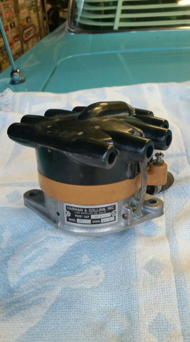

I have a stock (for now) 39 tudor. I want to ditch the stock distributor for the later crab type. As the 39 style coils just are not available. The car is 6 volt and I have the opportunity to buy the harmon and colins 6 volt one pictured one. I understand there is an adapter available to make it fit. Does anyone know where to get one? Sent from my SM-T805Y using The H.A.M.B. mobile app

We stock both types adapters if your buddy doesn’t have them. ***uming you have the 3 bolt timing cover, and the stock 39 camshaft, this is the adapter. It will move the distributor out front by an extra 3/8”. If your motor has the shorter 42-48 camshaft, you’ll also need the spacer ****on. http://www.vanpeltsales.com/FH_web/igntn-partsprices-pg1.htm

On the Harmon & Collins dizzy, make sure that the middle spacer (orange part) and the rotor are good. Those parts are difficult to find.
