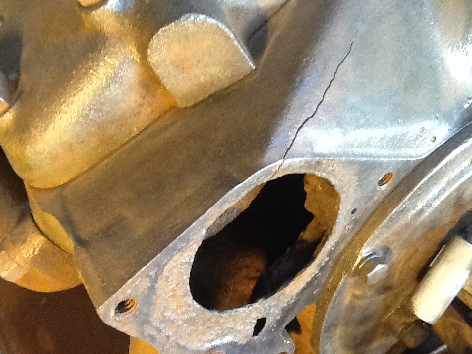

    I picked up this 42 motor complete and at the right price .after a good clean-up I found this crack .Metal around water is a bit thin also .will metal stitching fix it.
    Cheers.big jee

    If you haven't done it, I would take all apart to inspect the complete engine.

    Looks like a frost crack, there will be more somewhere.
