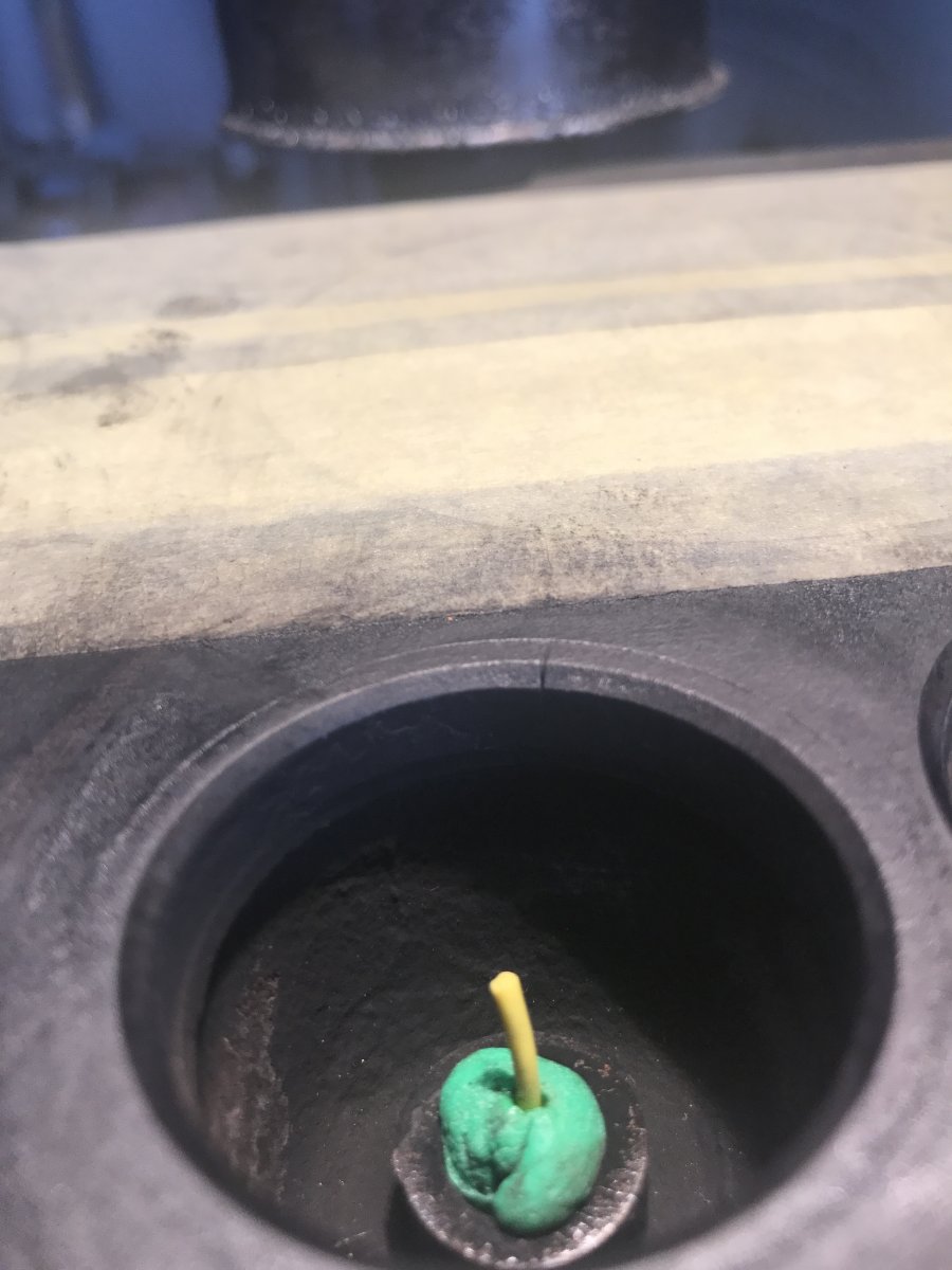

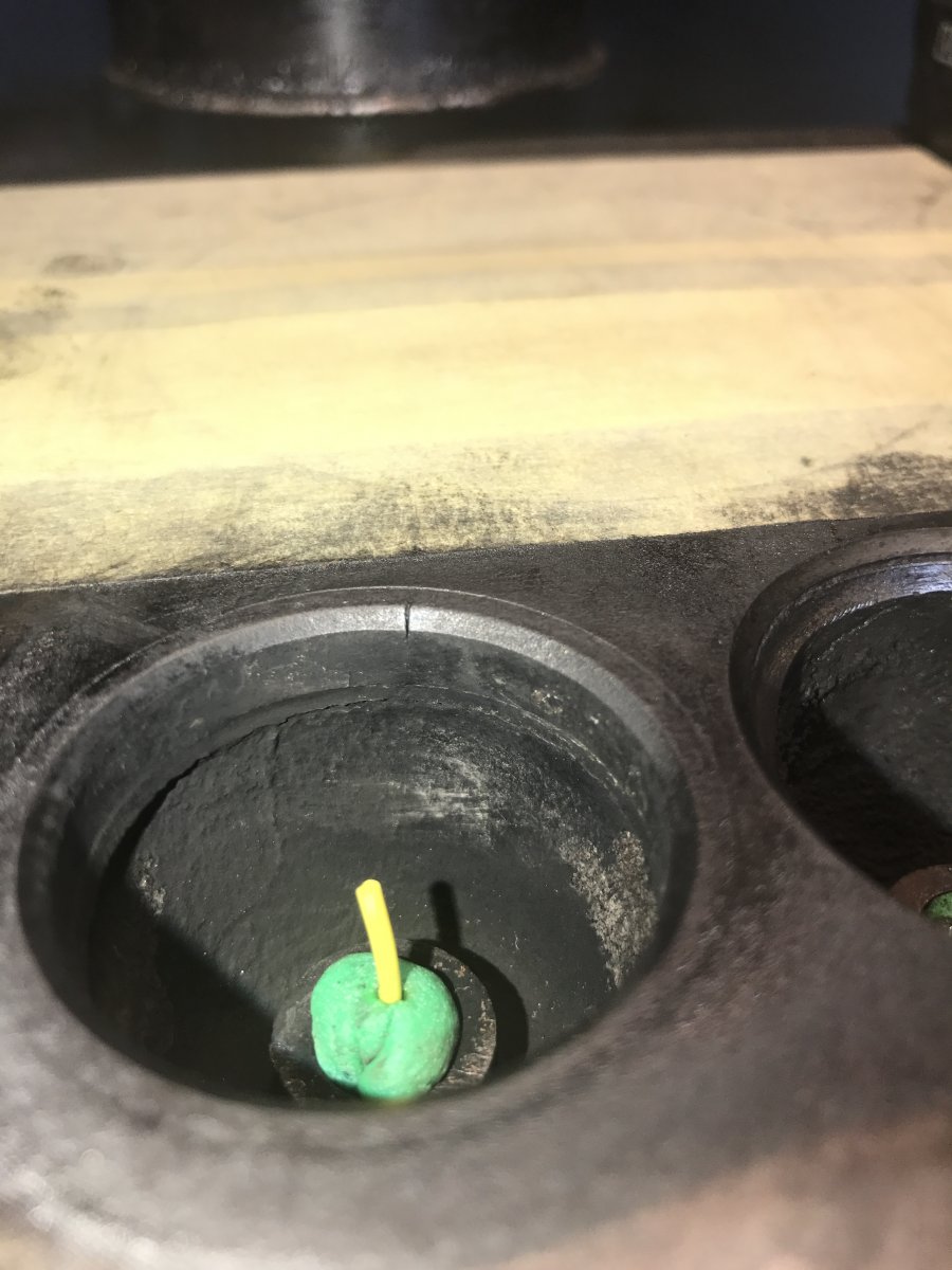

    IMG_7984.JPG IMG_7988.JPG wondering if anyone can recommend a machine shop local to San Gabriel Valley California that would be able to repair a cracked mopar flathead six exhaust valve seat.

    That would be SOP for any machine shop.

    Replacing a seat should be no problem for any machine shop. Use a hardened seat when replacing.

    Find an older machinist, He should have the tooling to come out and fix/replace that in the car. Most garages had the tools to do it in the car in the 60's.

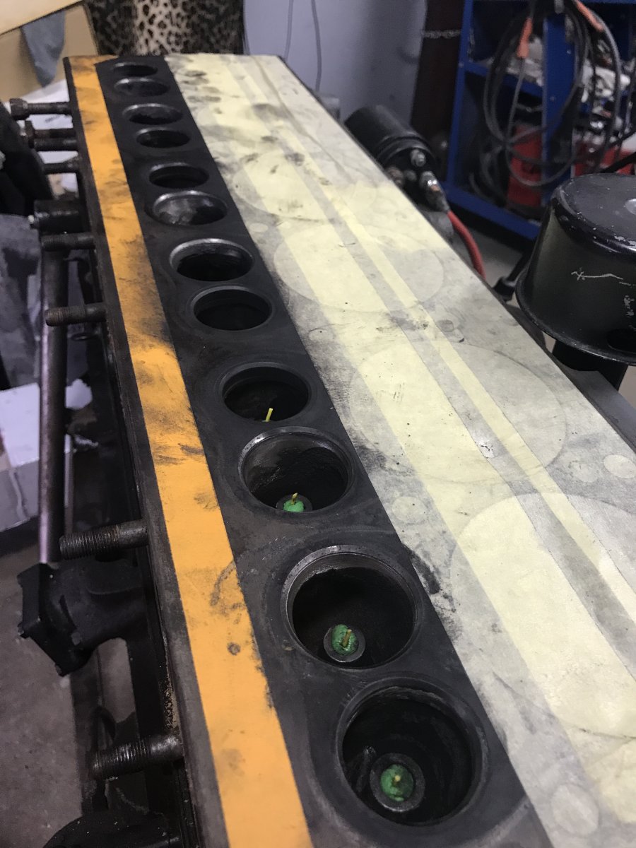

    IMG_7989.JPG IMG_7990.JPG I was thinking of attempting with this?

    If I'm not mistaken all the pics shown are for resurfacing valve seats. That seat needs to come out and be replaced, using a special driver guided by a valve guide arbor insert. Getting the old one out is usually done by welding on it such that the subsequent cooling of the metal shrings it so it will fall out.
    It is also possible to bore the parent head material for a larger OD seat if required.
    If it was mine I'd do them all and be set for life. The adjacent seat has a huge amount of valve seat recession and also needs replacing. And replace the guides too. Maybe even install bigger valves.

    Thank you for your input. The adjacent seat is from the intake valve and I notice it does not have a ring on them like the hardened exhaust ones do. I will be taking it to a shop nearby tomorrow and see what they recommend.
