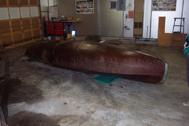

    The first time I saw the boat,<p> [​IMG]

    Wow! I'll say. Looks good Matt, nice job. Yeah, when do you sleep?

    Thanks for sharing the before pictures also, that puts your project all in perspective now...You did an awesome job!!!:cool:

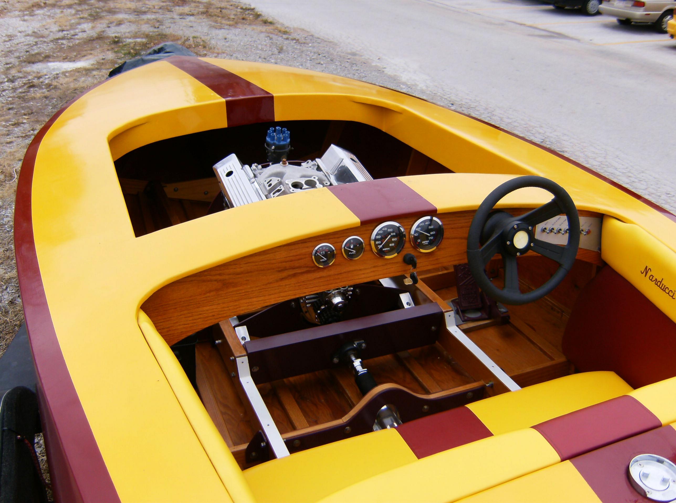

    Here's one I built from Glen-L plans
  18. narducci
    Joined: Jan 3, 2008
    Posts: 194
    narducci
    Another picture

    Very nice boat, narducci. I don't know much about auto powered inboards and have always been curious as to why many of them have the engine turned backwards and drive the prop off the crank snout?

    The oil sump on a SBC is in the back. You cant get the motor low enough for a good driveline angle.
    Also on the race boats, the torque helps with the way they turn on the course
