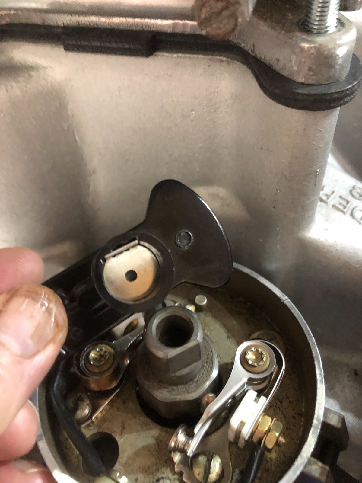

    A very good friend of mine is building his 427 Hi-Riser and has been collecting for a very long time.
    Nearly complete, he has hit a snag and is looking for info.

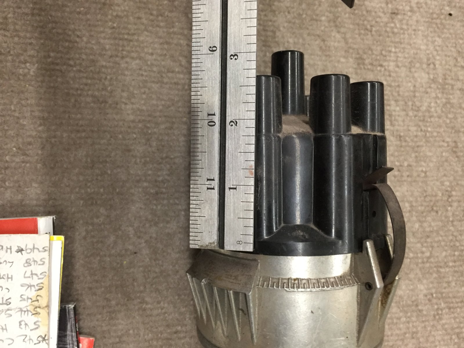

    The original cap n rotor are long gone... he has a cap and rotor but the cap is far too tall and the rotor is about 1/2 inch too short.(within the cap)((Also getting very close to the front carb and installation of the wires in that area is becoming impossible.)) I ***ume a shorter cap and rotor would be ideal.
    He has been searching parts houses.. but unfortunately.... a good parts person is becoming so very scarce.
    Obviously Cragar has been long gone for years..... but I was wondering if anyone has info or possibly another cap and rotor that may fit?
    The Diameter of the base(cap) is 3.375.
    Any suggestions would be extremely helpful.
    Thanks guys.

    Is the distributor for a Hi rise different than a standard FE? An 8 lobe dual point is not particularly significant in todays market with all the electronic models available. I think Pertronix makes a pretty stock looking dist. with vacuum advance for an FE. If you can't find a cap and rotor this might be an option.

    My cap is 2 3/4 tall ED48BF90-B709-4285-8B28-916627A3E055.jpeg
  6. My suggestion is to start looking at older stuff such as Y block parts for a cap and sometimes a 6 cylinder rotor. I found out that seldom did they make their own parts without copying something readily available. I remember seeing rotors with a flat to drive them but can't remember on what. Did I mention I'm old and have little memory? :) Most besides GM used the 2 straps to hold the cap on. Because the little Dodge hemi had dual points, that might be a place to start looking.

    @Jeff Norwell if Marks uses a common Chrysler cap I have ALOT of them if you need a quick measurements. The caps and rotors are the same big or small block for a couple of decades!!

  8. The 1954 Dodge 241 rotor is the same shape. I don't have any dimensions for it.

    The Chrysler stuff also fits Accel distributors. Plus I don't know about the stuff today but years ago the Accel rotors would break without warning.

    The cap and rotor are Mopar parts as I stated above in post #4, for anyone that cares the ignition points for these are standard ignition FD8081 they are from Ford 6 cyls from 48-64
