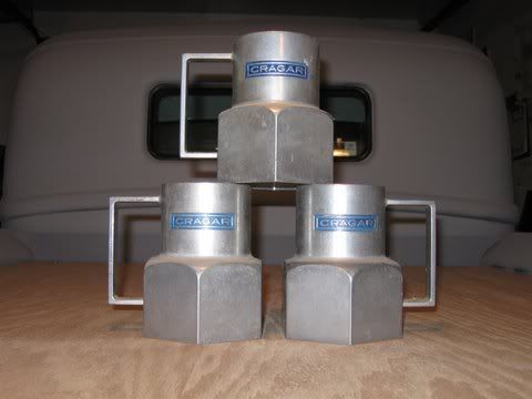

    now i have to ask this?
    how many have the Cragar Lug Nut Mug that came with a set of wheels?

  8. 40streetrod
    Joined: Nov 11, 2007
    Posts: 477
    40streetrod
    from nj
    here are the Cragar mugs.

  10. Yep, I bought one of those mugs 3 years ago at a garage sale for 10 cents! It now rests on my workbench, holding pens, a small flashlight, and a tire gauge.
