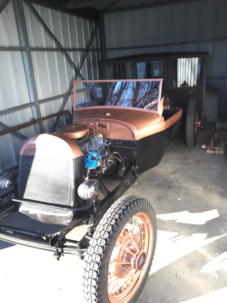

    Well put the roadster up for the winter.[emoji19] when spring rolls around I'm going to pull it out and change a few things. New shocks in the front and maybe new wheels and tires. Fits in there nice with the T.[​IMG] [​IMG]

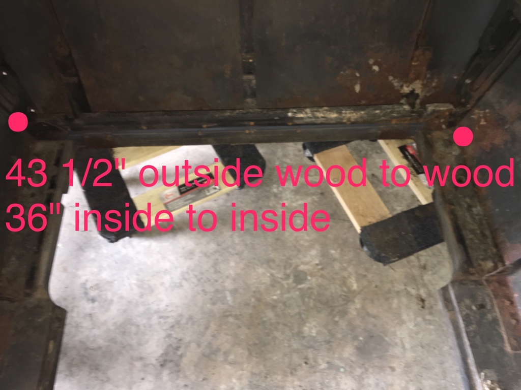

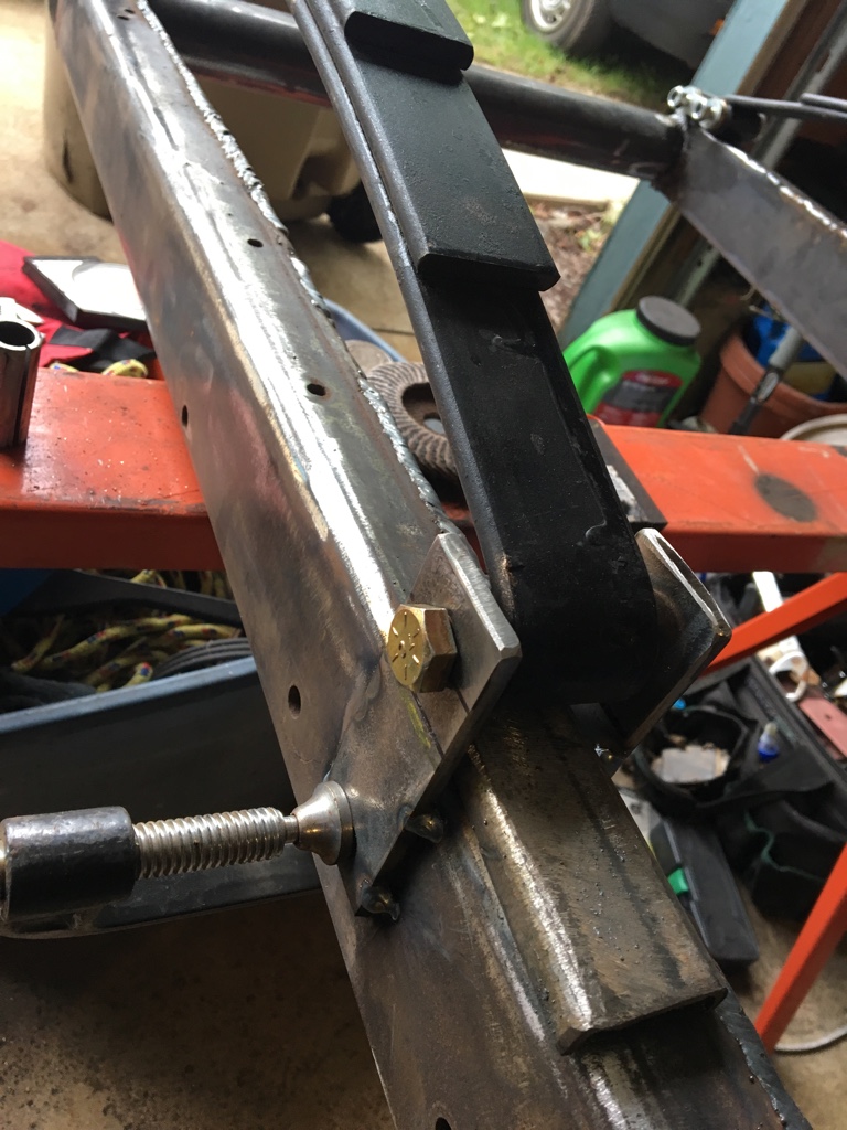

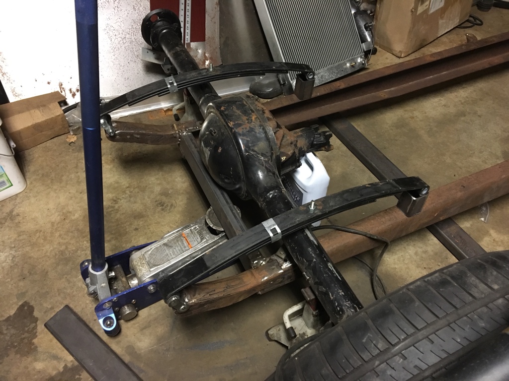

    Really like that Fordor, there are aftermarket brackets inside the rear crossmember of that stock frame, they may be for some type of shock absorbers. Bob

    How long is that T frame? On second thought it may be a TT truck frame. Bob

    Ok, That explains things, they used two short leaf springs not a single style like the cars, you just don't see a lot of them. g\Good strong ch***is should work well for you. Bob

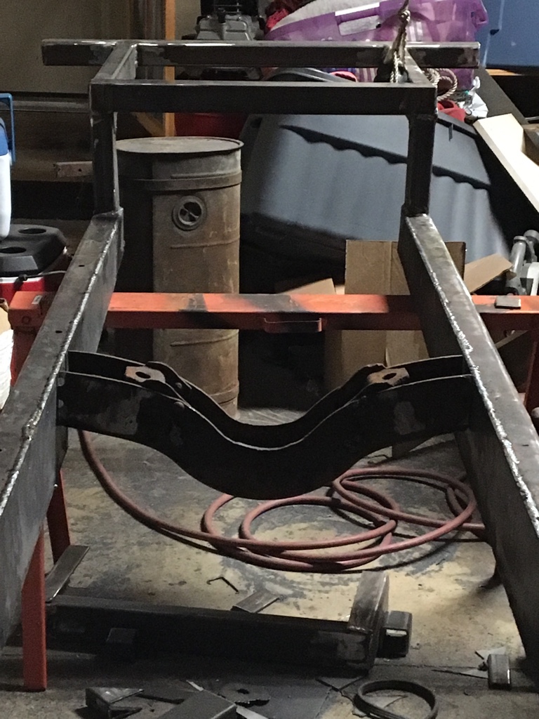

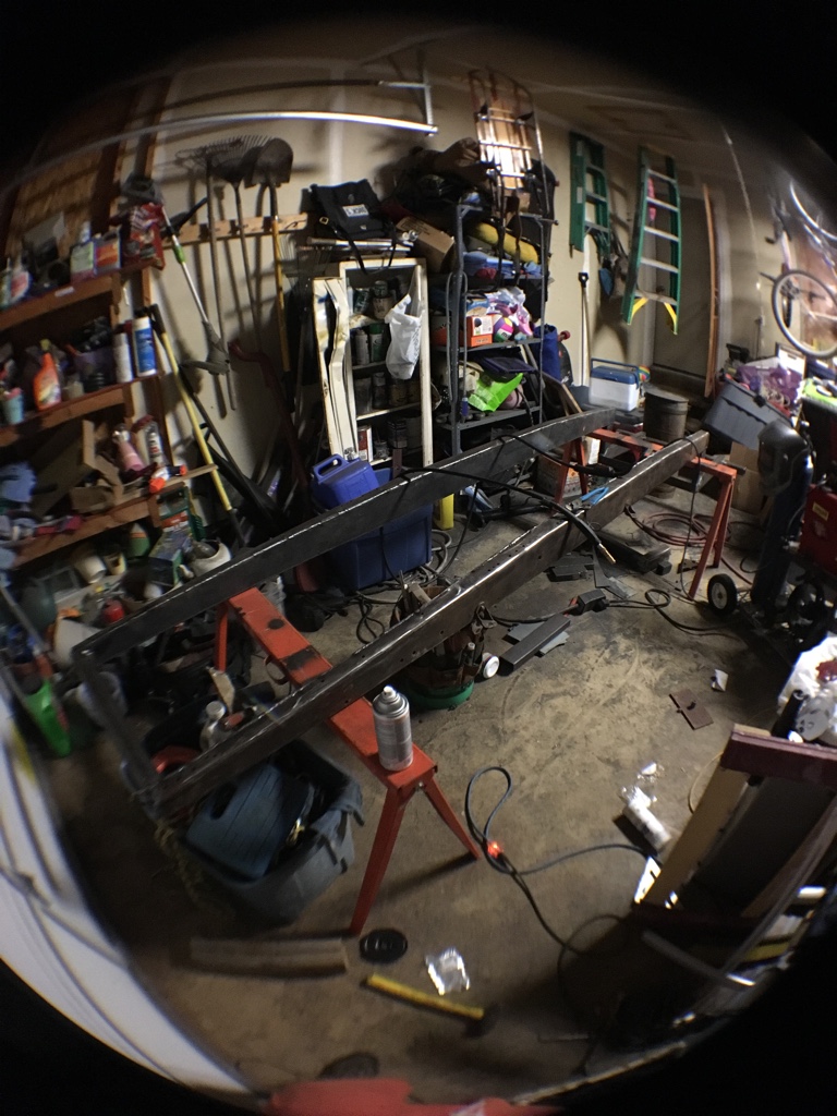

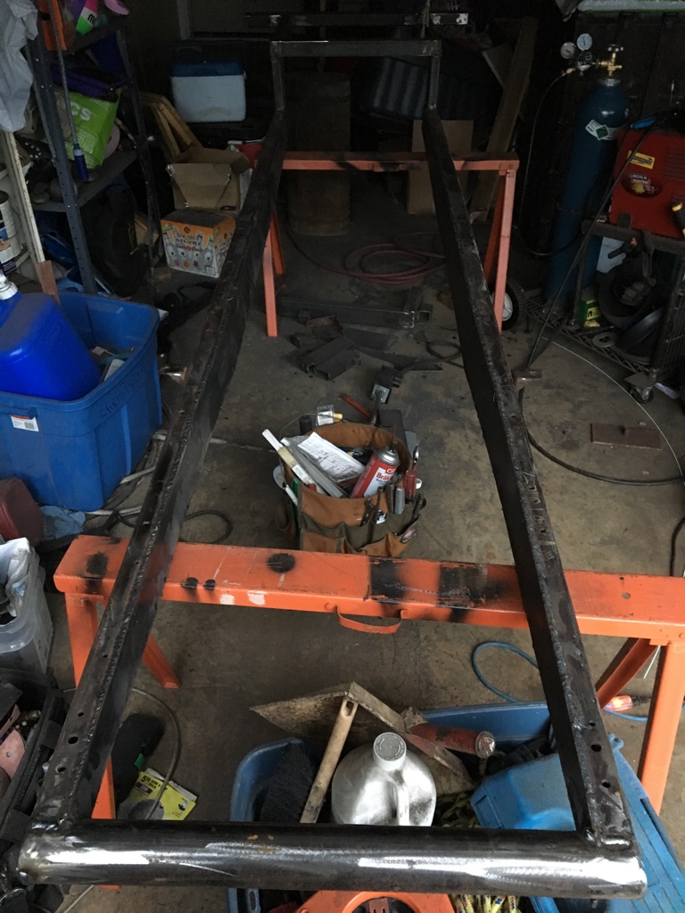

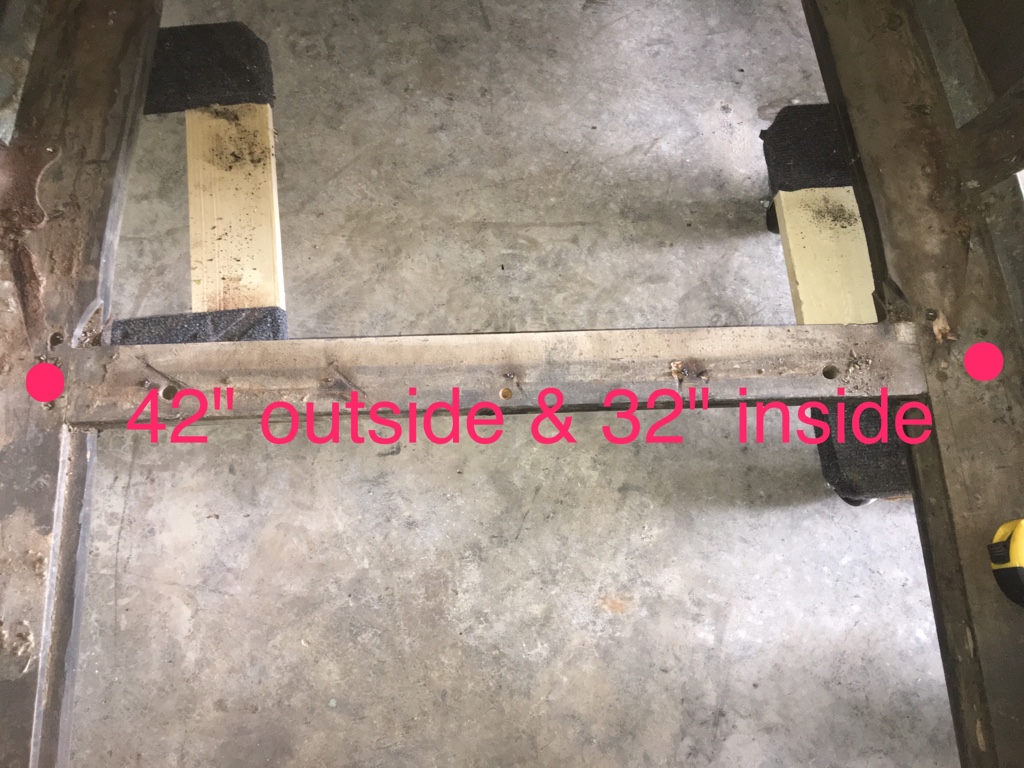

    Little by little. Started mocking up the ch***is. I have recycled brackets I cut off the TT frame. Can you tell what I did? I cut the front crossmember in half to create rear frame horns/extensions for the leaf springs. I'm still in the planning stages. So far so good. [​IMG][​IMG][​IMG][​IMG][​IMG]

    So I am second guessing the underslung rear suspension. Thinking of kicking up the frame and going coils with ladder bars or four link. I picked up some 195lb rate rear springs. I'll set them on there and stare at them. My plasma cutter is supposed to come today so I am pretty excited about that. Looking forward to not using a ton of cutting wheels all the time. Although since I splurged on good cutting wheels instead of the cheap ones it's been working well. :D Took some measurements the other day inside the body too. went and picked up 5x3/16" strap for boxing the frame and some 1 1/2"x1/4" strap too for misc. stuff. Since the body will not be channeled I am widening the frame. it will follow the parameter of the body. about 1/2" to the inside kinda how it would look as if it was on top of a 34 ford frame. That's all for now. It's my wedding anniversary (16 years) so the wife and I are headed to Door County for the weekend. I'm trying not to think about the stuff I could buy for my car with the money we are spending on this weekend. Don't tell her I said that! HAHA:D

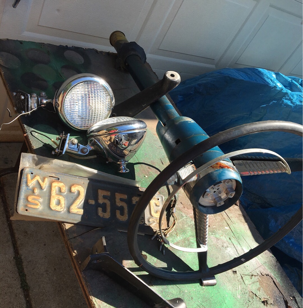

    Took some measurements the other day for frame mounts too. And crossmember stuff. Also picked up some cool stuff at the Jefferson swap meet. I'm like omg the steering column. The headlights I may or may not use. I'd prefer the big 9-10 inch ones.

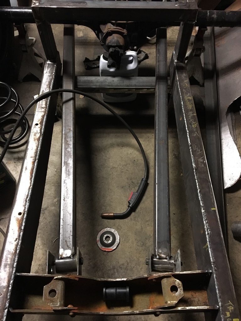

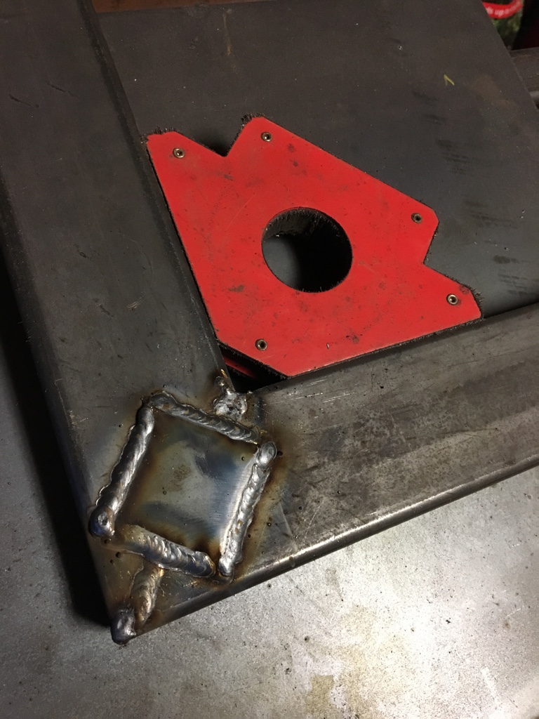

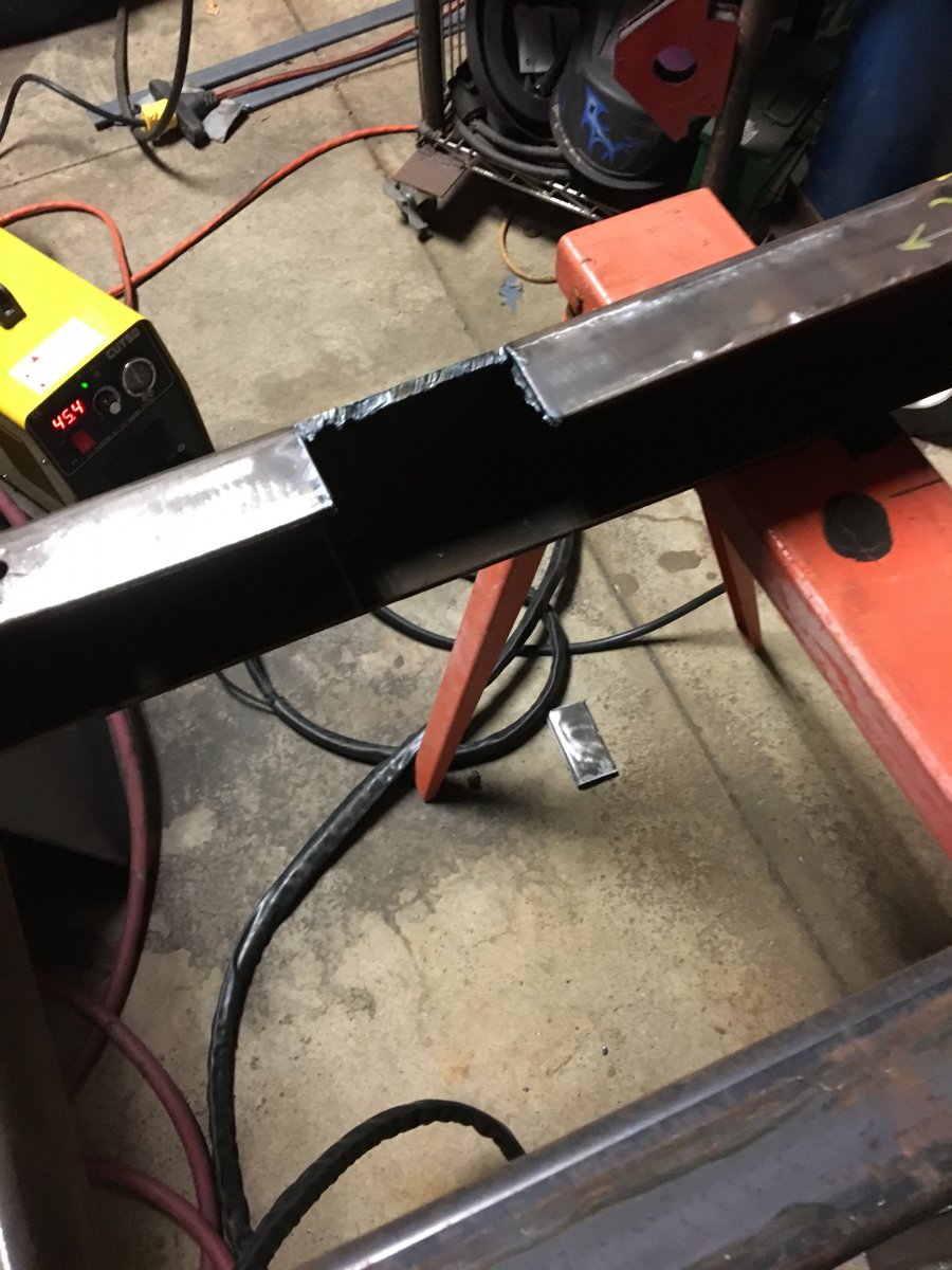

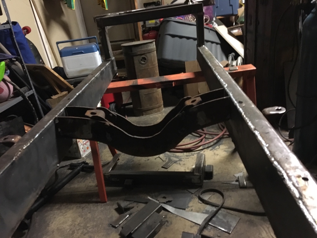

    So tonight I worked on the kick-up. It turned out well. Everything is tacked into place solid. I still need to cut off the excess frame in the lower side. Then I will finish welding everything. It too a while since I double triple and sometimes quadruple checked all measurements. It's all square and level! I will work on it some more tomorrow. I need to clean up some too. I get this rolling and I'll bring the body home. In trying really hard to make that happen before the snow falls. I was suppose to go to a car show swap this weekend in the Oshkosh but the rain is pretty bad. The temps don't help much either... can't wait to set this on the axles hopefully get at the front spring mounts tomorrow too. Night all!

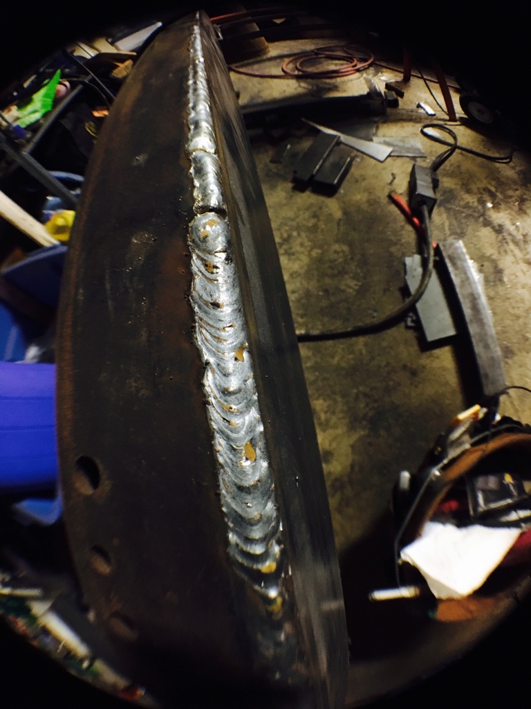

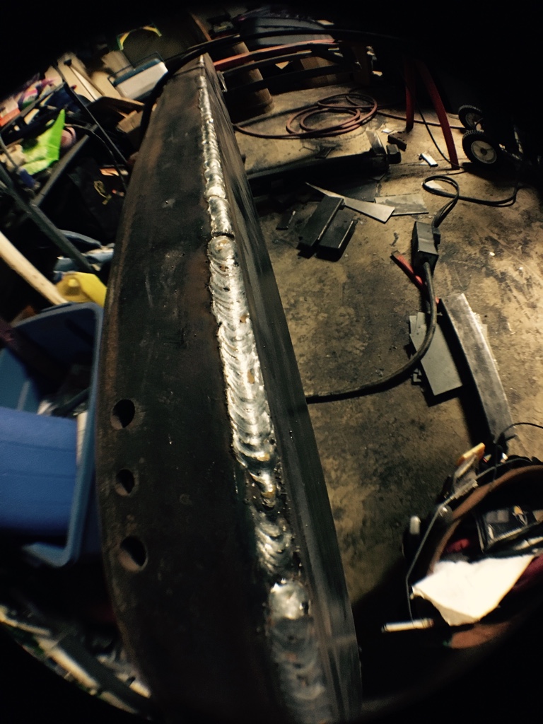

    Did some welding tonight on the frame. Was welding boxing plates. And then I broke my welder... Long story but wire is jammed like a mofo and I was almost done too... So I ordered a new torch feed line... Be here Tuesday if all goes well. [​IMG][​IMG][​IMG][​IMG][​IMG][​IMG][​IMG][​IMG][​IMG]

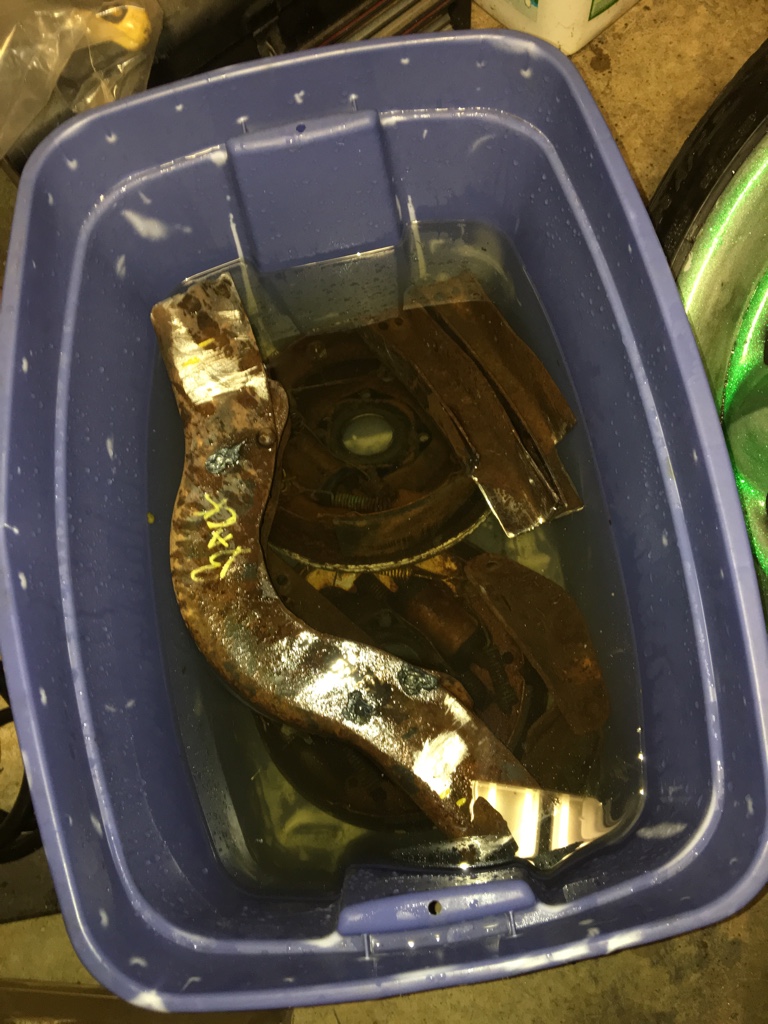

    The frame is boxed. It's my birthday and I'm sick... Fixed my welder and prefit a crossmember and started soaking rusty parts in vinegar. If you haven't tried using vinegar for rust removal you should. It works. Put it in a tub and let it soak. Takes a few days so just get comfortable. Hopefully tomorrow I'll feel better and get some work done.

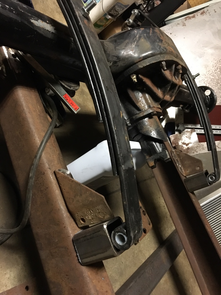

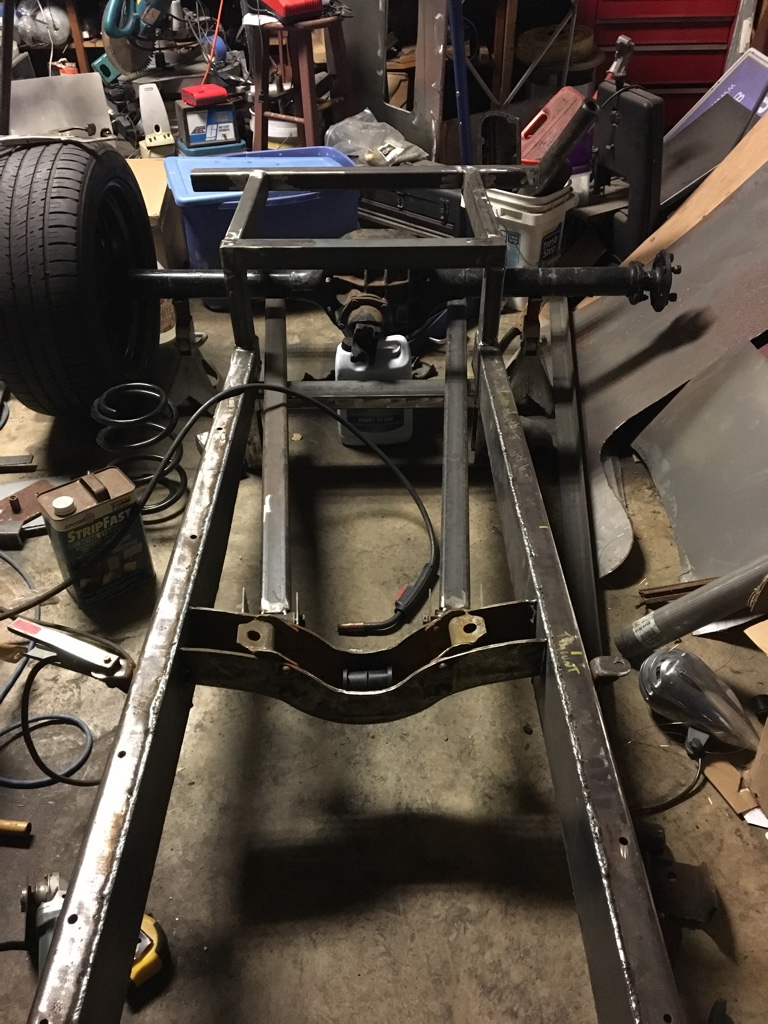

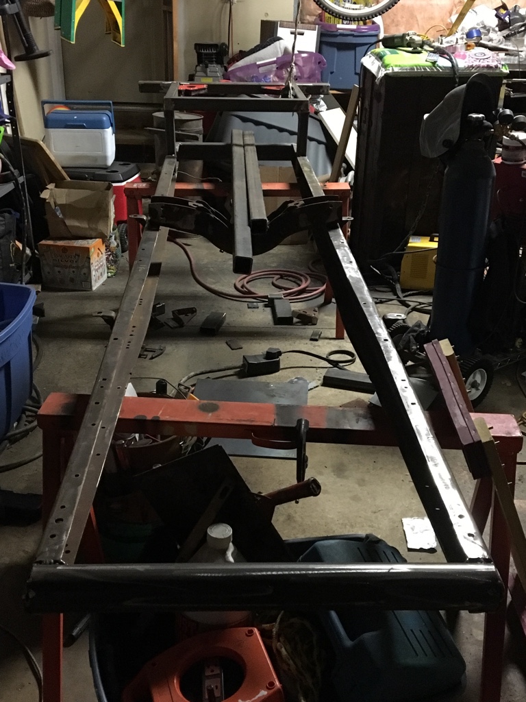

    I AM NOT USING THESE WHEELS. That said, they are just for mock up. They are the correct height for the rear but the fronts will be smaller.
    I didn't get as far as I had hoped. I got sick... That ****ed.
    Anyway this is it for now. The front is just sitting on the springs. The rear suspension is obviously not done and only tack welded.
    I need to order different coil springs for the rear. Other than that, honestly will this work? Basically it's a truck style. So the arms will be attached with U-bolts. There will be a panhard bar as well.
    Thoughts?

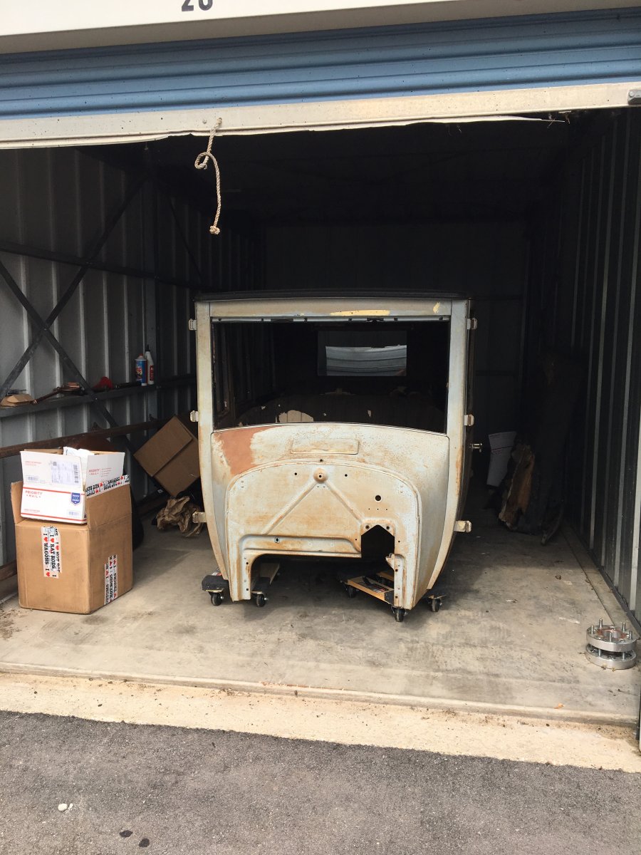

    Not much to tell, cleaned up a bit in the garage last night. The floor needed a good sweeping for sure. Pulled a bunch of stuff out to trash and cleaned then moved stuff I was keeping back in. I have too much stuff. waiting on parts from Speedway to arrive. Should be Thursday or Friday. If all goes well, should be rolling THIS weekend :rolleyes:... AND the body will be home to set on the frame.
    I will be building the giant moving cart for the body this week too. I bought BIG castors for that. My project will be sharing the garage with my wife's car for the winter. That means constant jockeying of cars. It's gonna come real quick.
