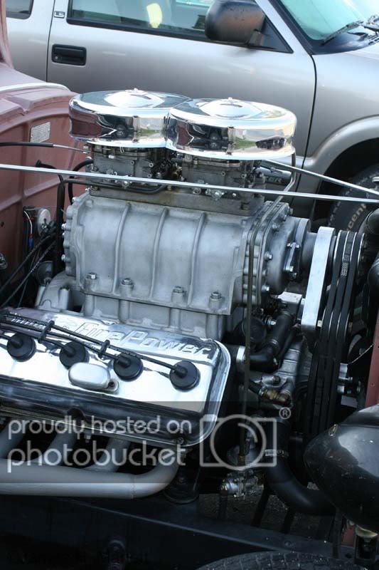

  11. alex1954chevy
    Joined: Apr 13, 2008
    Posts: 256
    alex1954chevy
    Seems to me that if V belts could run safely without a damper, then there wouldn't be dampers on most engines?
    You bring up a very good point.
    I know i saw this picture somewhere here before. Guys running a v belt drive on a 6-71. Anyone know who this is?

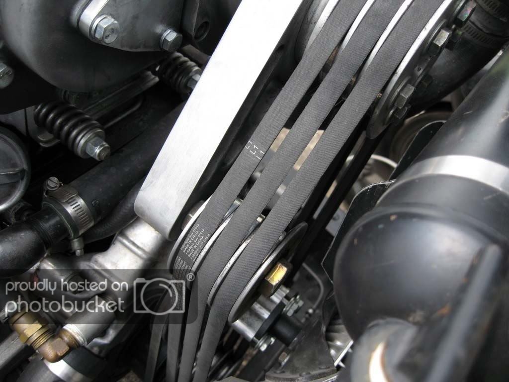

  12. alex1954chevy
    Posts: 256
    alex1954chevy
  13. flamedabone
    Joined: Aug 3, 2001
    Posts: 5,711
    flamedabone
    I had about 80K miles on my blower with a hub only when it did this;
    BUT, it would have most likely done the same thing with a balancer. This was a stock 60's Pontiac crank that had the radius ground a little sharp once upon a time. Stuck a new crank in her and she has been fine ever since, and that was 2012.
    Keep us informed and post lots of pics.
    -Abone.
    PS. Squirrel is one of the few of us that have clocked more than 100K miles with a roots blower, so pay attention to him.
