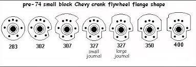

  7. A picture is worth a thousand words,,,,,,and a good diagram helps also ,,,,LoL.
    Definitely a 400 flange !

  9. squirrel
    Joined: Sep 23, 2004
    Posts: 60,070
    squirrel
    The diagram shows the 400 flange being more square on the weighted side. The only difference between the diagram of the 350 and the flange you have, is the small notch. Which could be how your crank was balanced.

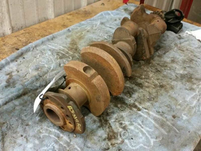

  13. squirrel
    Posts: 60,070
    squirrel
    here's a pic of a similar crank on ebay,, same number, it's advertised as a 350 crankshaft.
    The notch is there....
