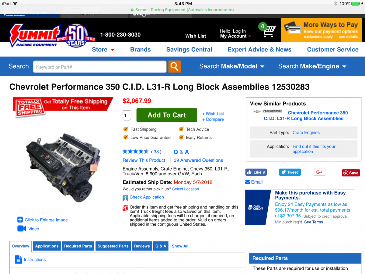

    Well let see ... Canadian to US dollar exchange is 1.3108 today. That would make my $4500 rebuild $3433 in US dollars. Does that make it sound a little less stupid??

    pls reread my post. I did not pay $4500 cdn to rebuild. I thought while it was exorbitant ... it was not necessarily "stupid". The cost of doing business where raw industrial land costs $1,000,000 per acre means **** ain't cheap. Didn't think it warranted telling the one automotive machine shop where I live that it/he was stupid. That's not how I roll.
    ...and as I posted, I did purchase an L31 long block from my GM dealer for $3200 cdn tax in. Once again doing the math the Summit L31 @ $2067 USD x 1.31% exchange + 12% Cdn taxes = $3032 Cdn. So I left $138.00 on the table I guess. Not really the end of the world and not really stupid imho
