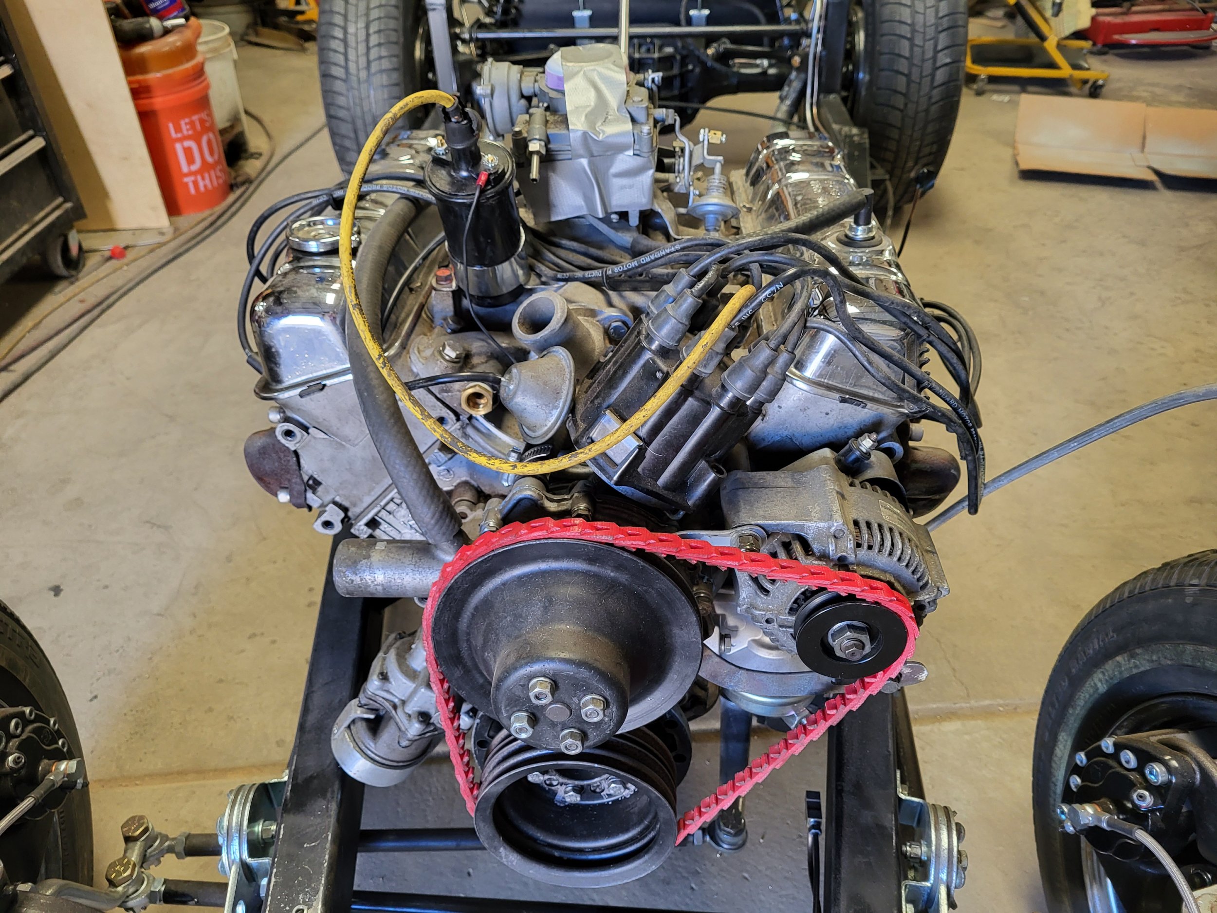

    This is a shot of one of my $300 piles of 215 basket cases. The red one is a cast iron 300 engine that I have not checked yet. Also there is a pair of the one year only aluminum heads for a 300 that I put on the 215 below.
    In a separate buy a later Rover with the twin SU's. So far I have found low compression in a couple of the cylinders, so it at least needs a valve job.
    This is one I put together from the pile. It had a 20 minute run in after I rehoned the cylinders. The next time will be when I can drive it to load the rings.
    The Ruby body is going back on today.
  8. Pav8427
    Joined: Jul 30, 2021
    Posts: 285
    Pav8427
    I see Power -Twist link belt, or similar brand.
    FYI That stuff is designed to run a certain direction.
    Yours is backwards. It should be run so that the crank pulley actually pulls the inside of link into the pulley so there is no belt slippage.
    Most brands have a directional arrow on them.
    rmcroadster and Sharpone like this.
  9. Sandcrab
    Joined: Jul 25, 2022
    Posts: 169
    Sandcrab
    Thanks for the heads up Pav8427. That is good to know. I have not run it in this configuration and just used it to get a belt length and alignment for the alternator.

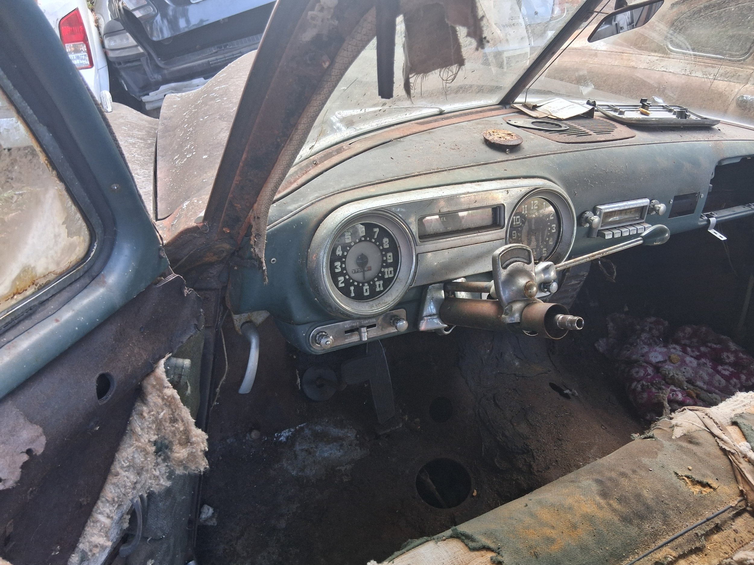

    I need that gear indicator on the column. Is the car being parted out?

    Funny, that was the first piece I noticed too. It would look good on a variety of cars.

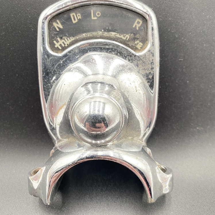

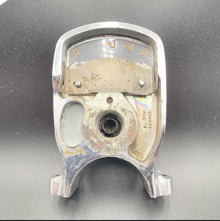

  14. Movinman
    Joined: Feb 20, 2005
    Posts: 1,135
    Movinman
    I actually have the indicator. What I need is the plate that covers the back of it.

    I use one on my Pontiac with a Hydramatic. It is pretty.
