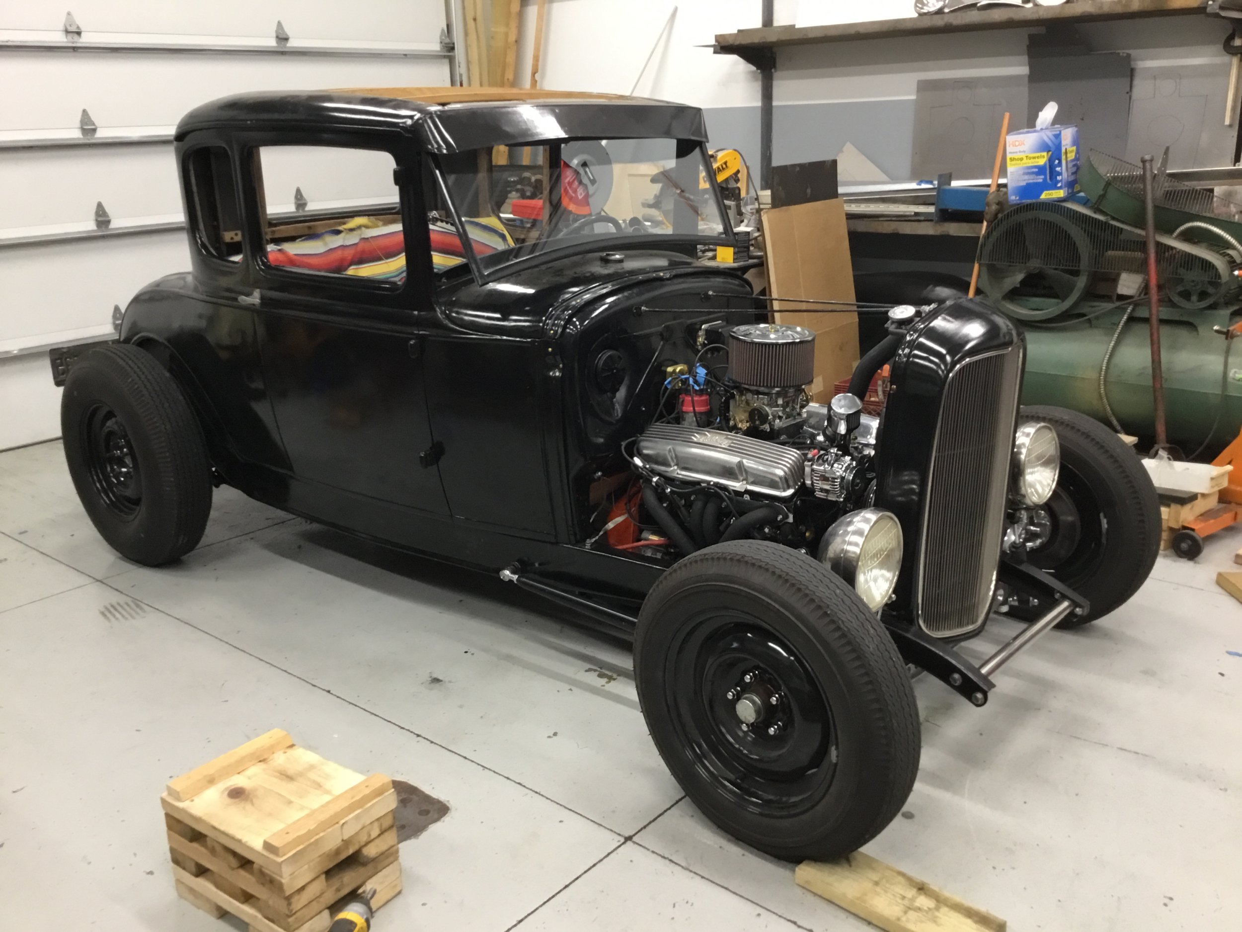

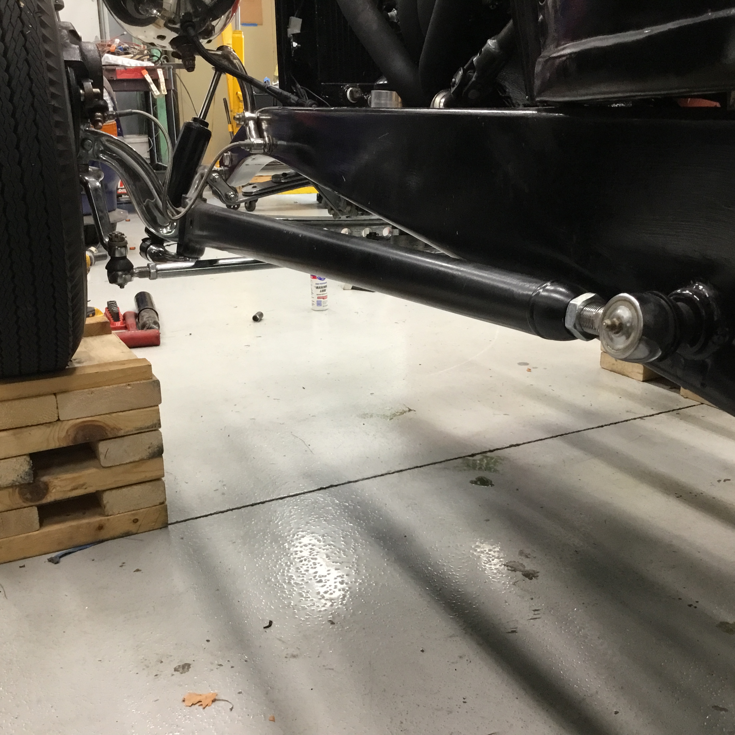

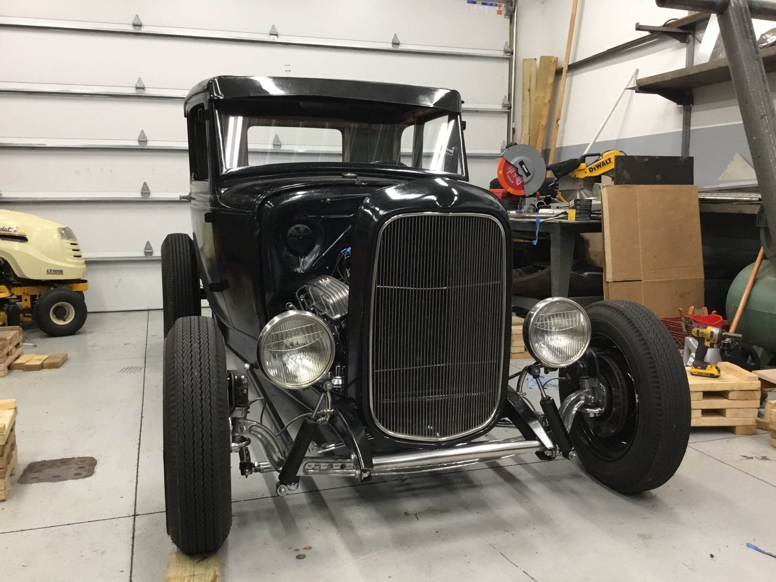

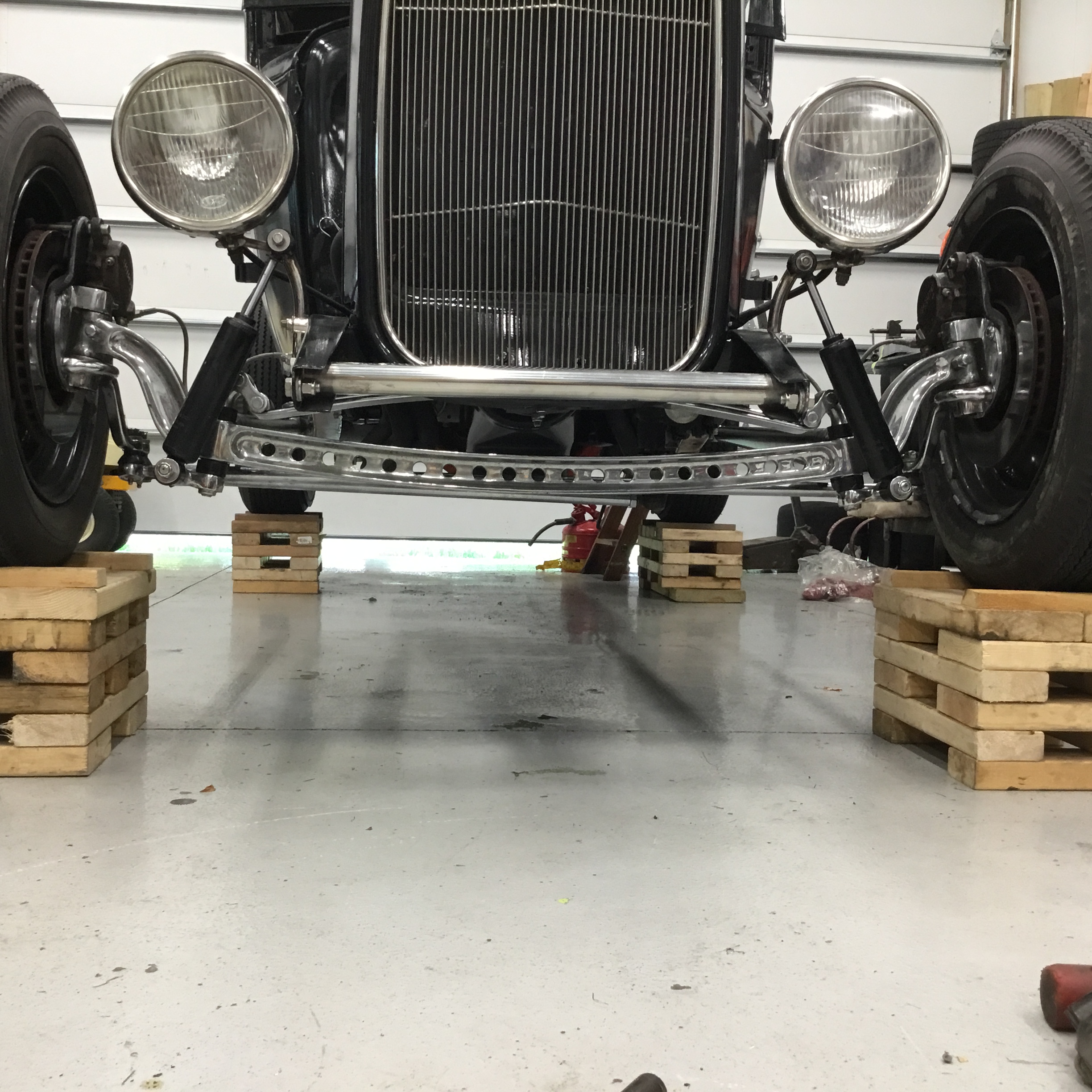

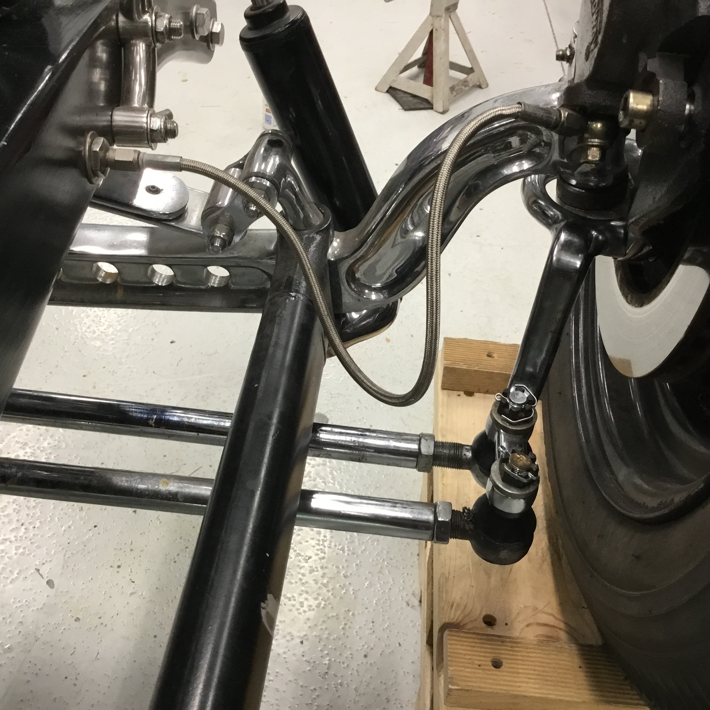

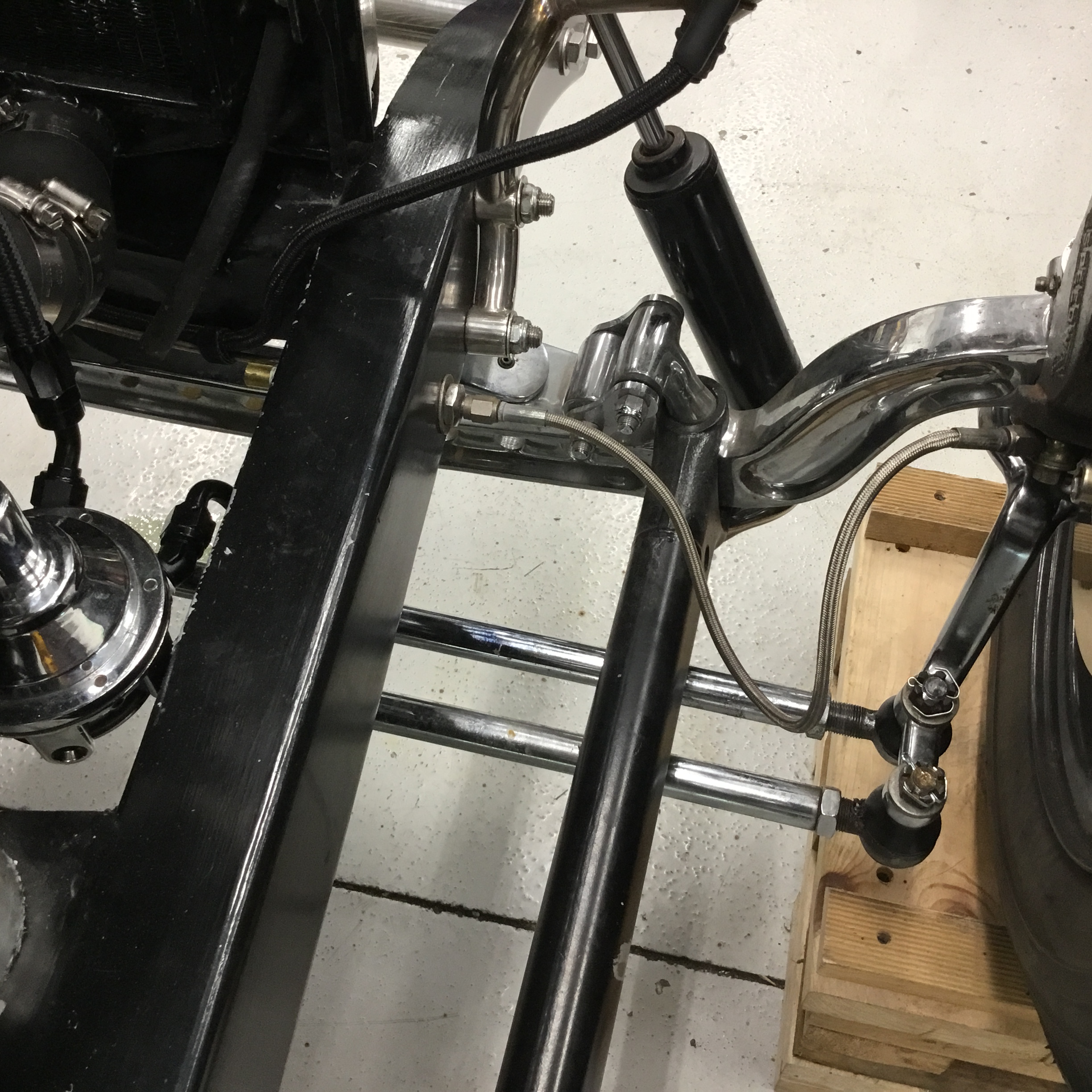

    Hey all, I’m having a struggle and figured I’d ask for a little help. I just put an engine in my car and got it on the road. Sounds good, runs good. However, at about 45mph, I get an awful side to side shake in the front. Nothing at 40 mph, but as soon as I hit 45, it starts going crazy. I can see the front tires bouncing up and down and the grille shell is going back and forth like laundry in a windstorm.
    The car is a model a ford coupe on an aftermarket 32 frame. Frame is boxed front to rear with tube crossmembers underneath. It runs split wishbones, gas shocks and no Panhard bar in the front. It has a new Borgeson Vega box and cross steer. About 3/16” of toe in, and 6 degrees of caster.
    The rear is a triangulated 4 link with coilovers. Driveshaft is new and the rear and the trans output are both at 0 degrees. The driveshaft is down hill at 2.5 degrees (engine/trans higher than the rearend).
    I expect that I need a Panhard bar on the front. It seems to be the consensus that it it necessary with cross steer. Could the lack of a Panhard bar cause the vibration? The car does not wander any more than any other straight axle car I’ve driven, nor does it bump steer or do anything odd while driving (except scare the **** out of me at 45mph). It does seems to calm down some if I drive through it to 50, but I only tried it once.
    Thanks for the help fellas!

    Wheel bearings come to mind after seeing the front brakes. Everything correct and still adjusted as it should be?
    gimpyshotrods likes this.

    Can't tell much from those pic's but looks like a ton of wheel weights on the left front. Get a panhard bar and try some other tires. Not related to vibration but I might want a little more back spacing on the wheels
    05snopro440 and winduptoy like this.

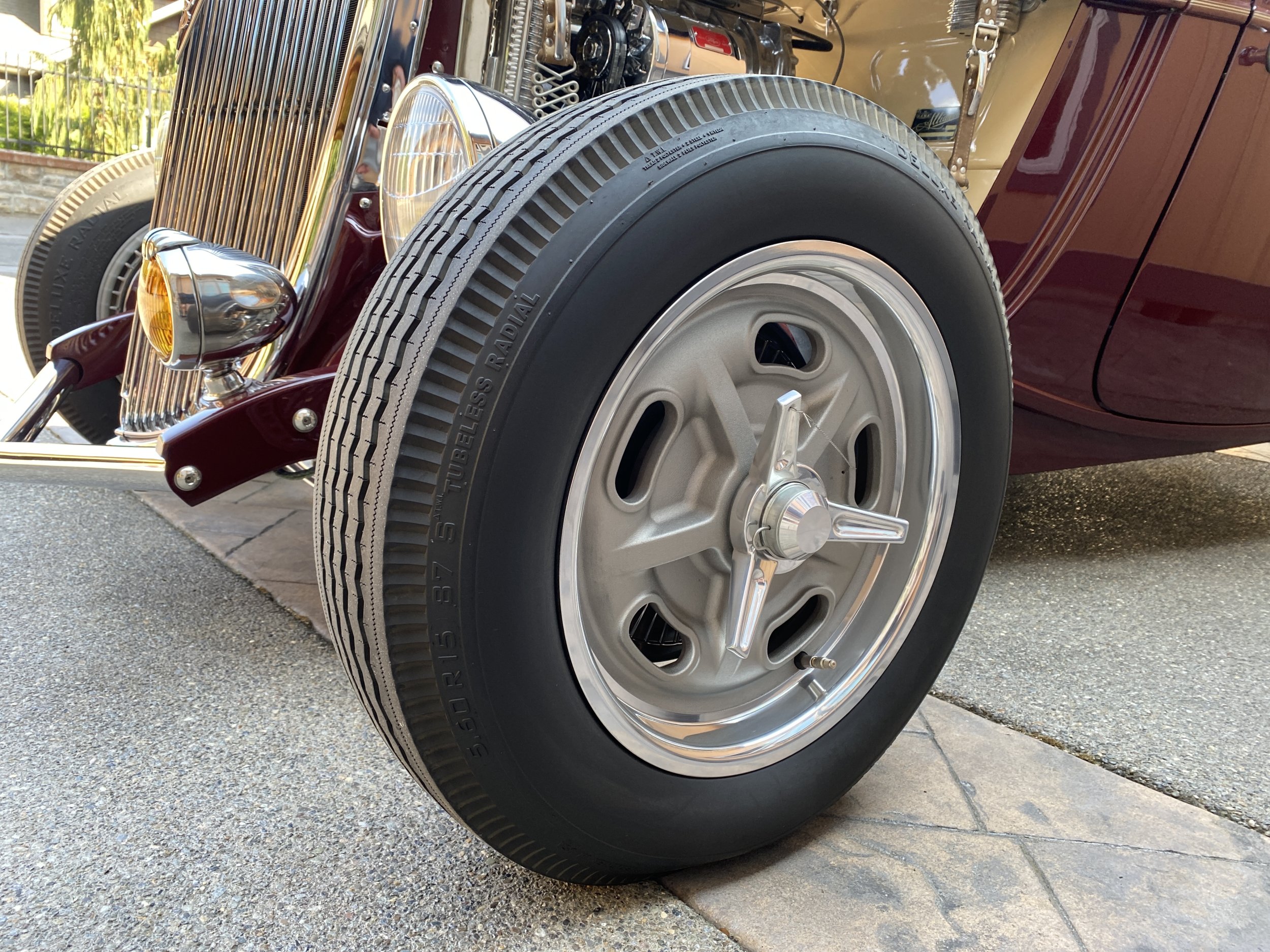

    I'd change the front tires and drive it again. I had Cokers on the front end of my roadster, bounced at 60 MPH like Dolly on a roller coaster. Put DB Auburns on it and it will hit 100 easy.

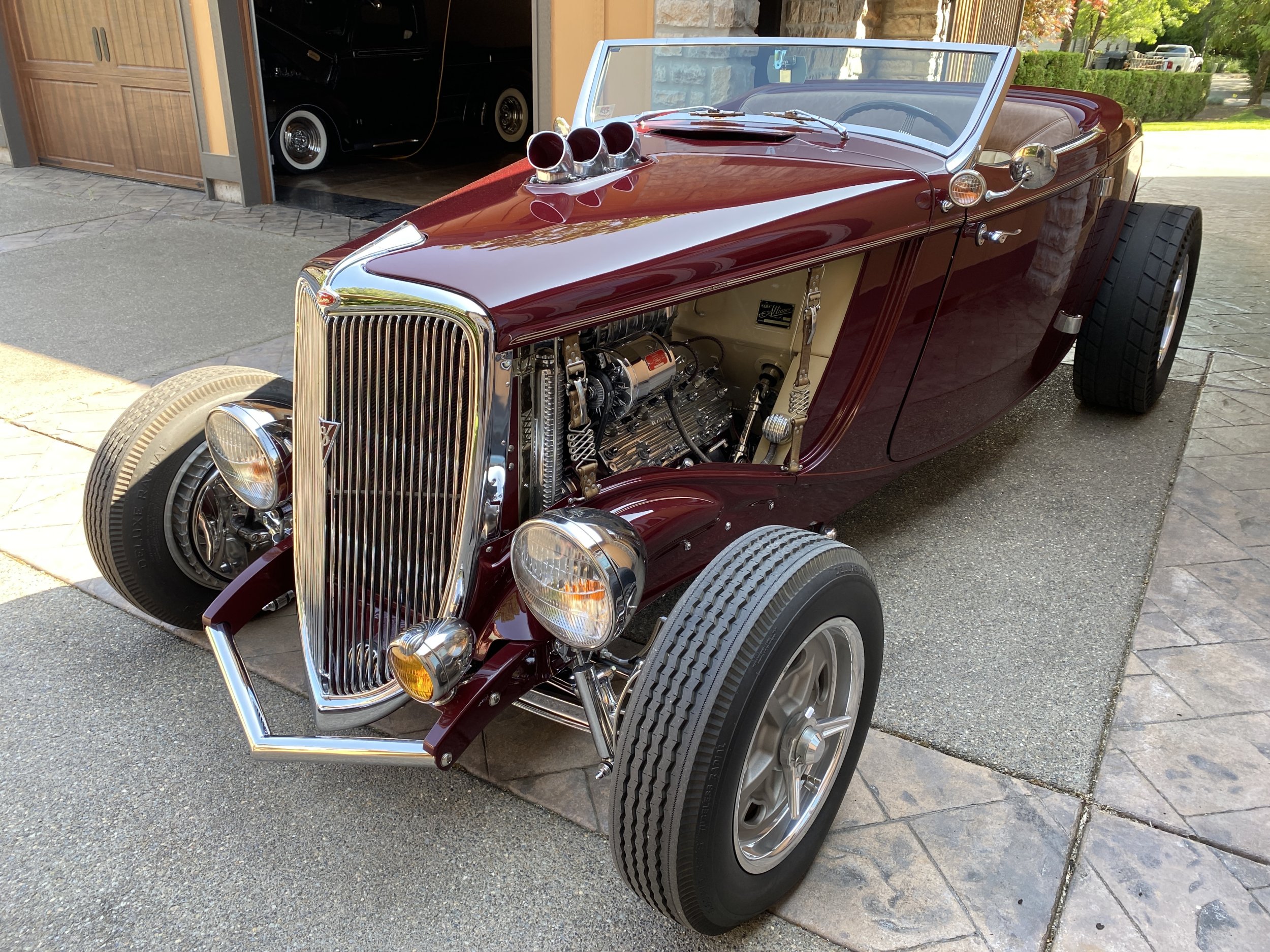

    Yep. They are round. I prefer that over Coker’s.
    F-ONE, flatheadpete, das858 and 5 others like this.

    what size bias ply firestones are you running? I have 6 cars running bias plies from Coker and I have never had a single problem with them. They are round and balance just fine and will run 70 mph plus with no problems
    warbird1 and winduptoy like this.

    Diamondbacks are "Round, Not Brown".
    Bandit Billy likes this.

    That is exactly what I had to replace with less than 100 miles on them. Garbage. Utter garbage. I kid you not I thought I was going to lose control the first time those Coker Cl***ics hit 60. Sheer terror.
    I bolted those Auburns on and like @Moriarity says "smooth as a gravy sandwich". I was so impressed I bought four more for the wife's PU, this time with wide whites (that actually stayed white).
    You could have a separation or something else going on but if the tires aren't round, no amount of weight will cure it at speed.
