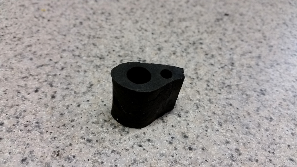

    Sugru was wrapped around the tubing, then pushed into the mount. Remaining Sugru pushed in to complete. Now we wait at least 24 hours - this can extend based on how thick the moldable piece. You can remove the tubing and do some t******* after a few hours though.
    How it looks after curing, tubing removed, before cleanup. I used a razor blade to cleanup the outsides after this pic was taken.
    The mount removed. Since Sugru is a 'glue' it holds firm in the mount but it needs to be removed. I used dental floss to cut/carve the silicone away from the aluminum. I also made some slits along the holes so that it can be fed around the tube for installation.
    The bushing in place, trimmed up and ready to go.

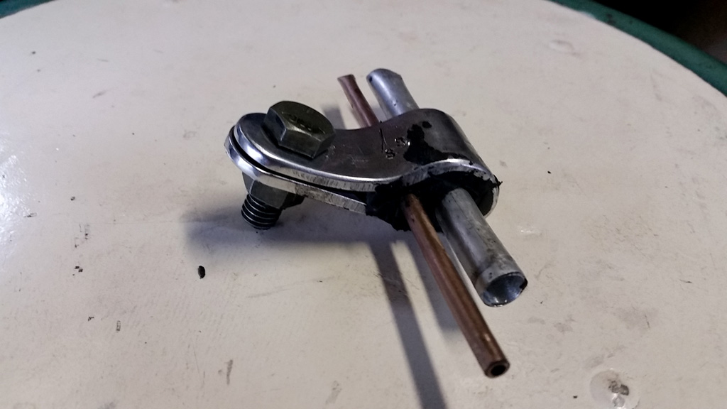

    And now with the aluminum bracket
    All finished, should work well for a long time to come.
    Here is what my PCV line looks like with Sugru mounts
